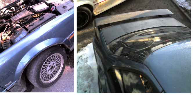

This was my first Beretta. I bought this several years ago from my ex-girlfriend after she had it for a number of years. I had replaced the serpentine belt, alternator, heater-core, clutch, transmission oil-seals, rebuilt the power-steering pump, and replaced one wheel and rear wheel bearing (I bent one of the rears against a curb after avoiding a truck that swerved into my lane), rebuilt the ignition-lock to better-than-factory, and put in new front brakes while she had this car. I also installed a Pioneer CD deck for her. When her health deteriorated enough that she didn’t want to drive a clutch anymore, I offered to buy the car, and she sold it to me for $750.
It is an original 3.1 V-6 5-speed blue-on-blue car, F40 ‘Heavy Duty’ suspension. It now has roughly 157k miles on it.
I had installed a Firebird wing-spoiler, 15” Beretta GT Cross-lace rims, and grafted in a Turbo 280Z hood-scoop to feed the intercooler after I located it to where the battery originally sat, and moved the battery to behind the engine on a modified HAVC (blower) plenum. ICM was relocated to the recess behind the right strut-tower with a new ground-wire to get it away from the heat of the exhaust manifold, and I installed Accel 8mm cut-to-fit ignition wires, mostly because they were cheap and in-stock at the parts store and because I had had good experiences with them on my old Camaro. I had also put blue LED lighting into the instruments, driving-lights behind the grill, and eventually removed the diffuser lenses from the headlights replacing them with clear plexi-glass, which made for some obnoxious spot-lights up front (these headlights are currently on the ’95 Z-26 I had, as it is ~ 1” shallower and allowed for grills to be placed in front of the headlights, which fit the look I was going for with that car). I also installed an in-flight adjustable boost-controller, and ran the car anywhere from 4-5 psi (normal setting –enough to b!tc#-slap your average 4.6 GT Mustang) to 9psi (high setting –better for highway grudge-matches) and even a run at 12psi (unintentional, but the engine handled it okay). I adapted a spare heater-core to help provide cooler coolant to the turbo too, which was eventually a source of dispute from a previous bstuff member who thought I was trying to pass that off as an intercooler. :roll:

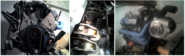

The Engine:
I ran across a wrecked ’99 Grand Am GT with low miles in the salvage-yard, but the 3400 was already gone from it. About a week later, the engine was returned, allegedly due to a blown head-gasket. I bought the engine, complete from intake to oil-pan, with all accessories, wiring harness, and PCM for $65, on the condition that it held no warranty, and the yard wouldn’t have to see it again. No problem! As it turned out, it only had the typical 3x00 LIMG failure, the head-gaskets were fine. But I didn’t want the heads that were on it, as I wanted to retain the LG5 “3.1 Intercooled Turbo” manifold that was already in my car, and more era-correct MPFI-style intake setup, even if that ultimately cost me a little bit of power. I started with a good set of MPFI heads, modified them to accept the 3400’s roller-based rockers, matched in correct-length push-rods, rebuilt all 12 roller-lifters, and ported-out the heads, fabricating locator-pins for the modified LIMG to keep it from walking when the lower intake manifold was set in place. I modified the cast aluminum oil-pan for an oil-return from the turbo, and I set up an oil-supply line from the oil gallery on the front of the block. I painted the exhaust-system and turbo’s hot-side with high-temp black paint, built a 2.25” short-run catless side-outlet exhaust system for the car, and put in a new clutch (this installation coincided with the failure of the first clutch I had put in the car before I owned it, and my ex had conveniently thrown out all of the warranty info –thanks- leaving me with the additional cost of a new clutch). I welded up a temporary front engine-mount out of 1/8” steel (which was already distorting slightly by the end of the week, but held the engine in place for testing, as intended), and put about fifteen miles on the engine during testing. Unfortunately, the engine developed only very low oil-pressure, and replacing the oil-pump didn’t help. So, out of time and patience for the project, I pulled the 3.4 and dropped the LG5 3.1 back in.
A couple of years ago, I finally got around to the 3.4 again, and found that the rear main crankshaft bearing was chewed and the crank was toast, certainly due to the LIMG failure it suffered before the donor car was wrecked and scrapped. Things like this make me wonder about the timing of certain wrecks, and the pay-out amount of full-coverage insurance that doesn’t pay to fix engines with defective engineering…

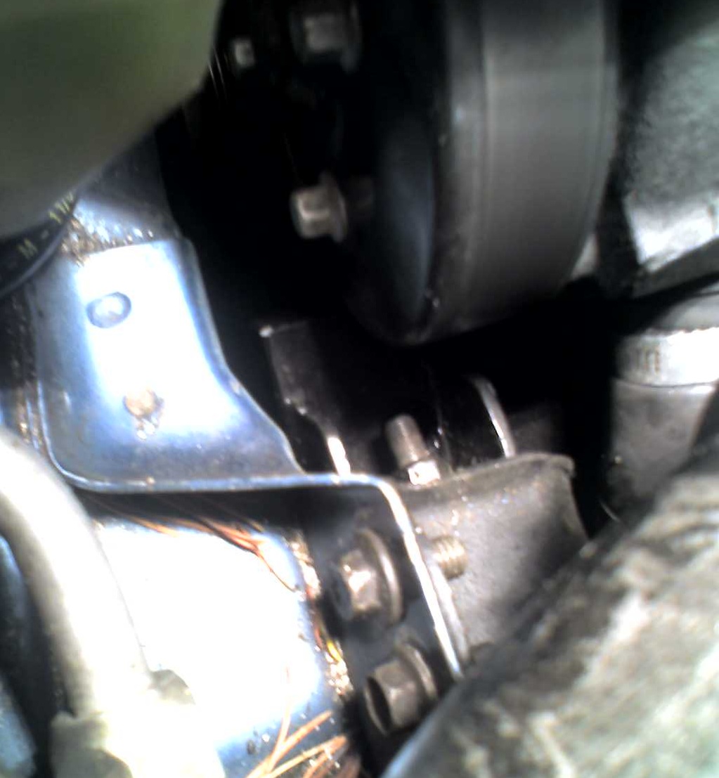

I needed a decent front engine mount for the 3x00 block since I was working with an older Beretta, and my old temporary one couldn’t properly support this engine with the old turbo, exhaust, and 3.1 ECU during very gentle test-driving. It wouldn’t hold up for long under the updates I made, so I didn’t bother with it, except to use it as a template for a heavier-duty unit. I used ¼” thick 3”x3” steel angle stock for this one, and it looked and worked perfect.

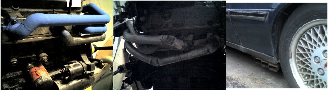

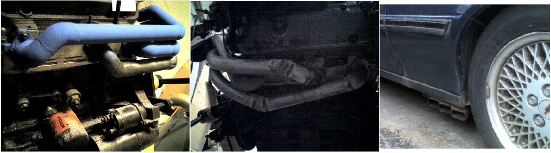

I decided to go all out on it, built a full set of 1.5” primary-tube block-hugging headers (I couldn’t find ANYONE who built and sold headers for a 60-degree V-6 turbo application) that I port-matched to the heads, installed a brand-new T-4 turbo, bolted in an adjustable Audi K-03 external waste-gate, and rebuilt the exhaust as 2.5”, all mandrel-bent tubing with a high-quality flex coupling and single Thrush ‘Welded’ muffler to replace my aging glass-packs. The resulting sound is perfect, lots of aggressive growl with a faint metallic ring, but no rasp and no bark –just bite! It isn’t a quiet car, but it isn’t really loud either.

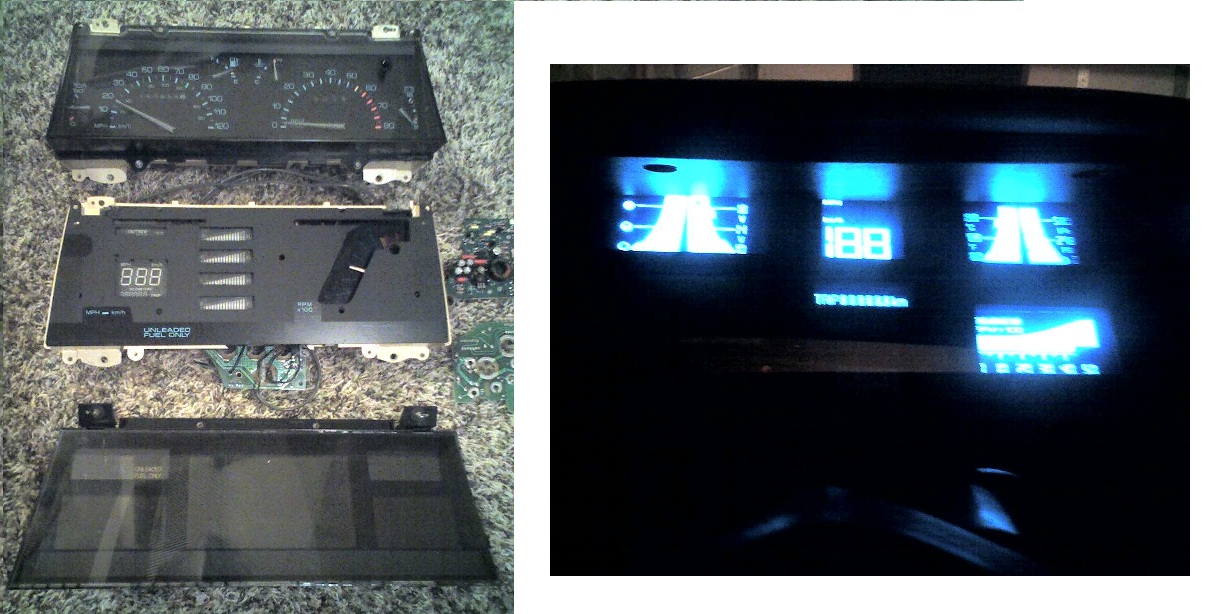

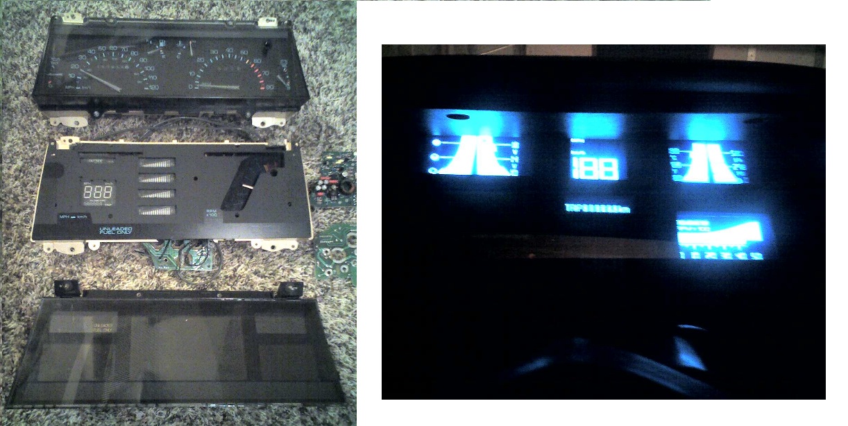

Top to Bottom: My ‘Retta’s original analog Cluster, Modified Z-24 Cluster, Factory Beretta Digital Cluster.
Early ‘90s S-15 Instruments currently in the car. The Z-24 Cluster would work much better and is ready now as a Drop-in, but it is fried, so until I find another donor…

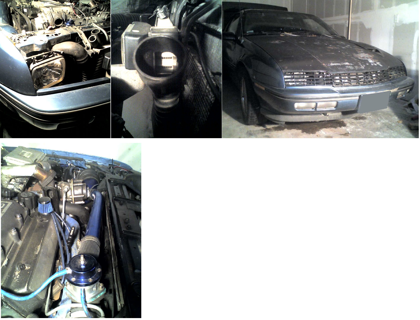

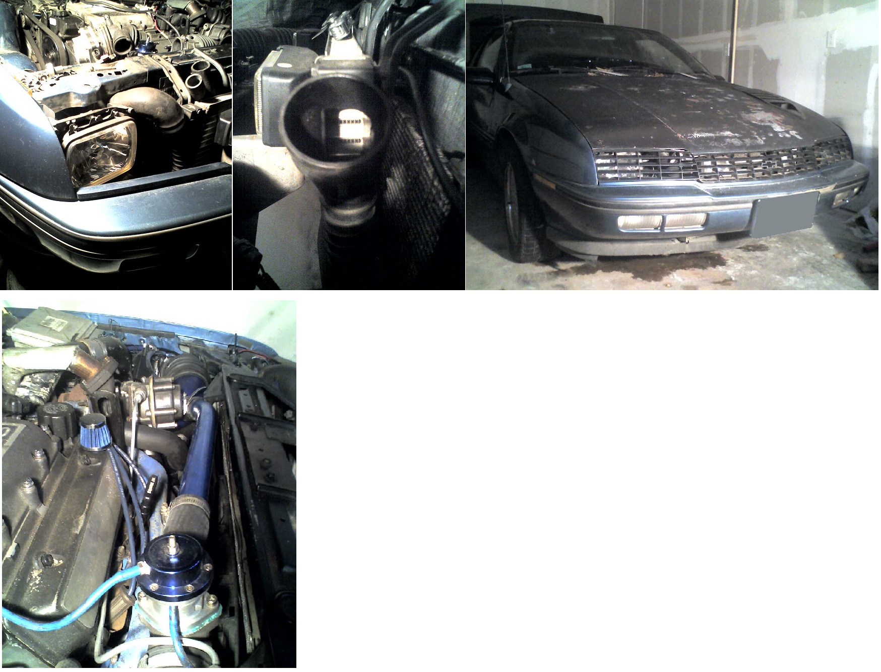

The Intake (and Head Lights):
And Head Lights? I had a Blackstone intercooler sitting around and looking bored, so I decided to set it up in front of the car for giggles. I never did laugh though, and neither did the Blackstone. The Berettas have D-shaped cutouts on each side of the radiator core, which are almost perfect for 2” piping to fit through. Some of the tighter elbows I used on the intake piping were factory rubber or silicon, some were cast aluminum, and most of the intake piping and bypass valve return-air line was extruded aluminum. Almost all of it was ‘lying around’ from other projects I’d done in the past, or left-overs from parts I had salvaged. I had to buy one stainless-steel coupler for the intake, I picked it up new for ~$3. I used Saab turbo hose-clamps almost exclusively (I had a bucket of them to pick correct sizes from), so most of the intake can be disassembled with one size tool, instead of switching between ¼” and 5/16” all the time. I hate that. I mocked-up several routing options, and found that with the piping and elbows I had available, I could build a complete FMIC set up for this car, but the elbows would interfere with the headlights. So I made new headlights. I used a set of dual-filament square headlamps, fancier ones with the ‘city-light’ 194 bulbs off to the side, and the headlight buckets from a Fiero (I got a lot of Fiero parts in a trade I made). I also built a set of grills across them, like I did on my ’95 Z-26, but kept the egg-crate grill in the middle instead of fitting in a Z-34 Lumina grill, like I did on the Z-26). It still needs some work to look right, but it is okay for now, and I think the car looks very aggressive this way. But back to the intake… I also fit in an ebay-special bypass valve –I couldn’t use a BOV (Blow-Off Valve) because of the GA GT’s MAF (Mass Airflow Sensor), as it messes with the computer’s calculations to suddenly dump out a bunch of air the computer has already measured and calculated fuel for. I bought a blue cone-filter for the intake, and it sits over the battery-tray, in the same area fed by the hood-scoop, so if I box it in correctly, I should get some ram-air pressure in there, too.
Despite the low-res picture quality, it can be seen why the Blackstone is such a good choice. The air-tubes are extruded aluminum with internal vanes formed into them. This yields a huge internal surface area, compared to plain hollow tubes units, and also makes the structure of the IC much stronger and more rigid.
Fiero Head Lights on a Beretta? And upside-down and swapped left-to-right, too. At least they don’t flip-up anymore… Or is that too bad they don’t?
This hood used to look really good a few years ago, but is desperate now for a bit of body-work and fresh paint.
That huge on-its’-side-distributor looking thing is the external waste-gate for the turbo. $60 would buy an ebay-quality unit in color-matching blue, this one was free with an Audi K-03 turbo I bought for ~$35, and will probably last forever, is fully adjustable and is rebuildable.

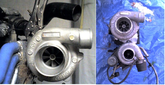

The Turbo:
As previously mentioned, it is a brand new Garrett Airresearch T-4, .60 A/R compressor (a little big, even for a semi-built 3.4) externally waste-gated and oil-cooled unit. It was a gift from a family member, who decided they wouldn’t use it and didn’t need it anymore. The externally waste-gated aspect was a serious pain to deal with considering that every part of the exhaust system was being fabricated bend by bend, and I almost hybrided the turbo with a T-3 I had, but external waste-gates supposedly offer better turbine-speed and boost-pressure control than internal waste-gates, so I left it alone.
The Plumbing:
To help the oil-cooled-only turbo live a little longer, I installed an oil-cooler between the A/C condenser and the intercooler, and I put a pre-screener inline before that, just to keep any debris out of the turbo and help prevent buildup from getting into the oil-cooler. I fabricated aluminum tubing with stainless-steel fittings where I could for vacuum, boost-pressure, and oil-supply, and used blue silicon tubing where the aluminum wasn’t convenient.
Details, Details…:

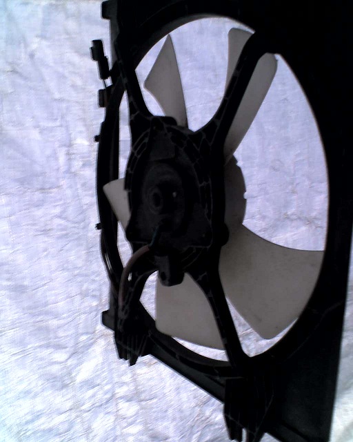

The original Beretta cooling-fan wasn’t going to fit in here anymore, not with upper-deck air-intake pipes routing around, so I used another fan from an import (I honestly have no idea what it came from, I’ve had it and the radiator it was bolted to sitting in one place or another for several years now), and it slid almost perfectly in place. I fabricated new, heavier-duty mounting brackets for my behind-the-grill lights (since the headlights’ header-panel no longer fit in the car, due to the huge FMIC), and put new lights on them, too. The old lights and header-panel will likely go into the GTU someday.
…I’ve had issues with this build, like the speedometer incompatibility, and oil-leaks from the turbo’s supply lines that just won’t dry-up (I probably won’t use aluminum tubing with compression-fittings again, I’ll stick with copper or go to flare-fittings). Additionally, the anti-theft component of the GA GT’s PCM has been a constant irritation, and the control module has now started to become unreliable. I have a new module to drop in, maybe this weekend, but I am thinking of going with a different PCM altogether if I can find one that doesn’t have the anti-theft system built in. Unfortunately, this car has done a lot more sitting lately than running, and that is a shame because it was a blast of a car to drive before, and has so much more potential now.

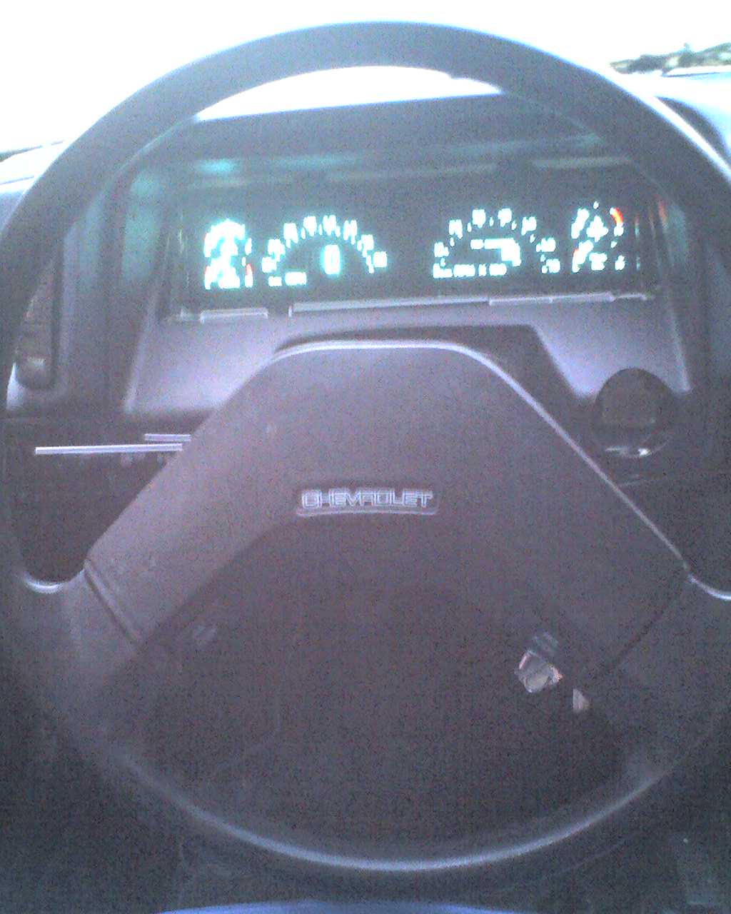

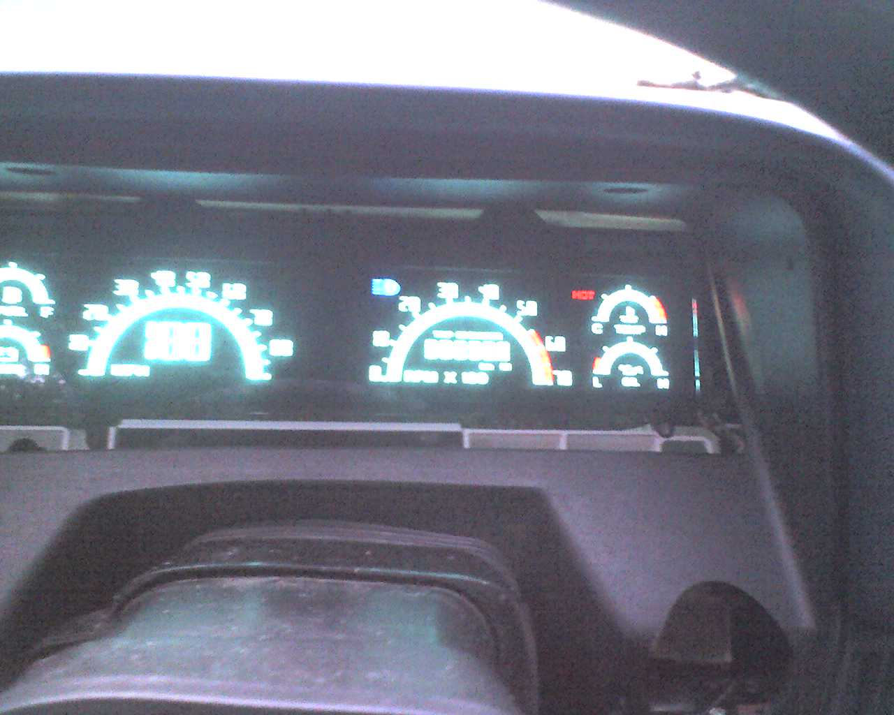

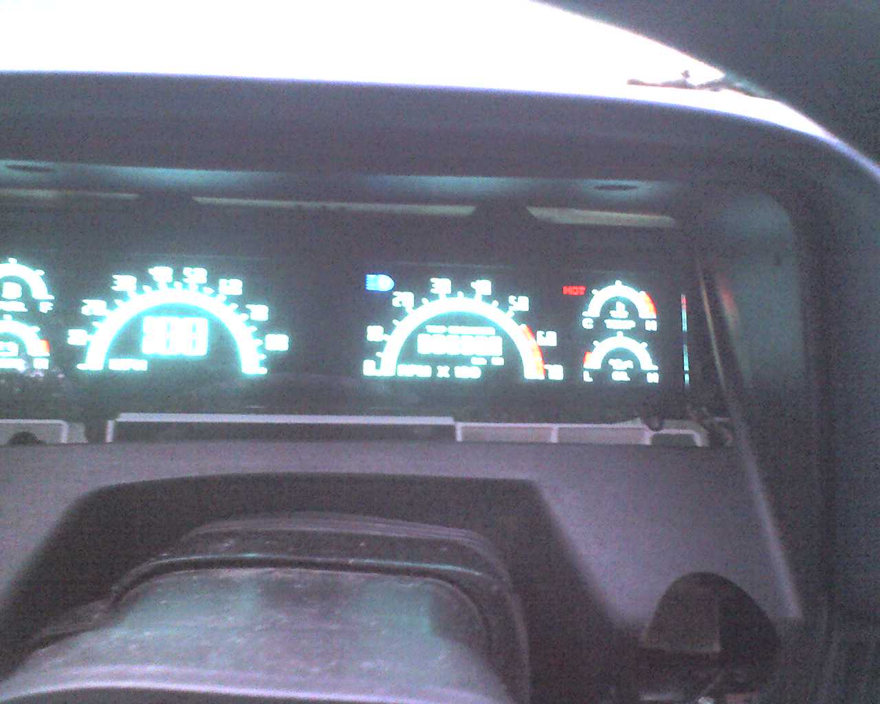

Update on this car. It has been almost a year, with very little progress on it unfortunately. I finally have the digital Cutlass Supreme instruments in and wired-up (mostly). I still need to solder-in the battery-constant + for the tripometer, and find a place to mount the Cutlass ECM to drive the speedometer and the Dakota Digital calibration-unit because of my royal =@ using the Cavvy transaxle. I also need to fab-up some kind of 7x RPM signal-generator for the tach, but that isn't super critical, especially since I still have the PCM running the engine thinking it is in neutral (which means a low RPM rev-limiter of ~4k).
Powering up...
Powering up...
The boost gauge needs to be put back into the instrument bezel too.
I still need to make a lens for the instruments, finish setting up the rest of the indicator lights, and complete a few other small details.
