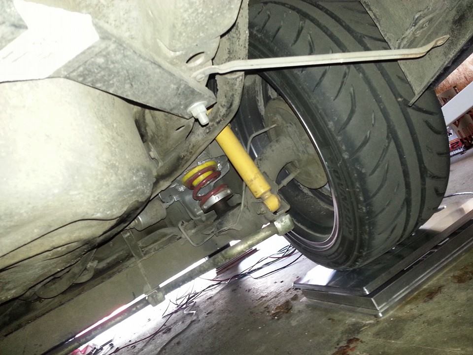

corner balance and alignment
there ya have it. the weight is with me and 3/4 of a tank of gas. Its close enough considering I usually race with more gas (it will cut out from no fuel) and have a passenger half the time.
its pretty much with in ~50lbs of being perfect. 60/40
intercomp scales and smart strings alignment setup
-1.5* camber up front
rear was -1* If I remember right, and you cant adjust it so I didnt check it this time
toe is 0
caster was +5 last I had it checked with the subframe pushed forward as far as it goes
toe is 0

do you mean like this?
no front swaybar
600lbs springs all around with adjustable perches
1" addco rear
camber plates
koni yellows
I only took took it as close as I did because with more gas, and a passenger it changes everything. kinda picked an in the middle balance

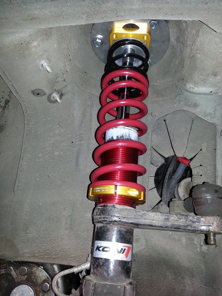

no front swaybar
1" addco rear
camber plates
koni yellows
