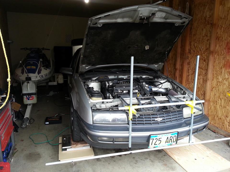

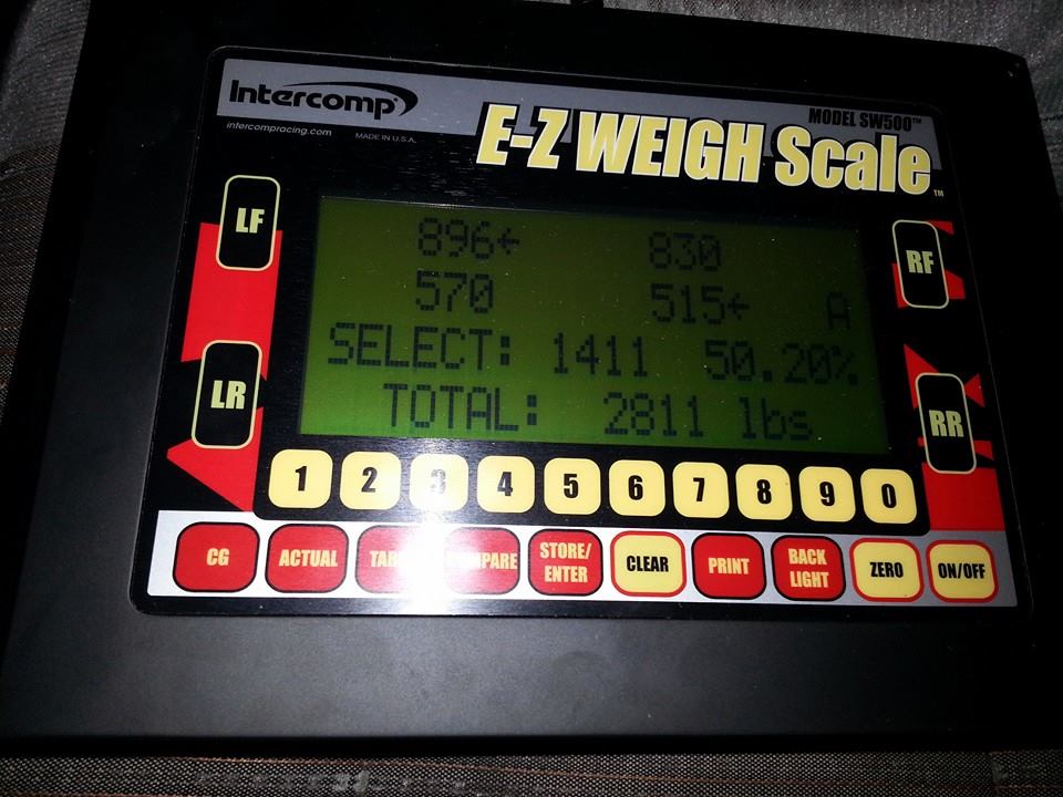

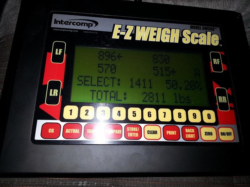

there ya have it. the weight is with me and 3/4 of a tank of gas. Its close enough considering I usually race with more gas (it will cut out from no fuel) and have a passenger half the time.
its pretty much with in ~50lbs of being perfect. 60/40

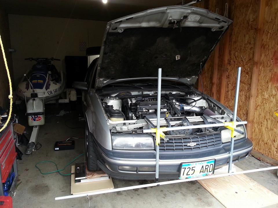

intercomp scales and smart strings alignment setup
-1.5* camber up front
rear was -1* If I remember right, and you cant adjust it so I didnt check it this time
toe is 0
caster was +5 last I had it checked with the subframe pushed forward as far as it goes
toe is 0

2811 Jesus... my car is FAT! 3145 last time I weighed it... 205 of that being me. Then again I have a full interior, Auto, A/C and my stereo... Minus the subs of course.
- Posts: 4706
Re: corner balance and alignment
Mine figured about 2700 without me in it...so you're a little lighter than that unless you're super skinny. haha
haha. I have about 100lbs of sub and box in the trunk.. power everything but no ac. but I also have a trailer reciever on the back. Im about 150lbs. DOT scales told me my car was 3000lbs

The scales I used were at the dragstrip, NO idea how accurate they are. I have access to one of these Longacre setups though so I could do this on mine and see more accurate numbers.

nice, our cars are pretty close to the same weight then. I was thinking mine was a freak light model. I have no ac related components
do you mean like this?![Smile :-)](./images/smilies/smile.gif)
no front swaybar

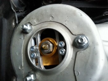

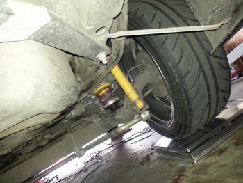

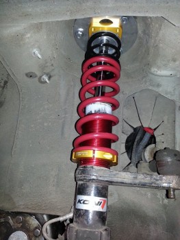

600lbs springs all around with adjustable perches
1" addco rear
camber plates
koni yellows
I only took took it as close as I did because with more gas, and a passenger it changes everything. kinda picked an in the middle balance
no front swaybar
1" addco rear
camber plates
koni yellows
