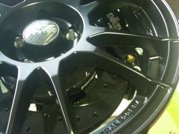

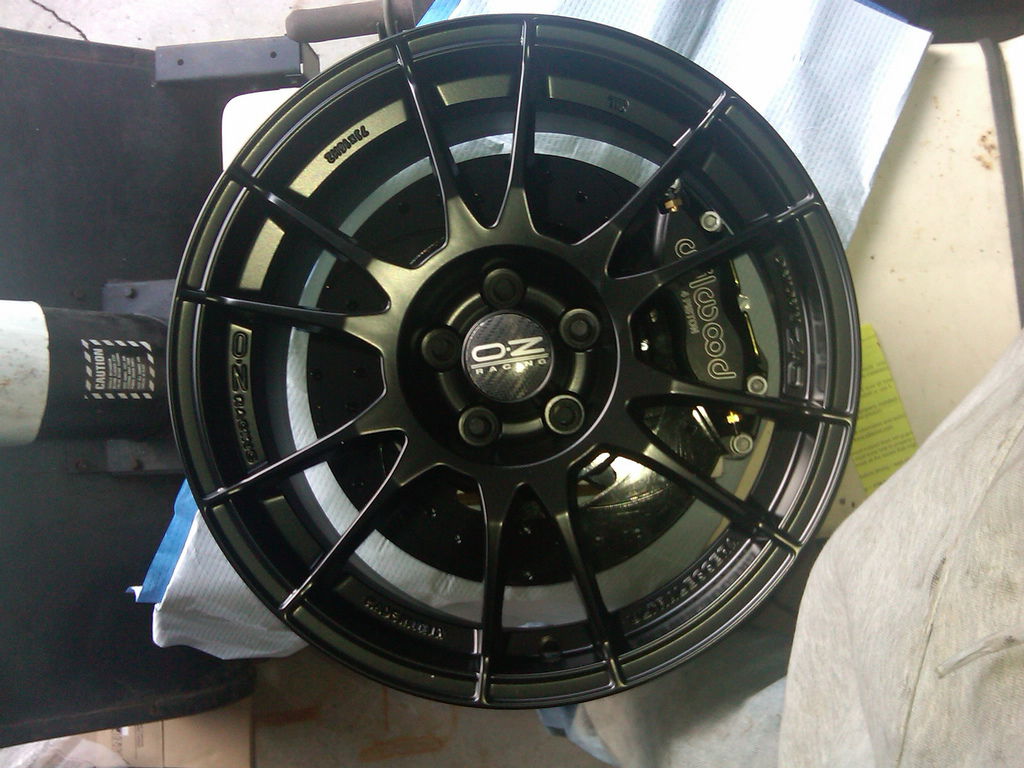

I know it's been a really long time but I figured I'd update a bit. After some test fitting, there is no way this kit will fit under the stock GTU or GTZ rims without some serious spacers. I decided that since I'm going all out on this car I'd just get the rims I really want and picked up a set of 16x7 OZ Ultraleggeras with a 35mm offset. These clear the 4 piston caliper by roughly 1mm! I really like the way they look.
Here's a couple pics:

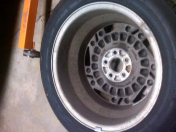

Modified, the GTU/INDY rims have what I'll call an internal lip, for lack of a better term, that actually make the 16" rim more like a 14" rim on the inside. I'll try to pop off a wheel tonight and snap a pic. I cant speak for the GTZ rim as I dont have one laying around anymore.

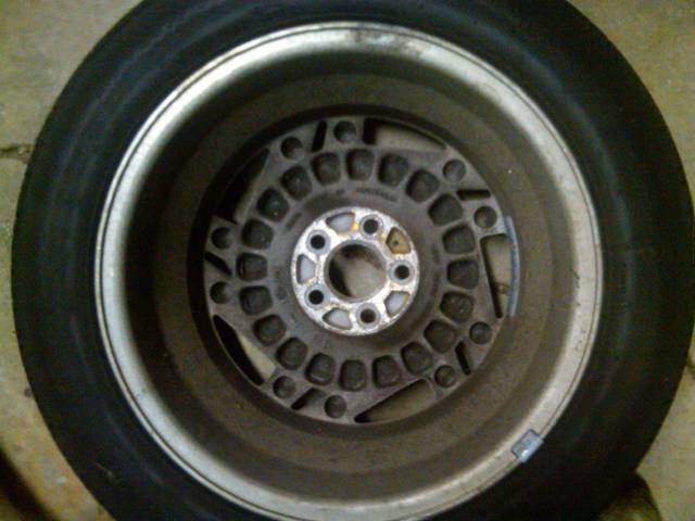

Here's the pics of the inside of the GTU rims. It shows the inside lip I was speaking of. The "lip" actually comes back into the rim roughly an inch and a half and shrinks the inside diameter to almost 13"!!! That's the reason the kit wont work on these rims. I'd like to have a look at another GTZ wheel at some point to see if it is better suited for the kit.
