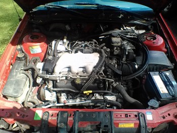

Dang that's nice lemme see if I can upload mine hang on

OK so my tps is located here?

Wept narrowed it down.. Not the cruise.. Back to start ur saying 3x it has to be either the tps or iac.

Idle issue could also be related to the O2 being bad... Until you get the mixture sorted out I wouldn't go after anything else, it could just be a result of it running that way.
