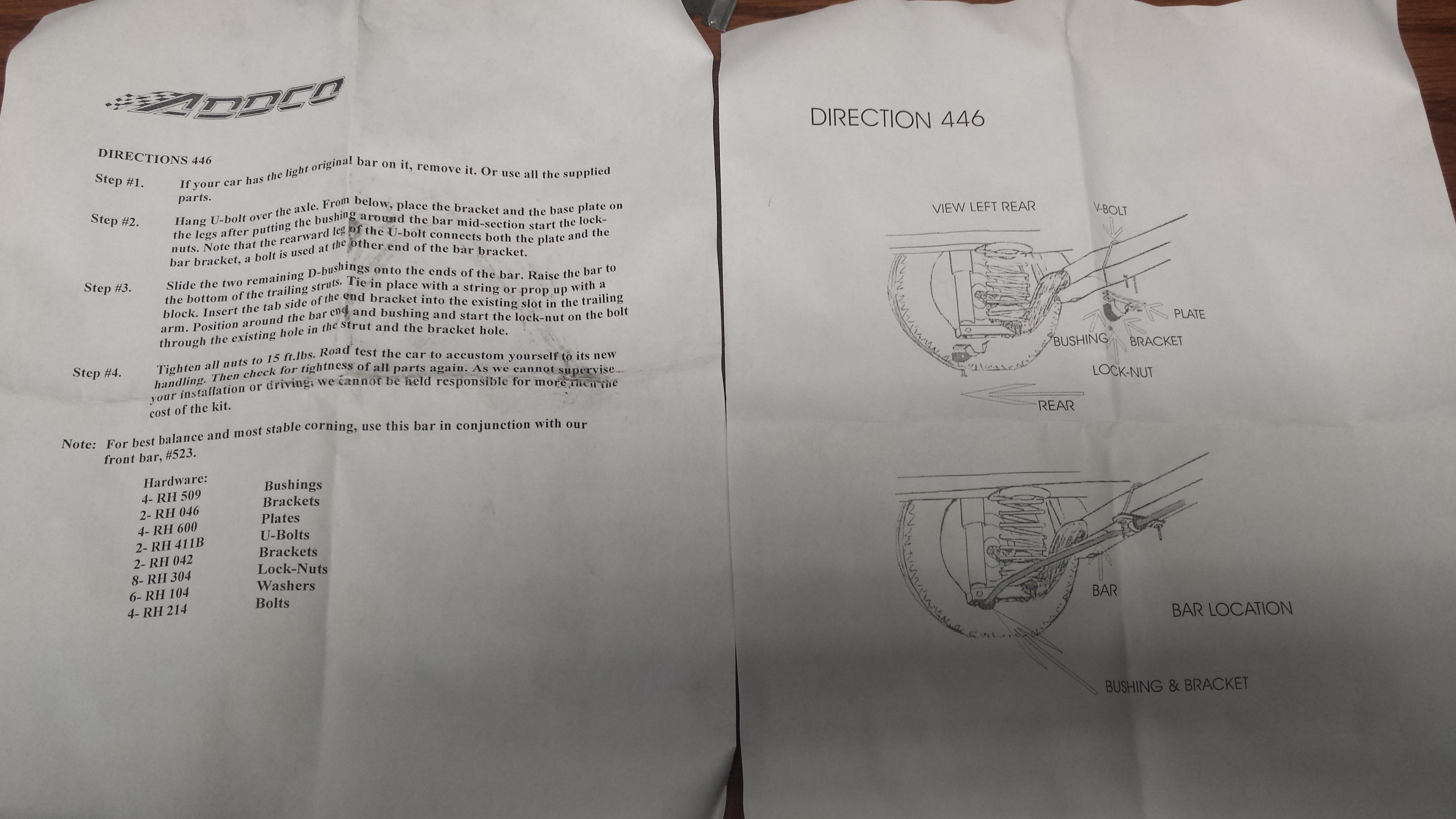

[img]
[/img]
Why does it seem that the bracket that goes over the axle does not line up with that u bar hook...and why does the suspension bracket not have a drilled hole on both sides?

I guess I need more center brackets. Yet why do they not line up?

Ok. I get it. But I still need another set of center brackets huh? This is a fine how do you do.

Come on guys... With the combination of this post showing the thickness of spacers I used and the STEP BY STEP INSTRUCTIONS included with the bar you should be able to figure this out. THEY HAVE FRIGGEN PICTURES!

I just forgot to get another pair of the center brackets. I got it figured out now. lol
