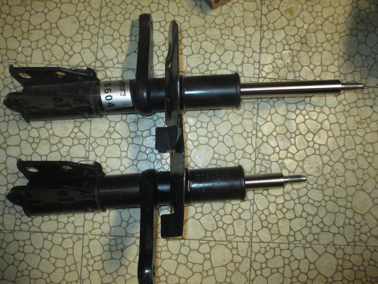

Decided to open up my closeout deal Sachs struts and check em out. Glad I did, looks like I won't be doing them this weekend.
I ordered a left for an FE7 and a right for a base, thats all they had. From reading here I decided the only difference would be the sway bar bracket, there's no way the aftermarket goes to the trouble of matching the valving.
Anyway, looks like the left side lost it's gas, there was a clip on it to hold it down, but when I took it off it just stayed there.
Back to RA for both of them. They don't have any more of the GTZ one in stock so I'll have to go with another brand.

Did moving the strut shaft have any impact on its rebound?
Re: New strut - b.o.o.b.
It didn't, I ran it through it's travel a few times and it just kinda stopped about half way.heavywoody wrote:Did moving the strut shaft have any impact on its rebound?
It also had much less resistance than the one without the FE7 bracket.

I'm starting to second guess myself: A good strut should extend slowly on it's own due to the gas pressure, correct?
I haven't owned a car with struts since I had my Malachite green Beretta which I sold in 2000.
- Posts: 10916
GR-2 struts are Gas charged so yes they should slowly extend to full length.

I have bought some konis in the past that didnt extend, but to adjust them you had to compress all the way and turn the shaft. I was fairly worried, but going on 3 or so years with them and zero issues. Different application, but thought id share. Kybs did always seemed to have some good pressure behind them.

Interesting. I compressed and extended them several times, but never thought to turn the shaft.
I have 2 KYB's and a sachs in my basement that I deemed as defective, so easy enough to try.
The delco's I received, one of them was bad as well. I'm still waiting on a replacement, supposed to be here tomorrow.

I figured I should bring this to a close, hopefully not too soon.
After ordering:
2 Sachs (1 defect)
3 kyb's (2 defects)
3 delcos (2 defects)
3 Monroe's (1 defect)
I have a set of plain ol Monroe's that seem consistent with my highly scientific "see how hard they are to compress and then make sure they extend" test.
I will say that the one delco I had that was good, it had a notably stiffer compression than the other brands. P/N's are 503356 & 503357.
The Sachs, kyb's, Monroe's all feel about the same.
I really wanted the delcos, but I kept getting a mismatched set. I deciphered a date code of '16 on the good one. The 2 bad ones I got were '08 I think and gloss black instead of matte. The top cap where the strut shaft comes out was different too.
