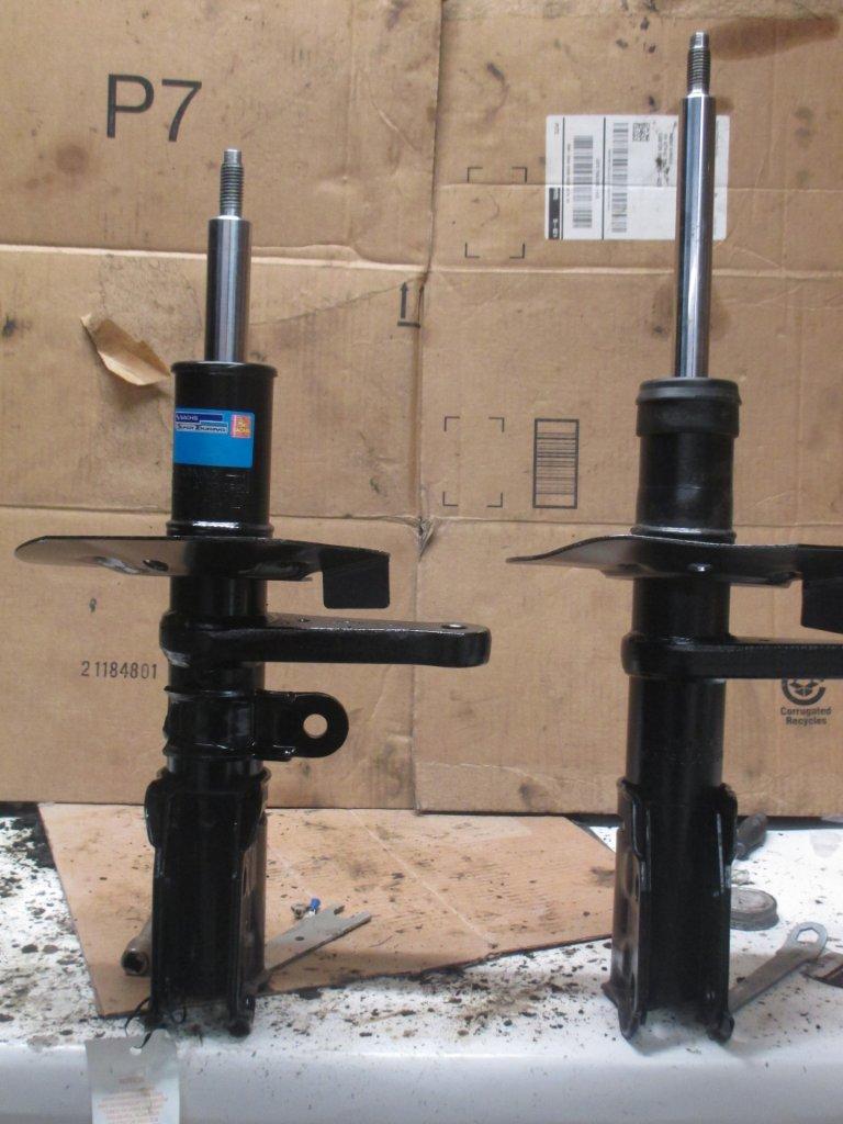

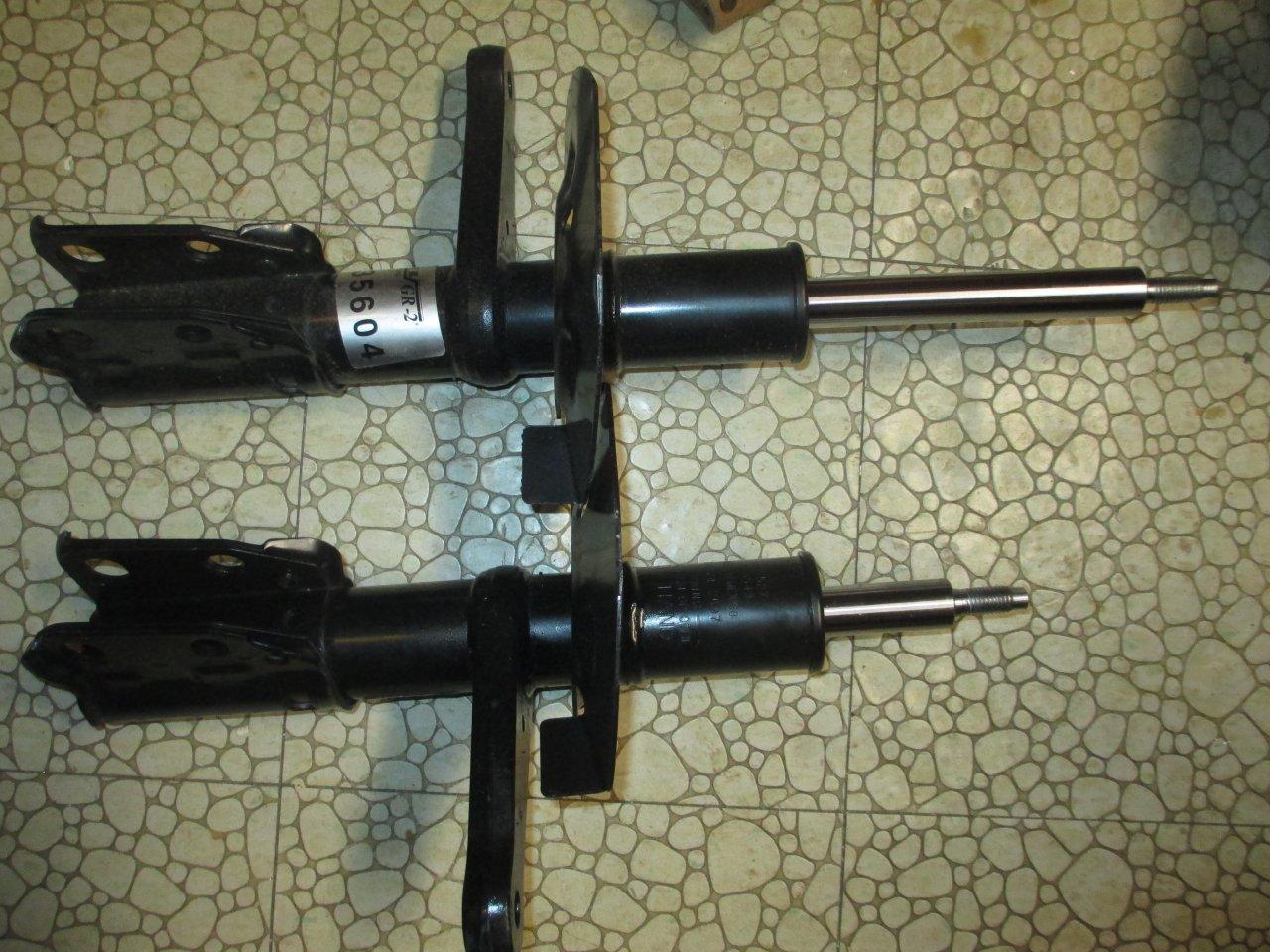

Decided to open up my closeout deal Sachs struts and check em out. Glad I did, looks like I won't be doing them this weekend.
I ordered a left for an FE7 and a right for a base, thats all they had. From reading here I decided the only difference would be the sway bar bracket, there's no way the aftermarket goes to the trouble of matching the valving.
Anyway, looks like the left side lost it's gas, there was a clip on it to hold it down, but when I took it off it just stayed there.
Back to RA for both of them. They don't have any more of the GTZ one in stock so I'll have to go with another brand.
They have kyb's on closeout, I know the quality isn't there but not much to choose from.

Did moving the strut shaft have any impact on its rebound?
Re: New strut - b.o.o.b.
It didn't, I ran it through it's travel a few times and it just kinda stopped about half way.heavywoody wrote:Did moving the strut shaft have any impact on its rebound?
It also had much less resistance than the one without the FE7 bracket.

Nah not really, that's what happens when you buy closeout parts... Always a gamble.
True, and I'm ok with that. Its worrisome how many parts for our cars are on closeout.3X00-Modified wrote:Nah not really, that's what happens when you buy closeout parts... Always a gamble.
RA was great about it, gave me credit for the defective strut without having to return it, so now I have a FE7 strut housing.
Unfortunately I had to pay return shipping for the other strut, but its understandable. I could have complained probably or lied and said it was bad too, but homey don't play dat.

I'm starting to second guess myself: A good strut should extend slowly on it's own due to the gas pressure, correct?

GR-2 struts are Gas charged so yes they should slowly extend to full length.
I have bought some konis in the past that didnt extend, but to adjust them you had to compress all the way and turn the shaft. I was fairly worried, but going on 3 or so years with them and zero issues. Different application, but thought id share. Kybs did always seemed to have some good pressure behind them.

Interesting. I compressed and extended them several times, but never thought to turn the shaft.
I have 2 KYB's and a sachs in my basement that I deemed as defective, so easy enough to try.
