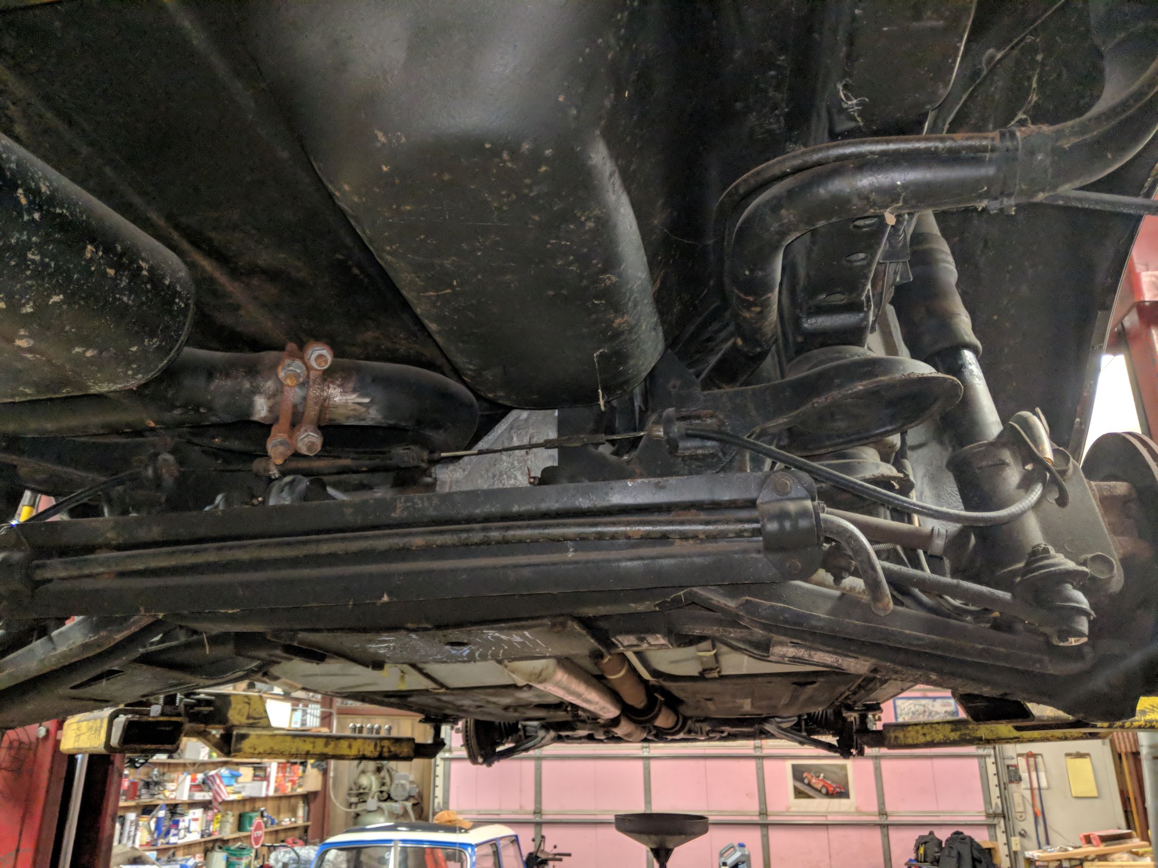

Here is my first looks at the car when I got it on the lift.
No special order here...

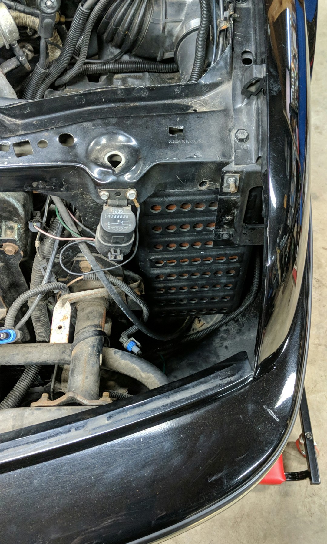

Found out they were using a MAF on this setup vs speed density.

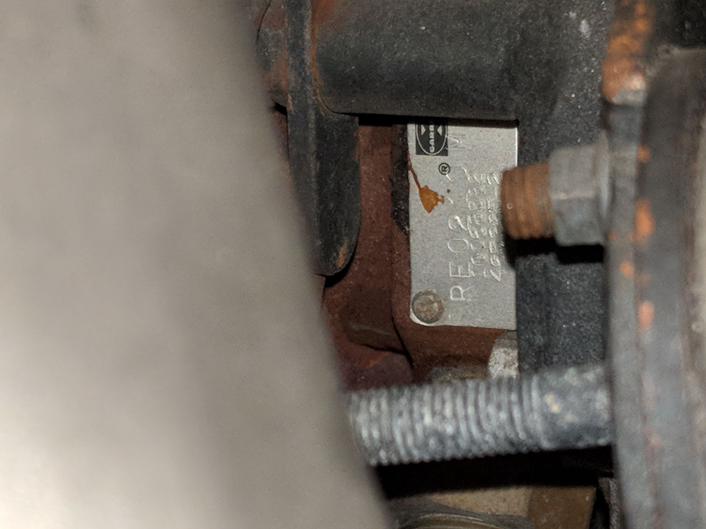

Tag on turbo CHRA Internal Waste Gate arm, Silver tab in center of photo, the diaphragm pictured is for the wastegate. VNT actuator arm. Dual vacuum diaphragms, one for vanes and other for gate.
