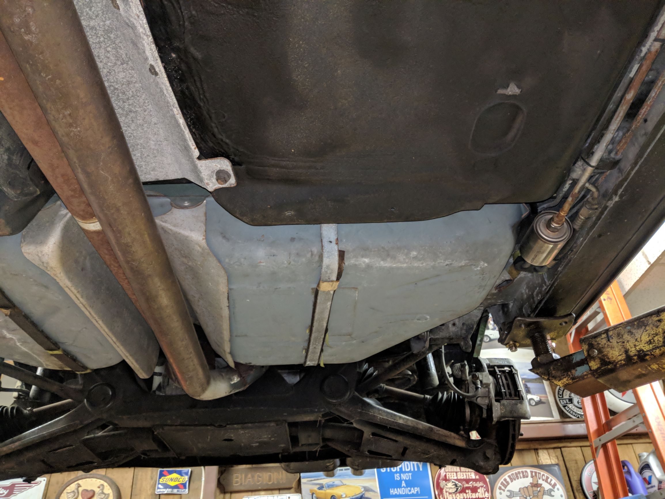

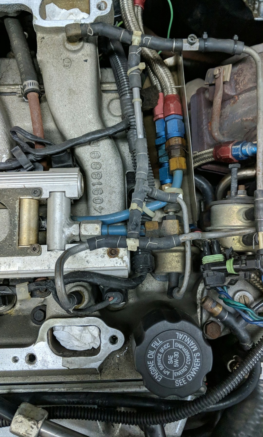

Since buying this car I have found a few items that needed to be replaced or serviced since it’s been sitting so long… Lets start with the fuel system. Luckily the tank and everything else was in good condition and working order, the injectors on the other hand… those needed to be fully replaced. Being so old, one failed shut and another was stuck open. Car ran, but not well at all. I did get the car running and driving for Bfest 2018, but unfortunately the turbos were not up to snuff to perform the way they should. They are variable vane turbos and the rear one the vane system is stuck in the quick spool location. They are supposed to transition to allow more flow as the boost rises but the actuator was stuck. That’s a project for the future when I really dig into it.

replaced braided fuel lines due to leaking/vapor issues

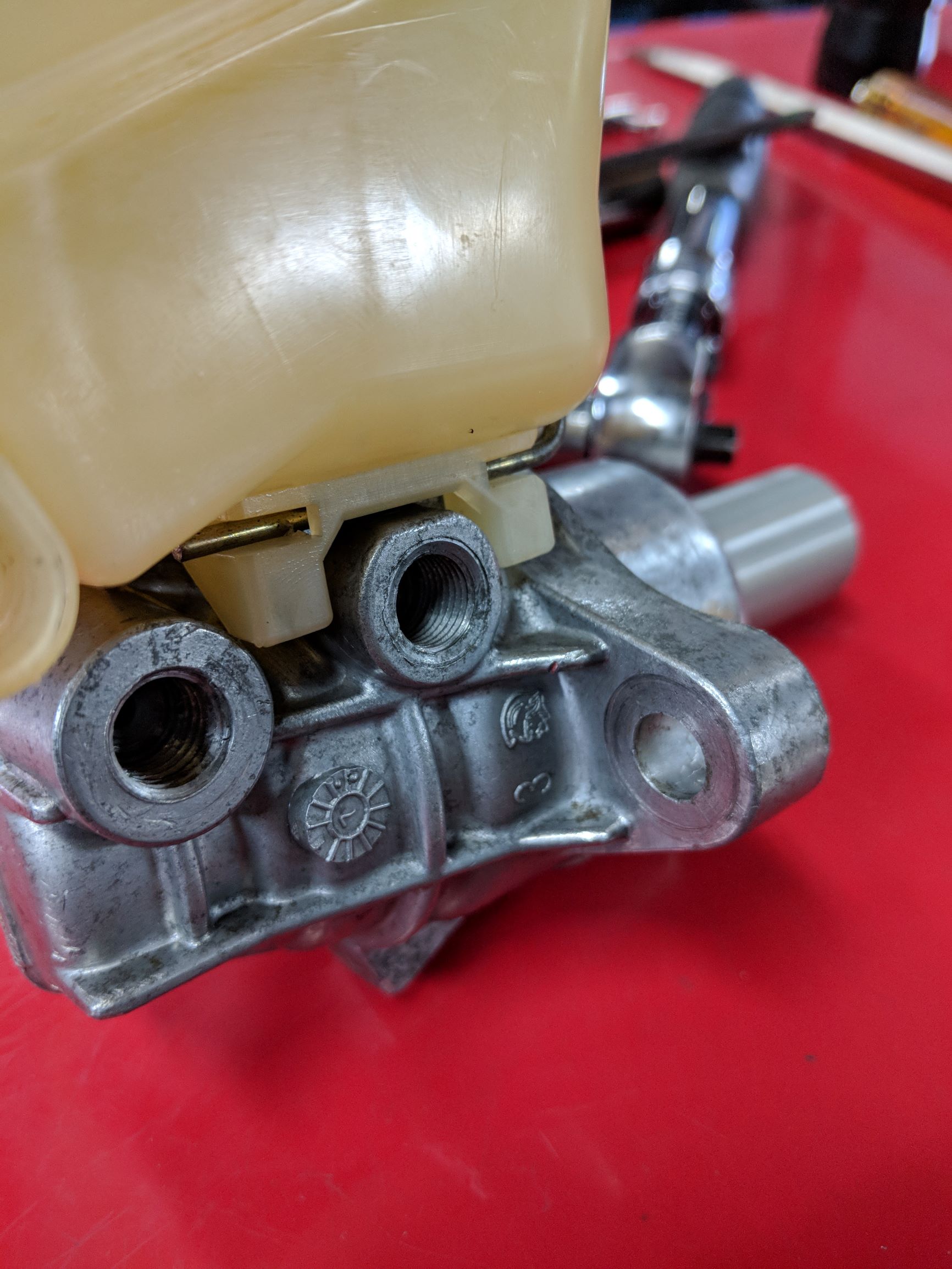

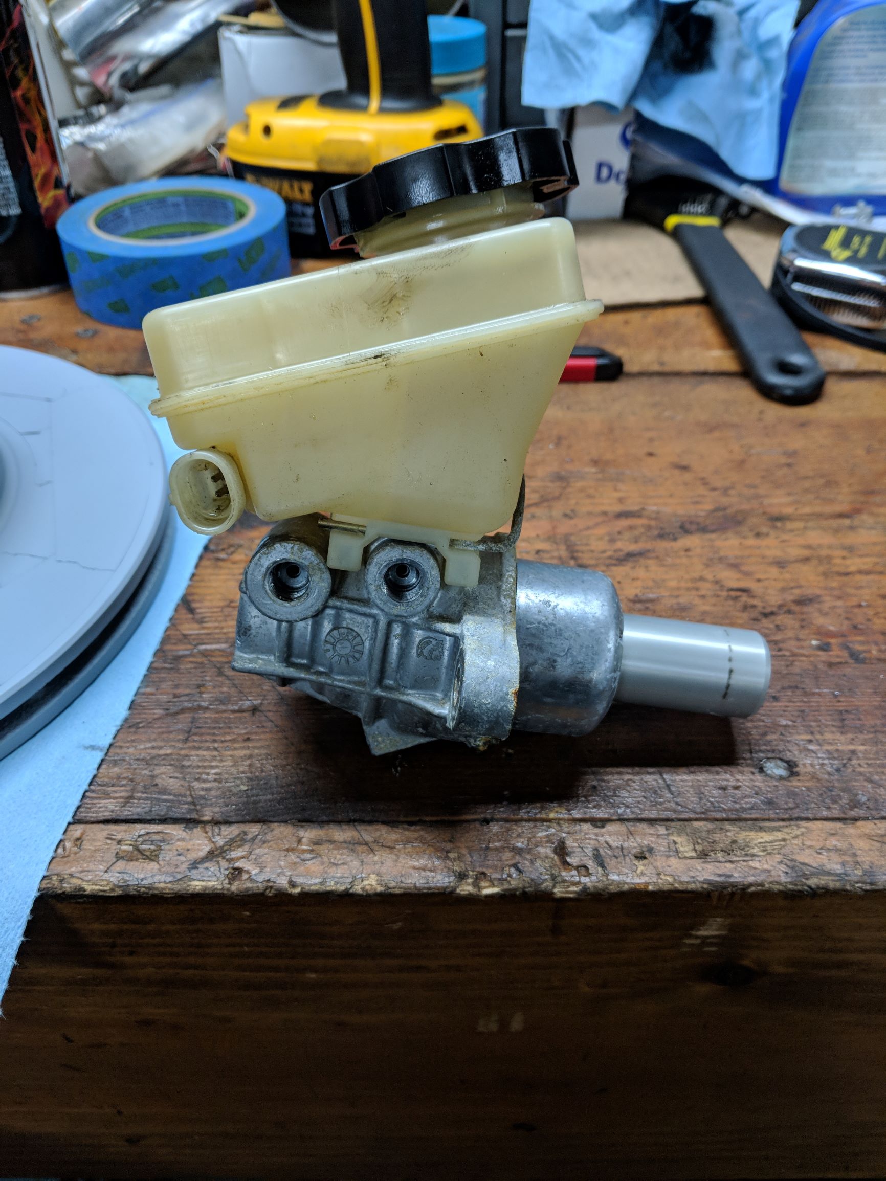

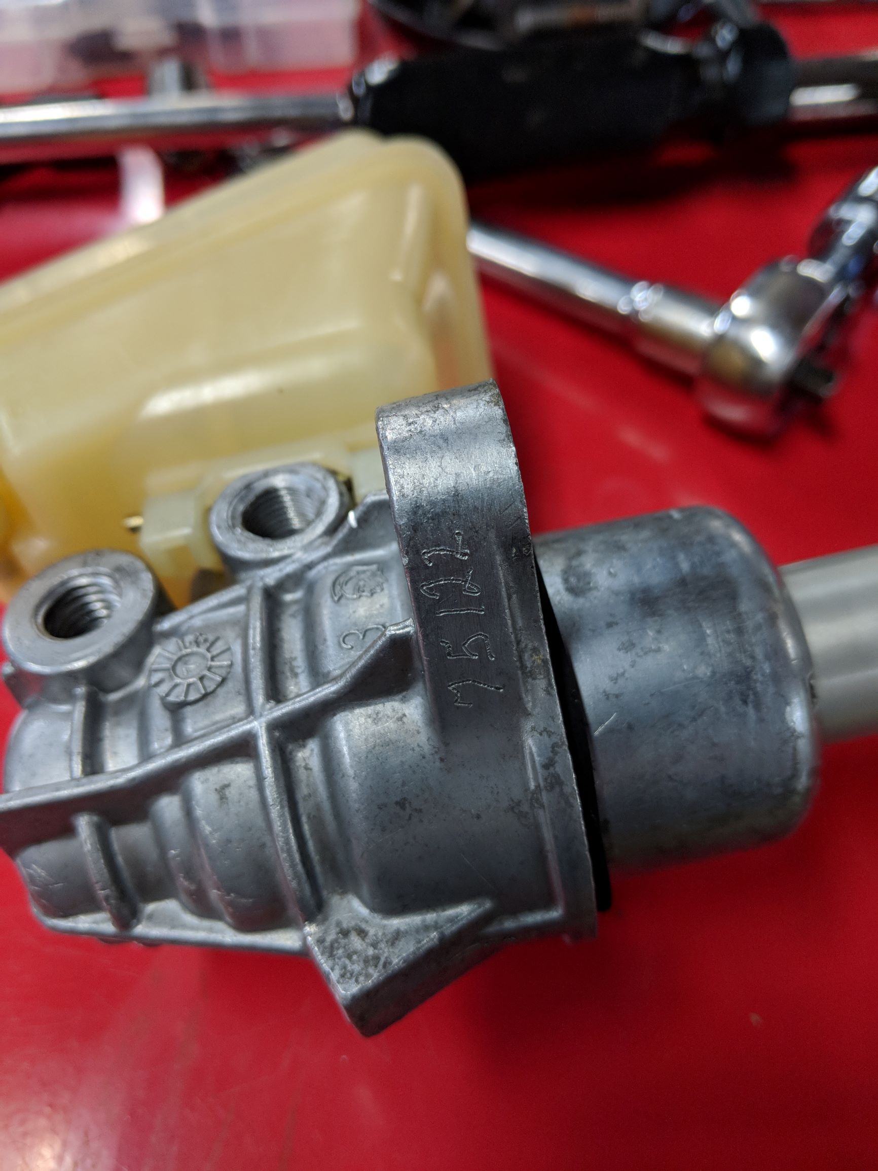

tore down, cleaned up and rebuilt brake master (can't find seals to replace, application unknown)

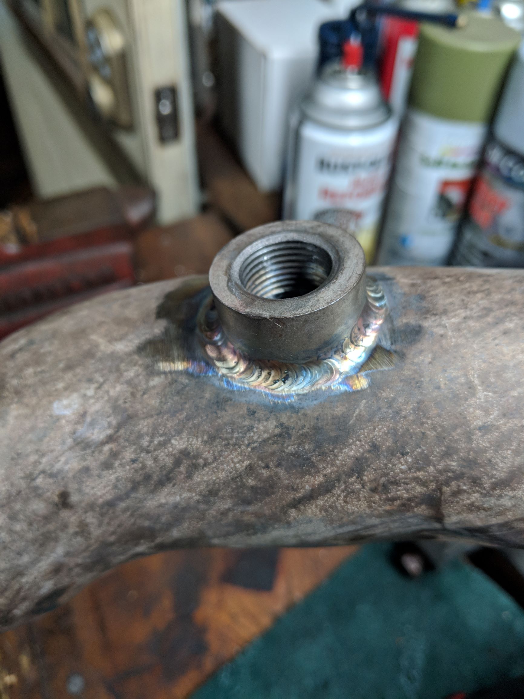

welded in O2 sensor bung so I can monitor O2 with wideband, No narrow band used at all.

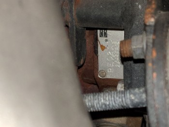

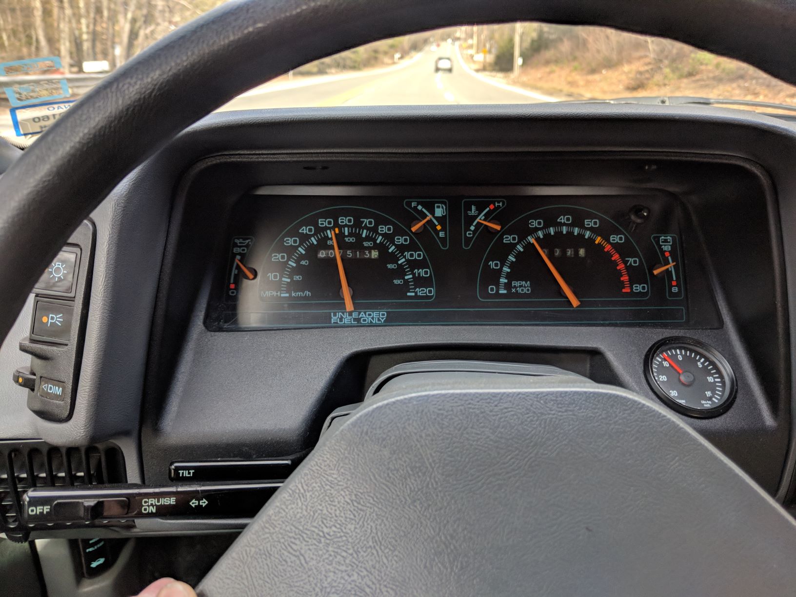

My first sighting of the car since I saw it 10yrs ago. Car had sat for that entire time... When I saw it in 2011 ODO reading, 7471 From what I can read, bad angle. And shortly after I got it road worthy... yes I know I did not take a ODO pic when picking it up... So at the most the previous owner drove it 30-40 miles since I saw it in 2010.

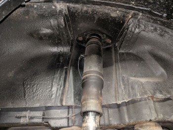

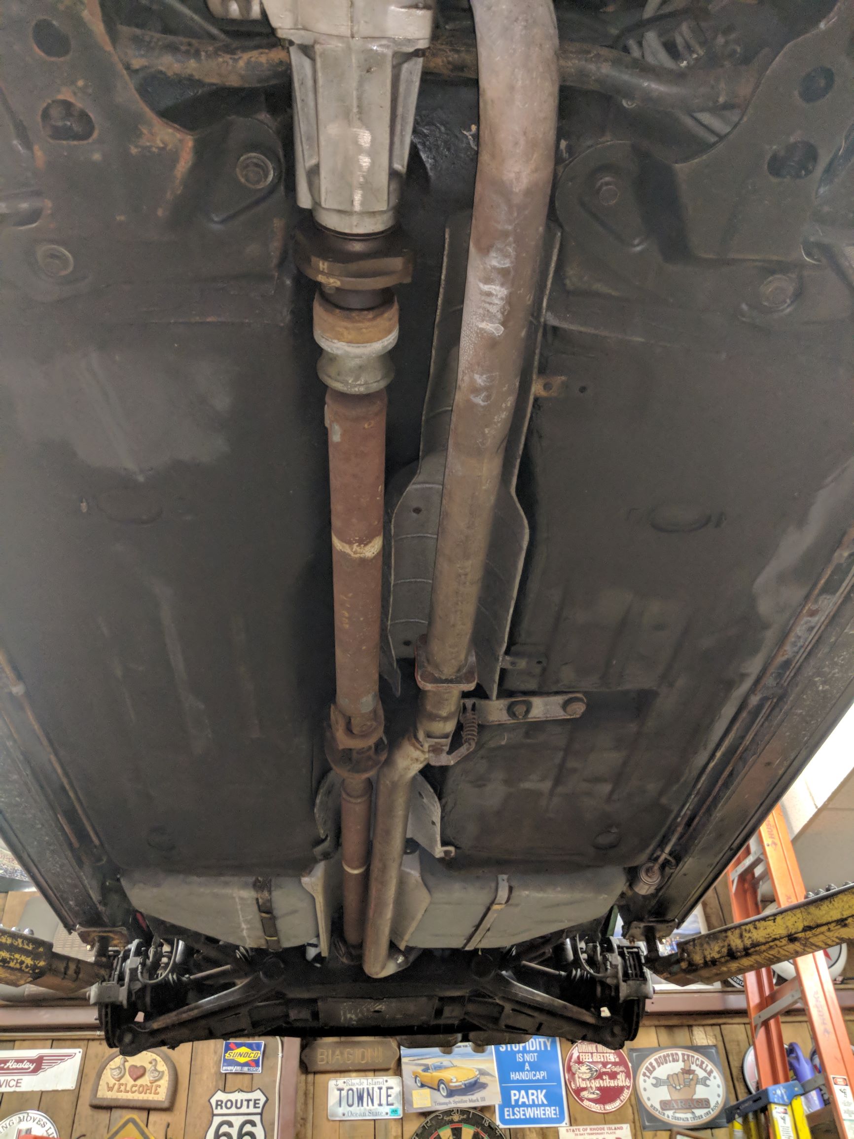

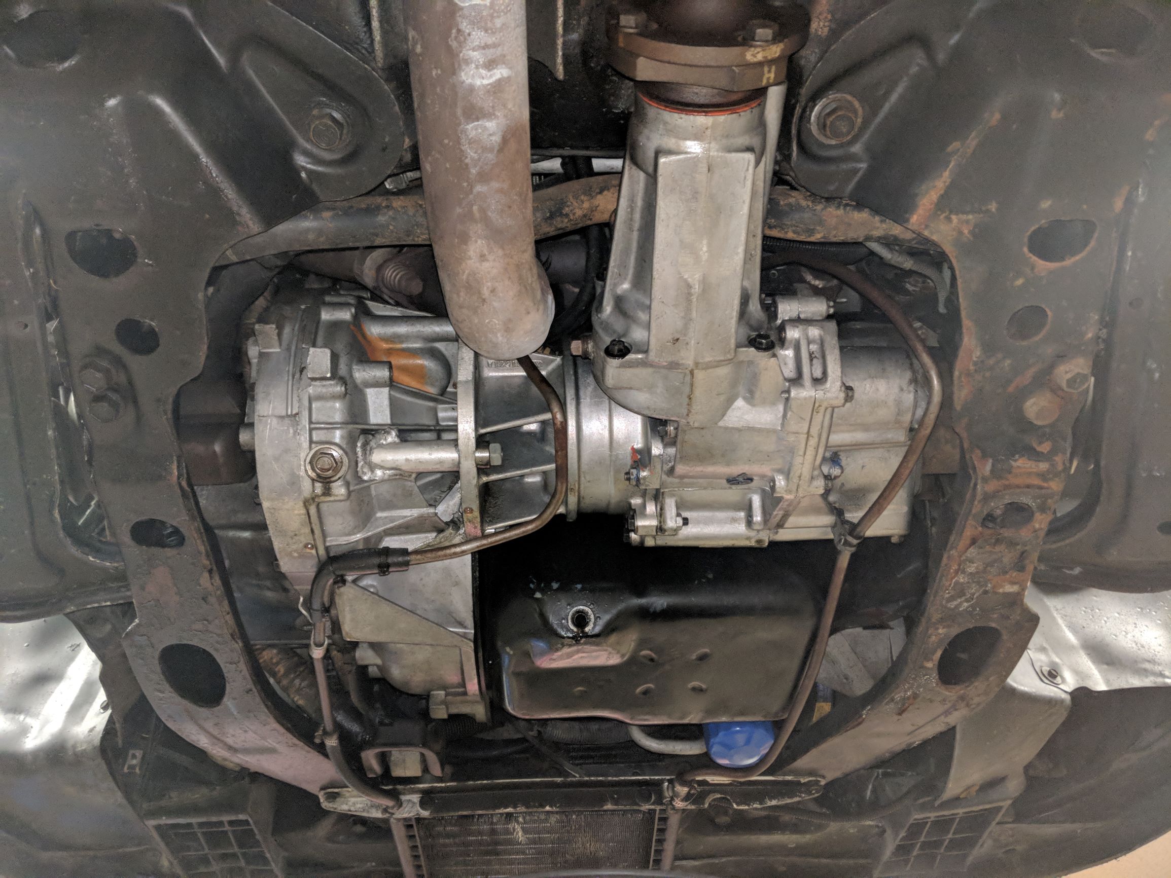

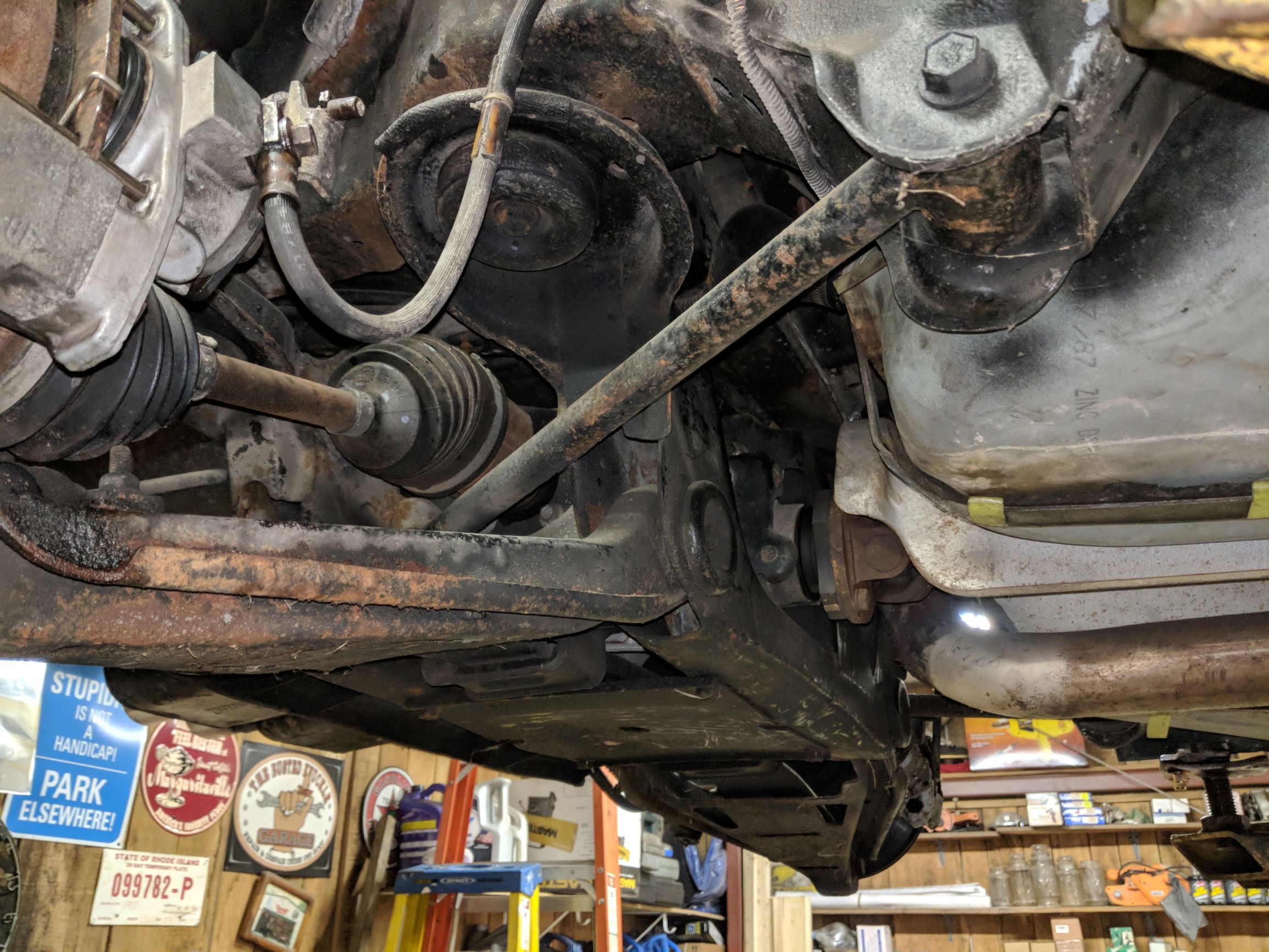

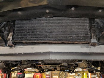

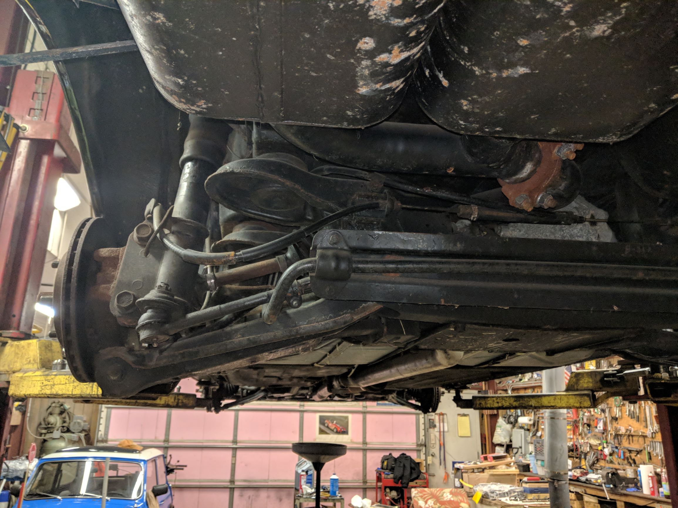

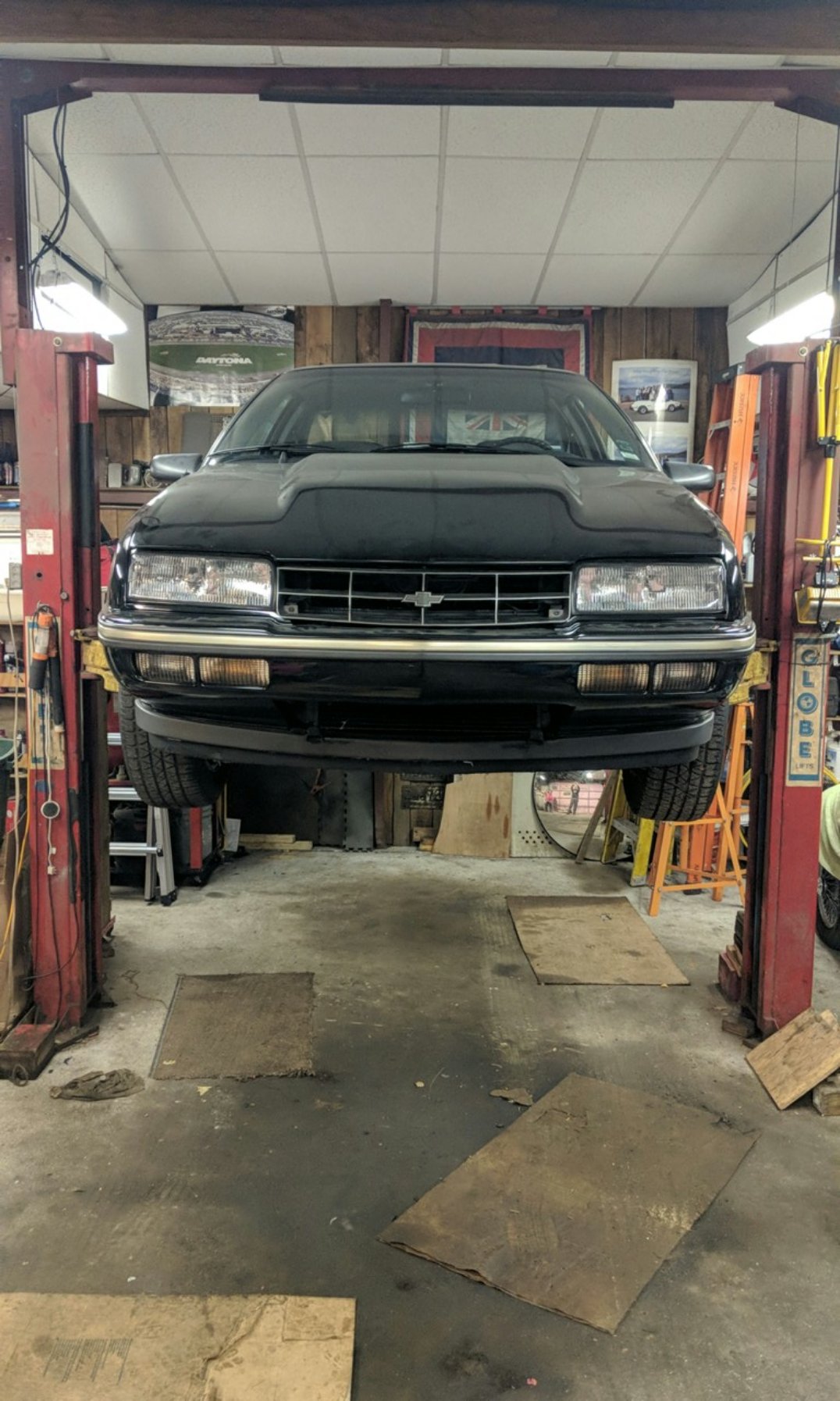

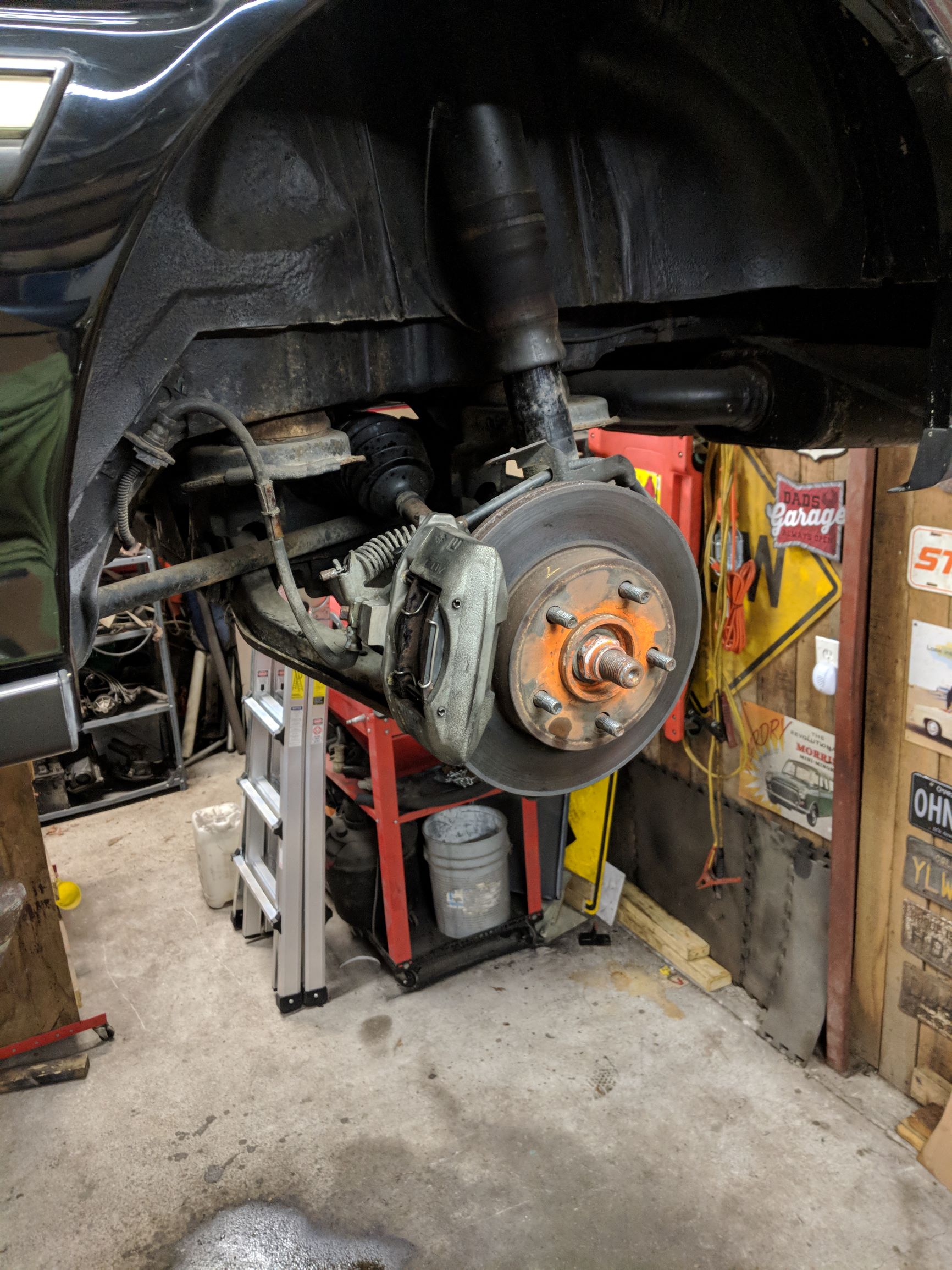

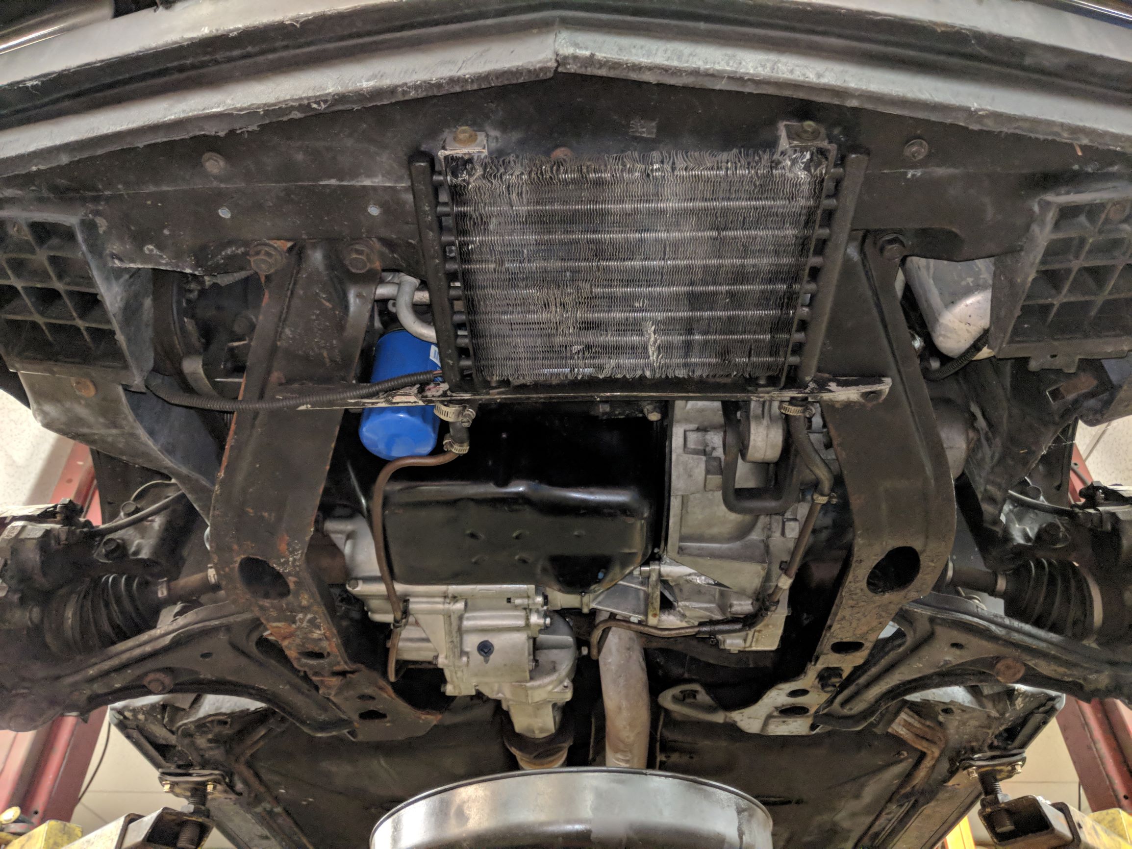

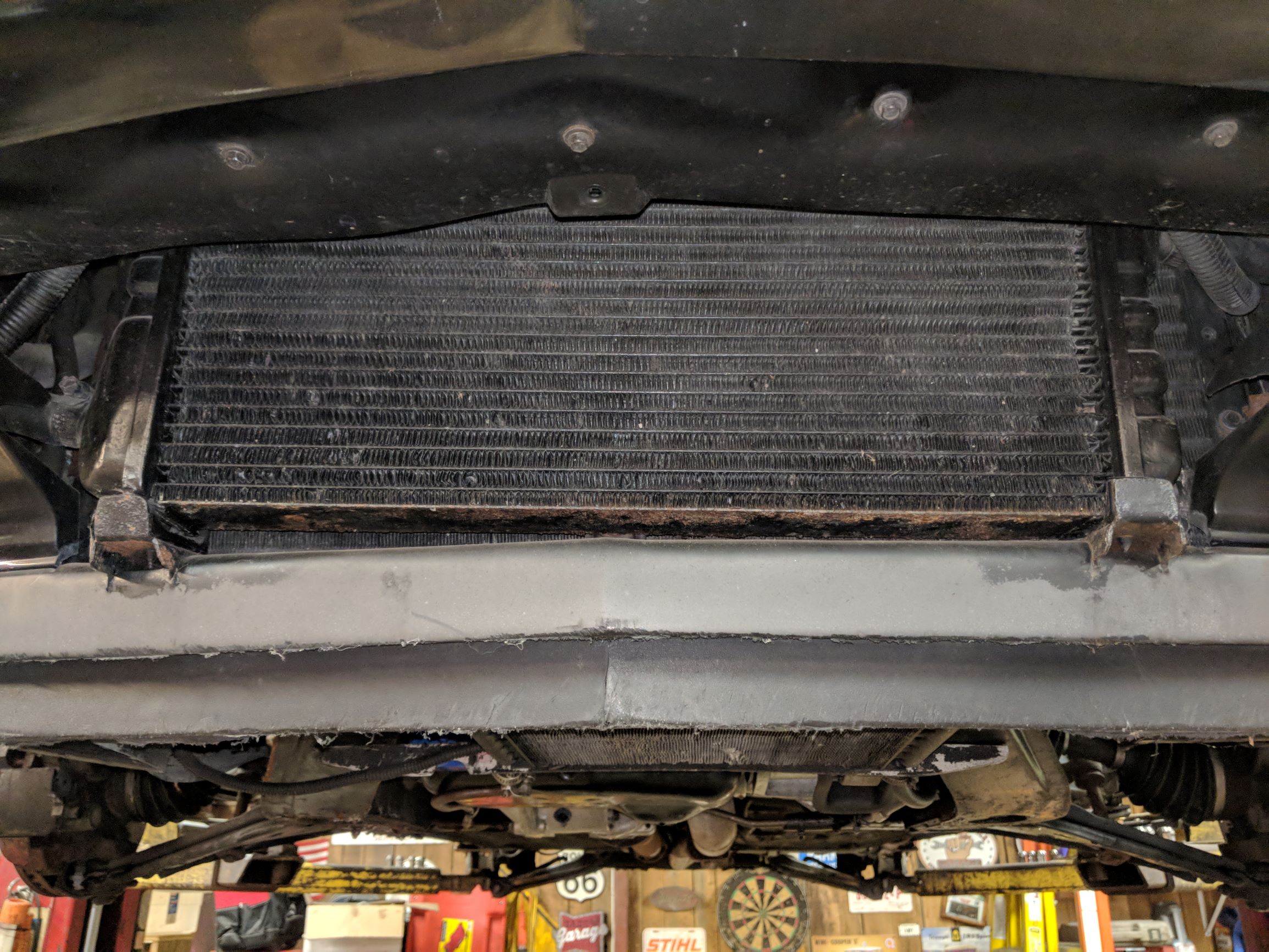

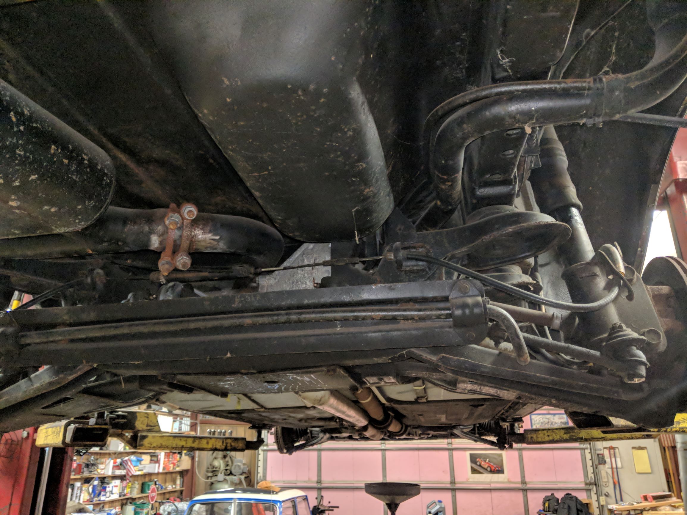

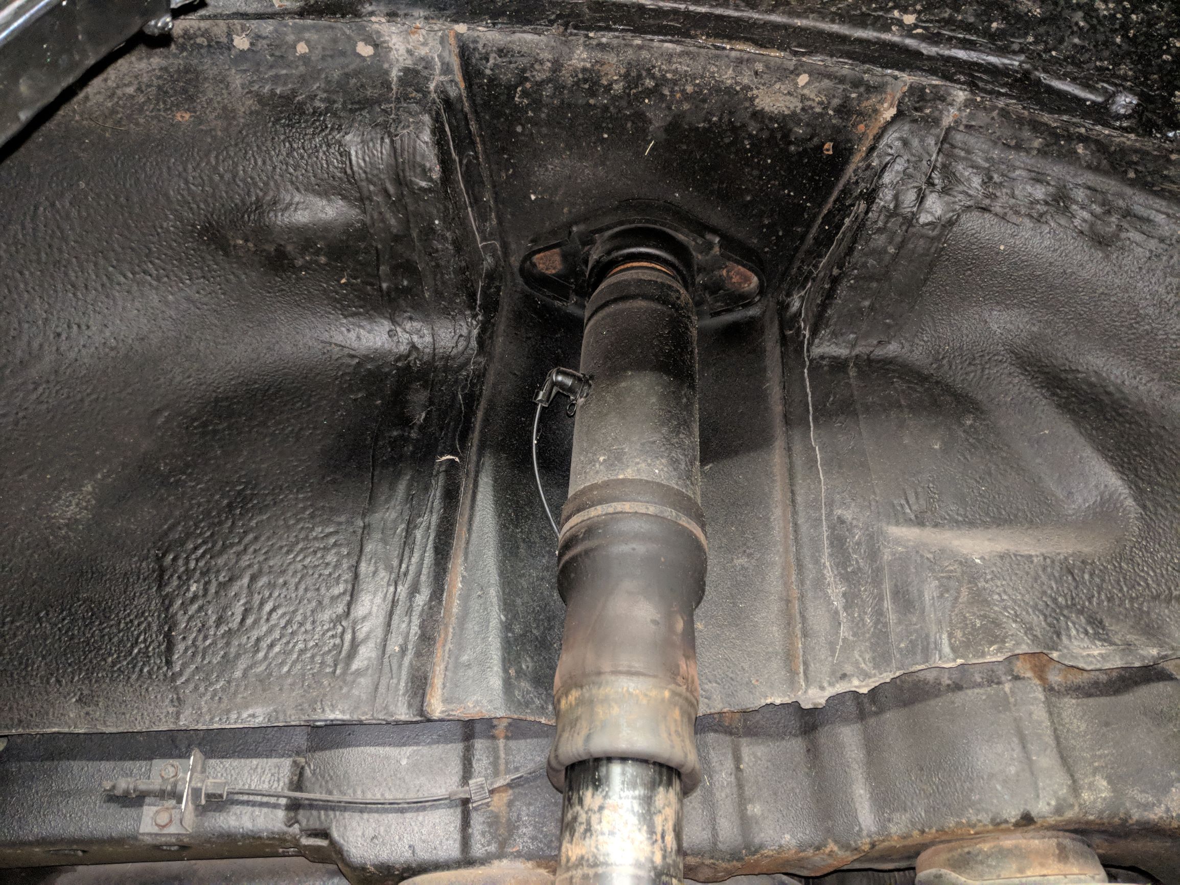

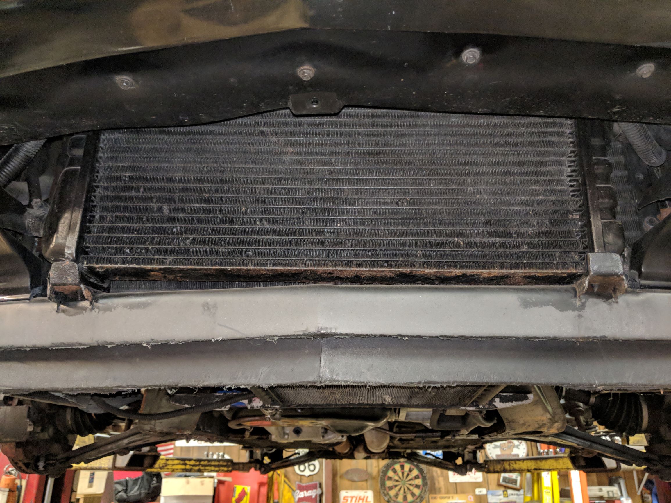

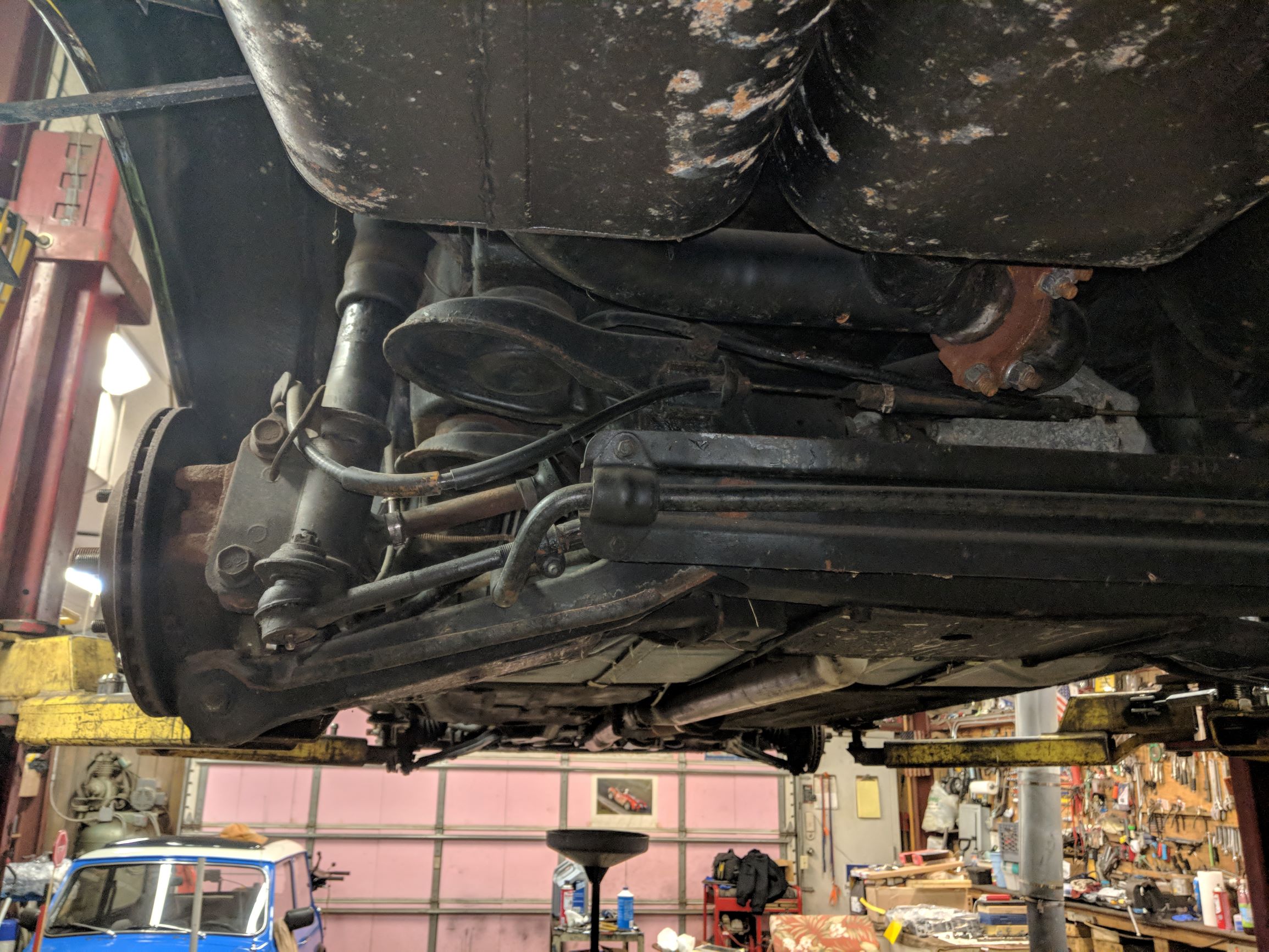

Here is my first looks at the car when I got it on the lift.
No special order here...

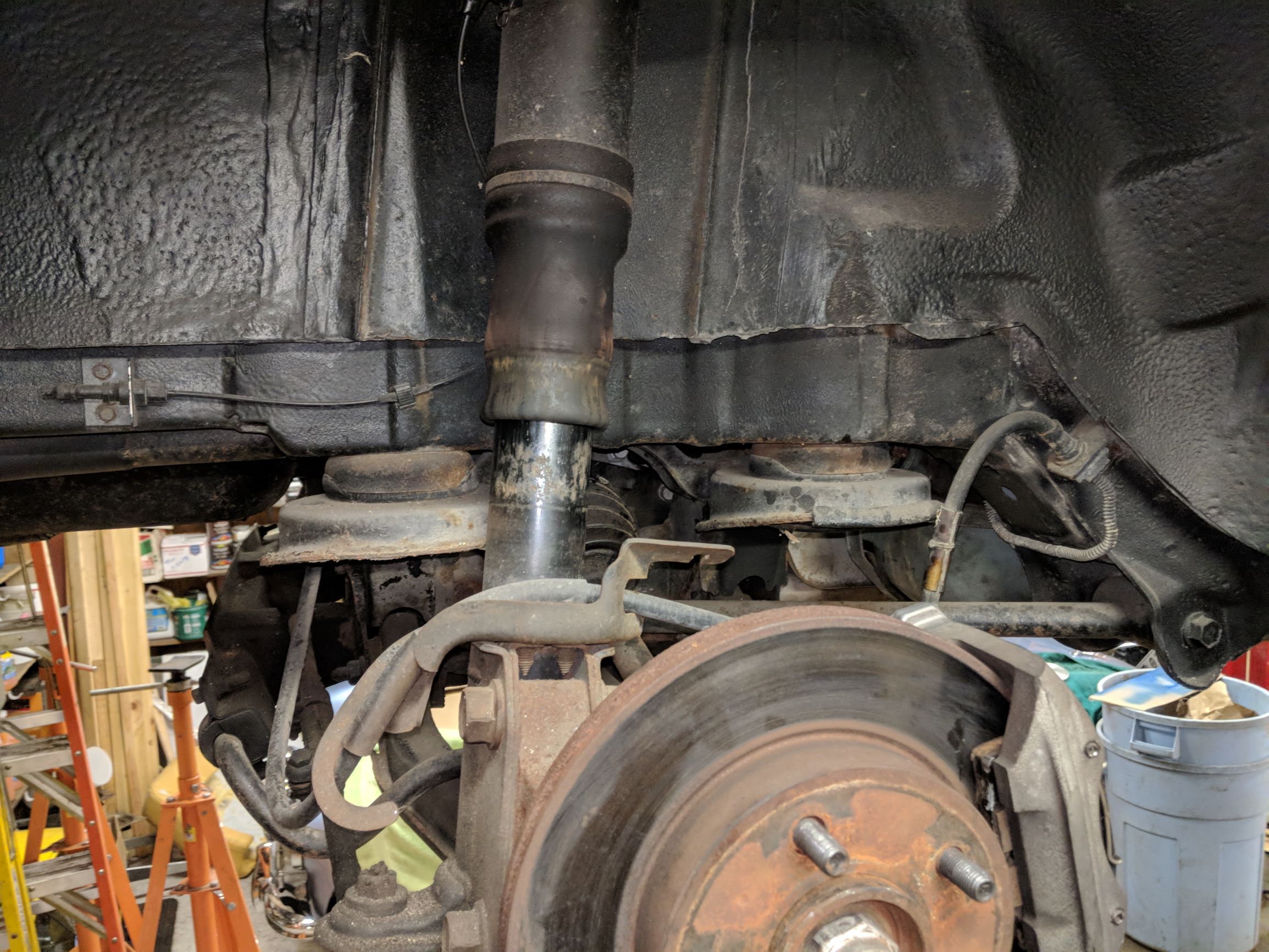

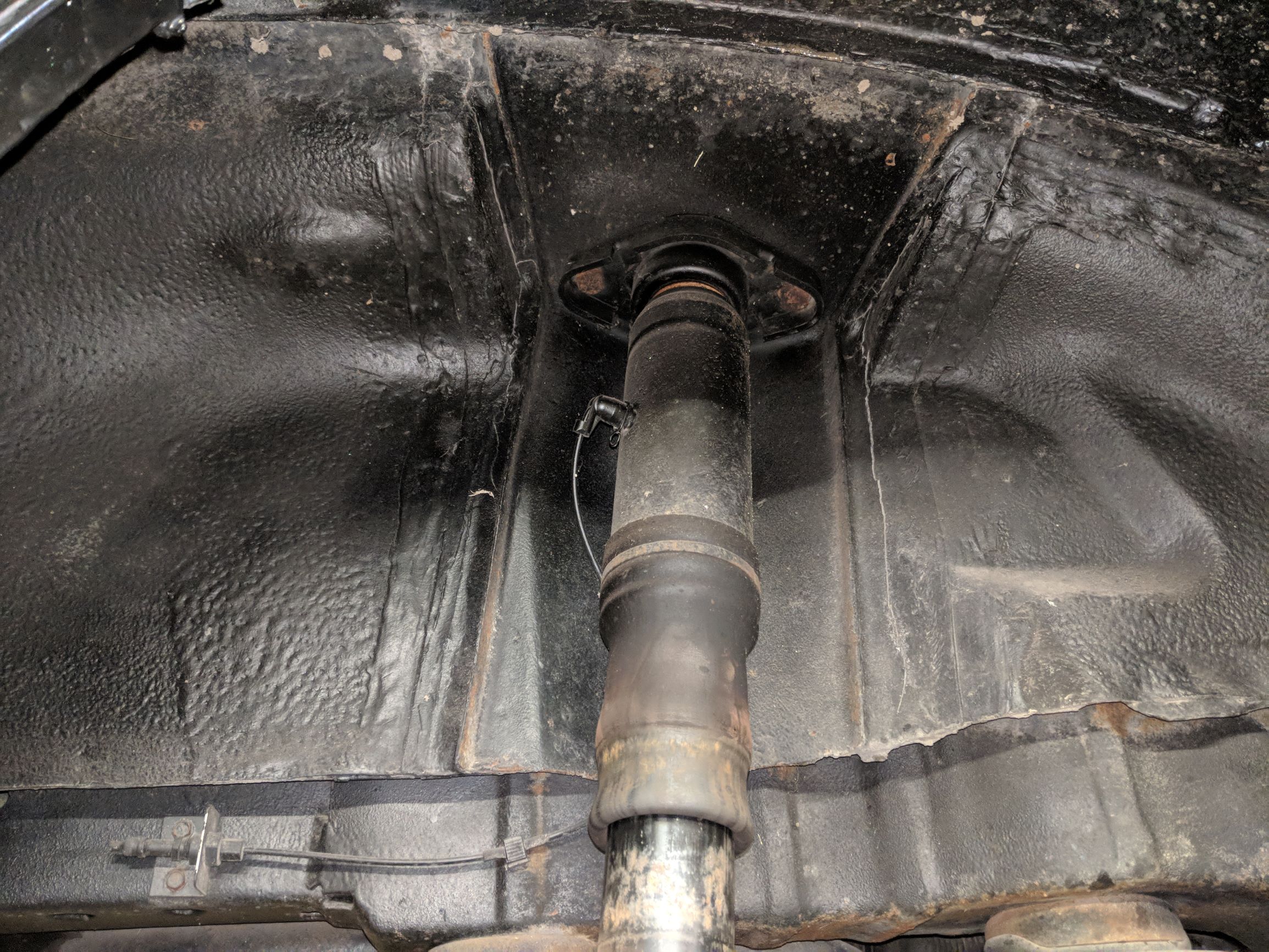

Now came the issues...
Bad Motor mounts,
Clogged Injectors,
Leaking Water pump,
Leaking calipers,
Leaking Master Cylinder,
Dry rotted brake lines,
Dry rotted tires,

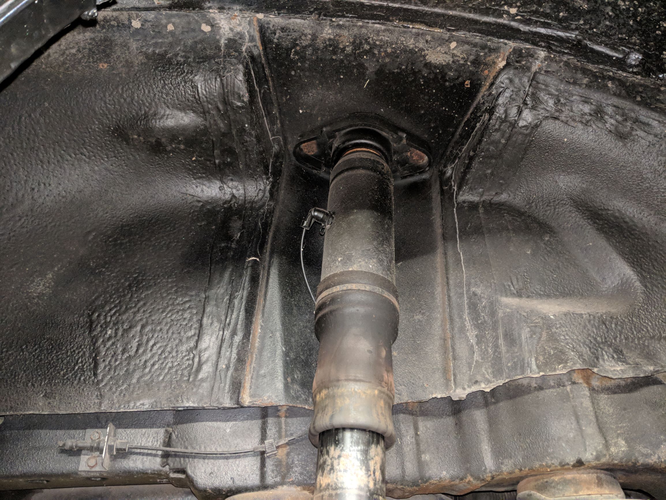

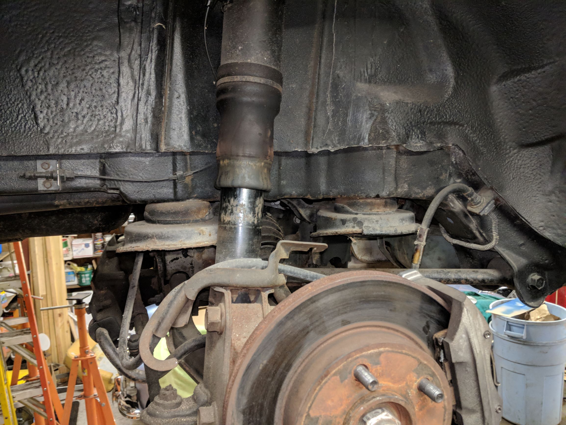

Bad upper spring mounts,
I think that's about it...

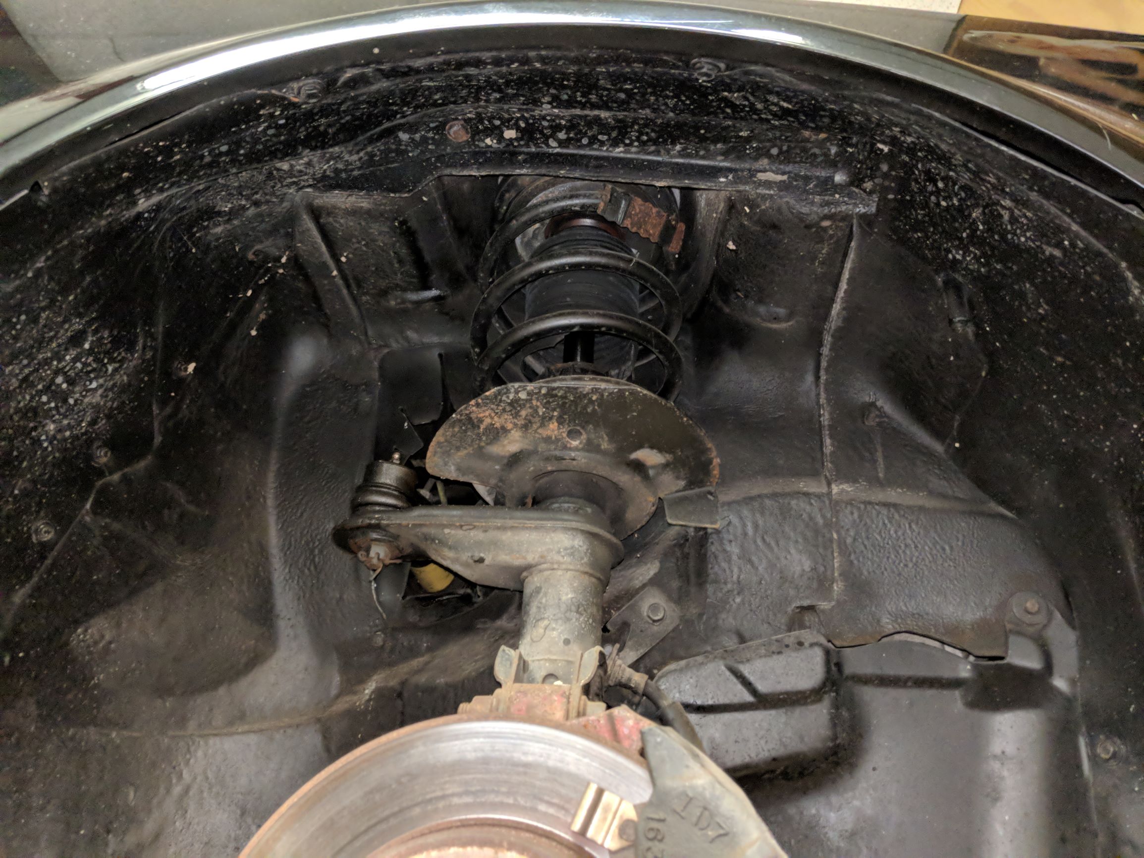

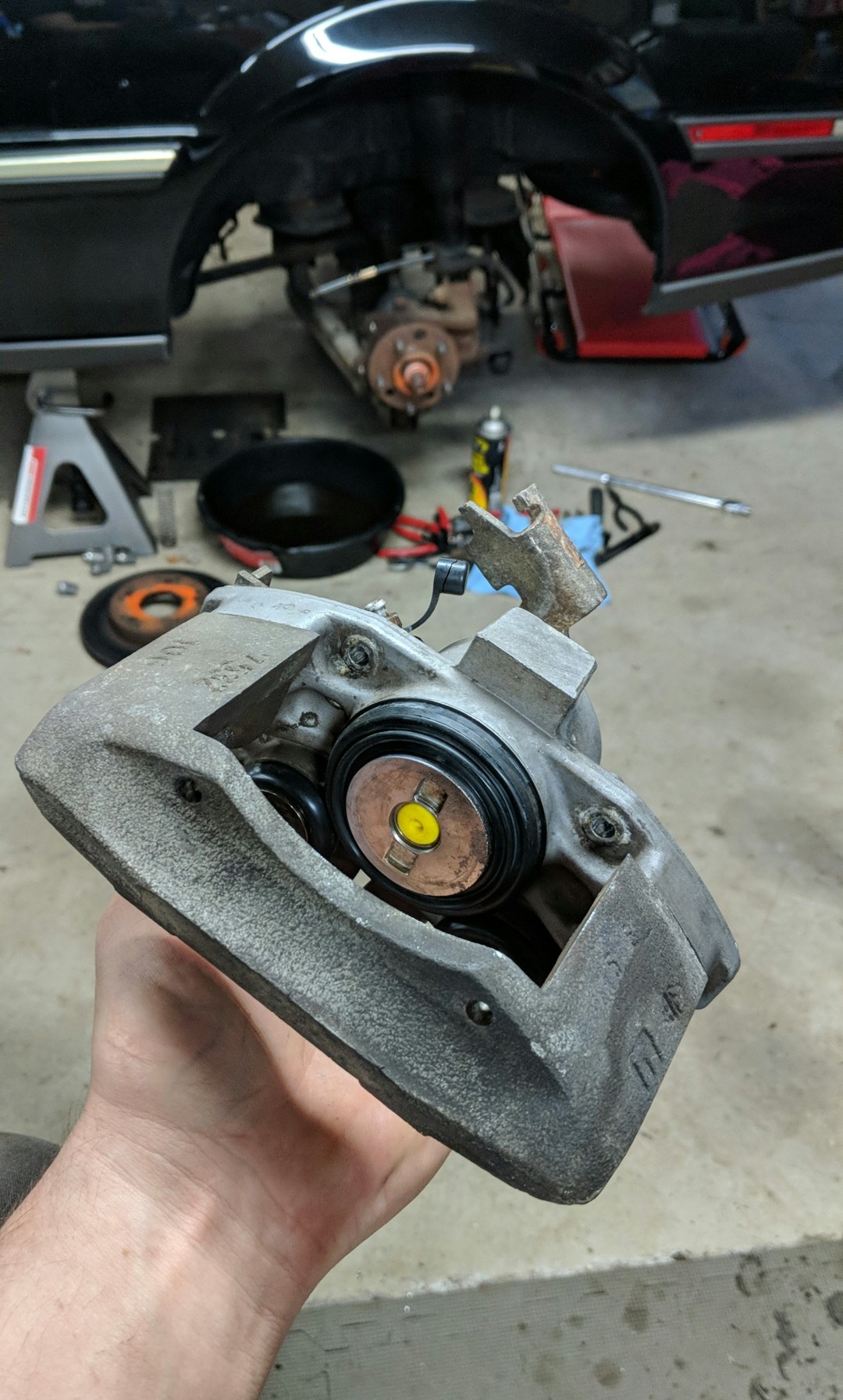

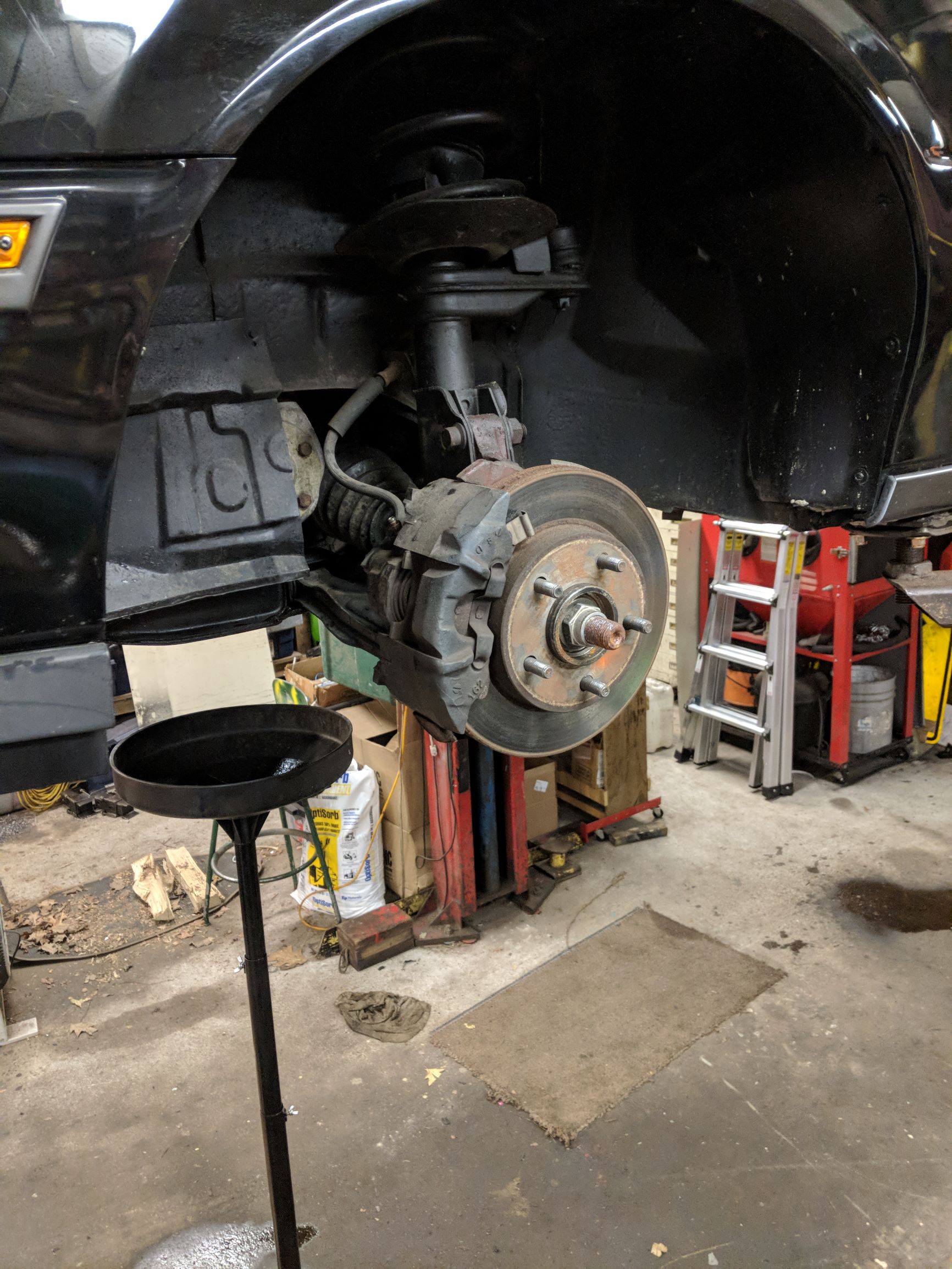

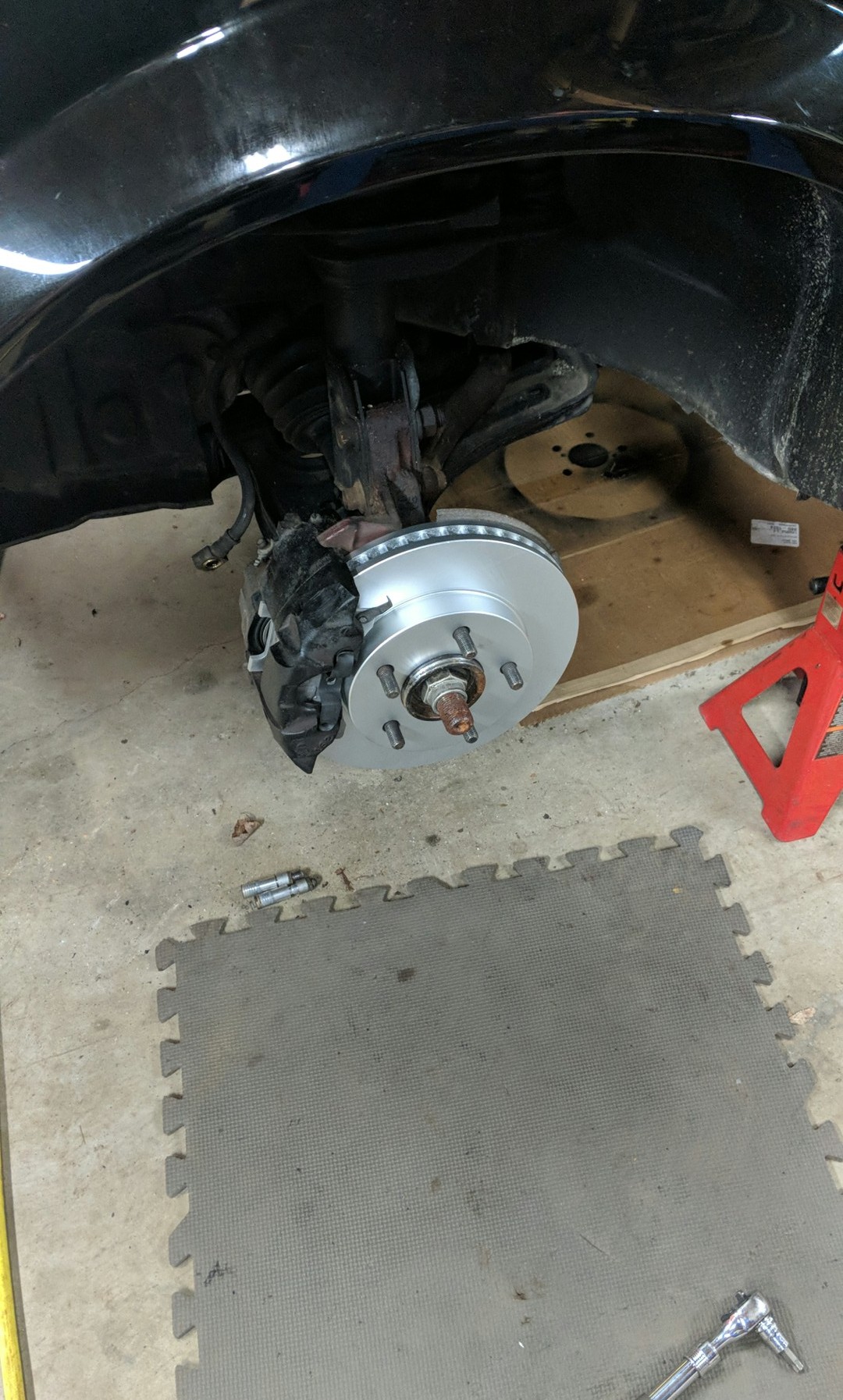

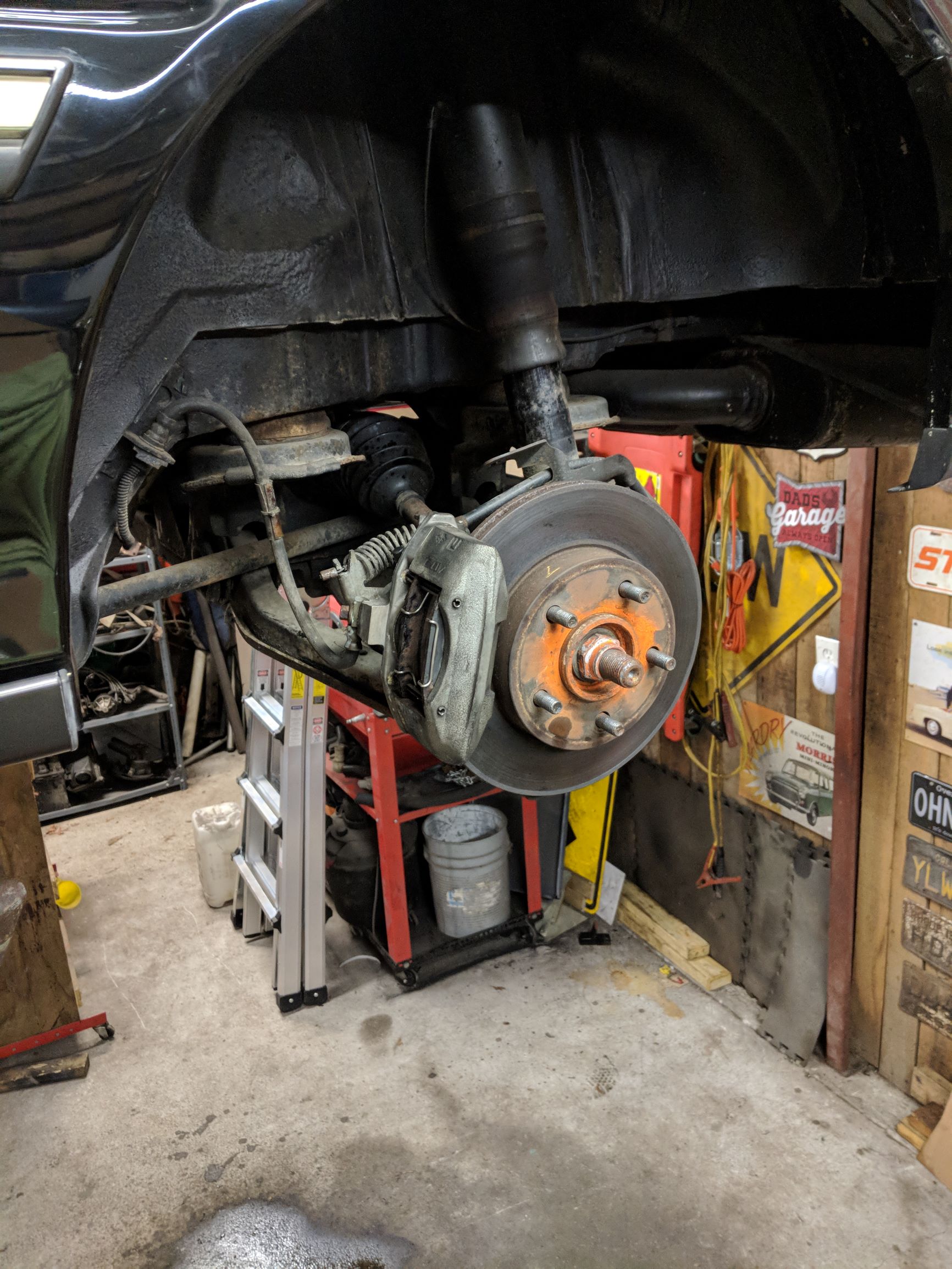

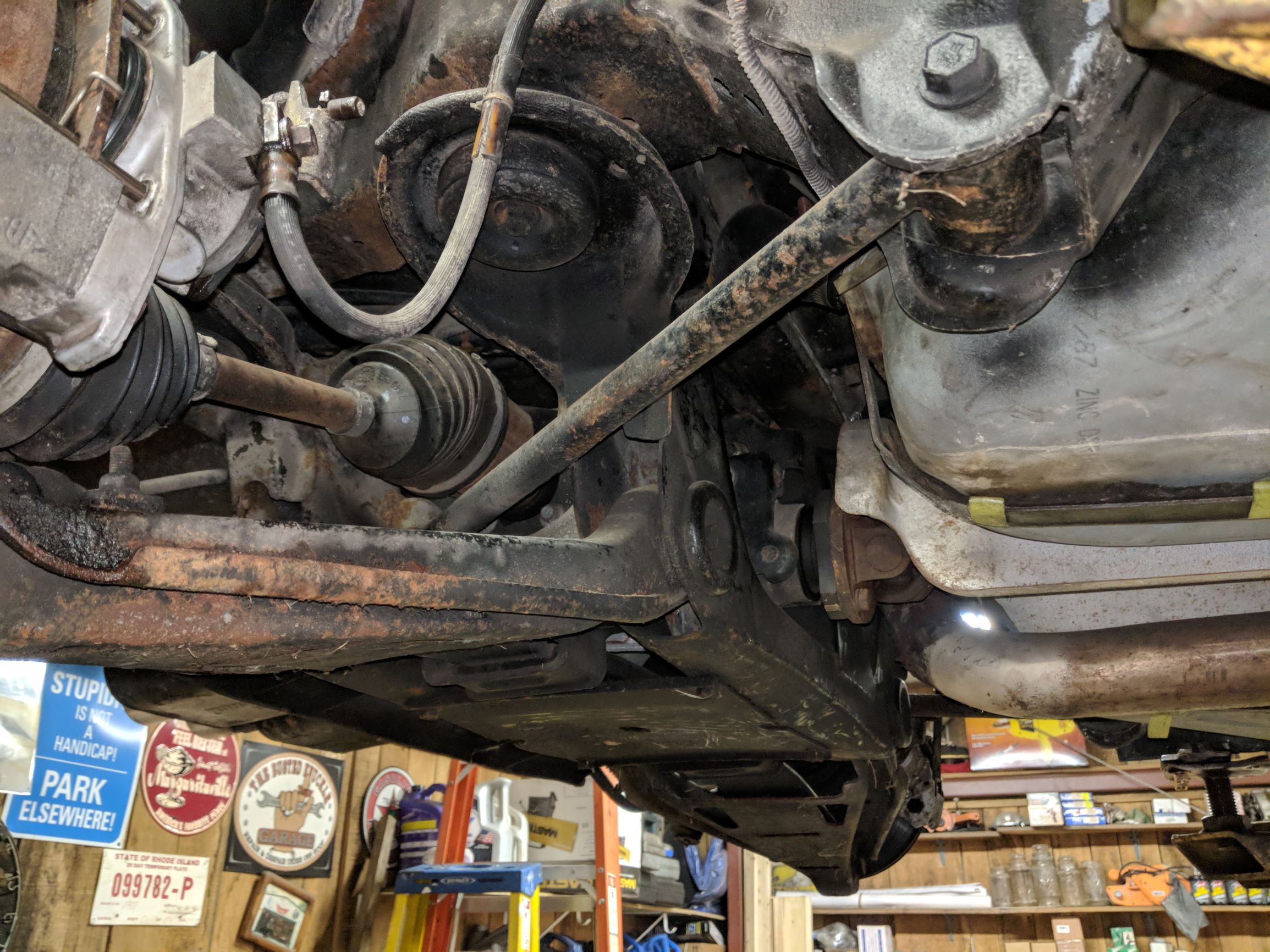

First things first was to get the brakes all set, so I figured out it has HD A-body front calipers and Fiero, or Pointiac 6000 rear calipers. I ordered up the various rebuild kits and rotors to fix everything that was on there. The rear pads were soaked with brake fluid and it was leaking from everywhere back there. I did some quick seals on the fronts, and rear calipers and set it up to bring to my house since it was being stored at my father in-laws for the mean time.

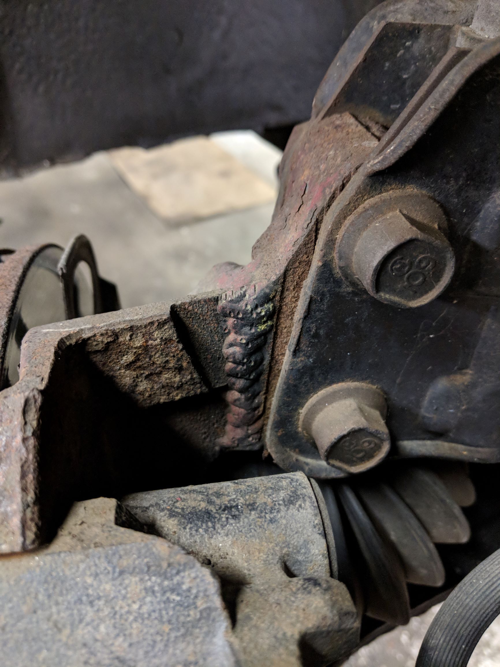

Found something interesting and learned how they adapted the A-Body knuckle to the Beretta strut... The just cut the top off and welded these together!!!
Same welding marks where the ball joint mount goes... Yikes.

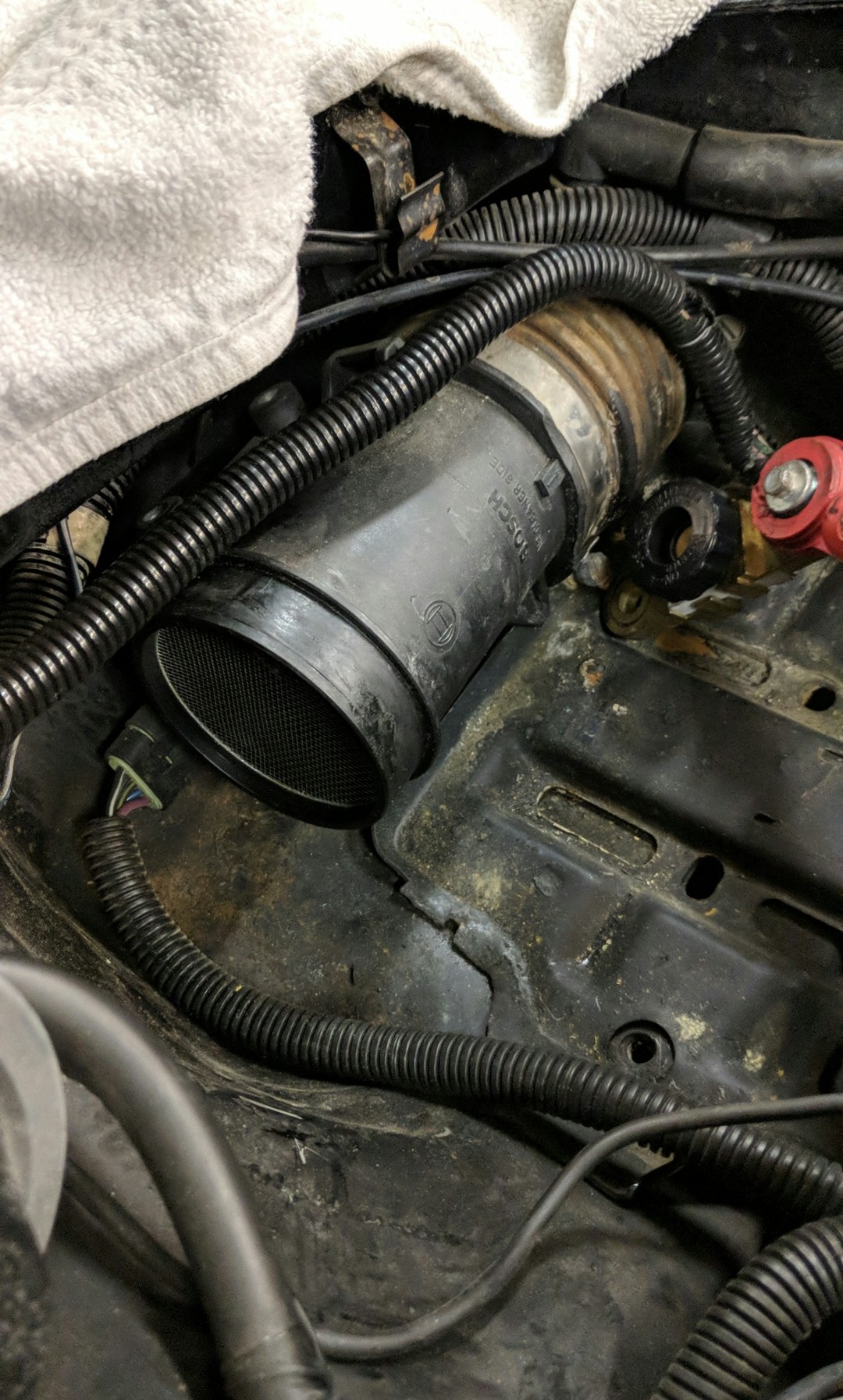

Found out they were using a MAF on this setup vs speed density.

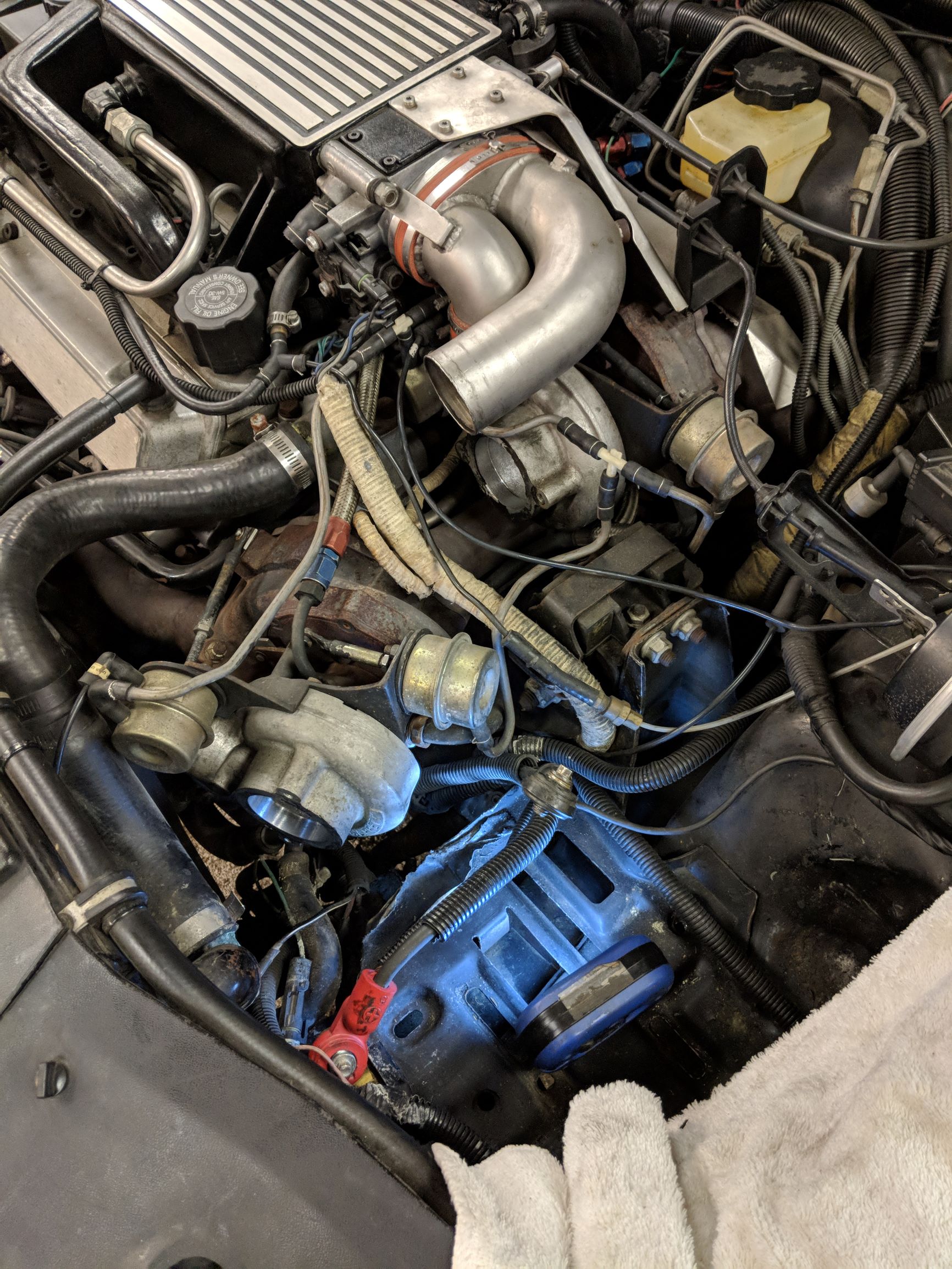

And the Twins in all their Glory while doing the 5-speed top mount.

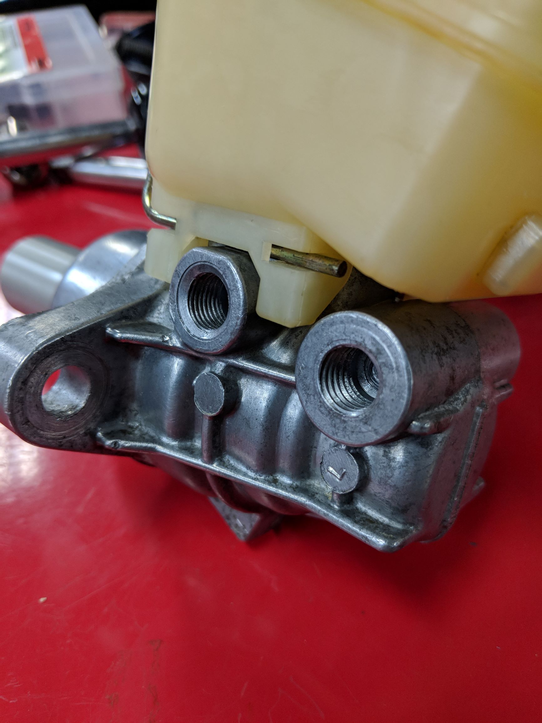

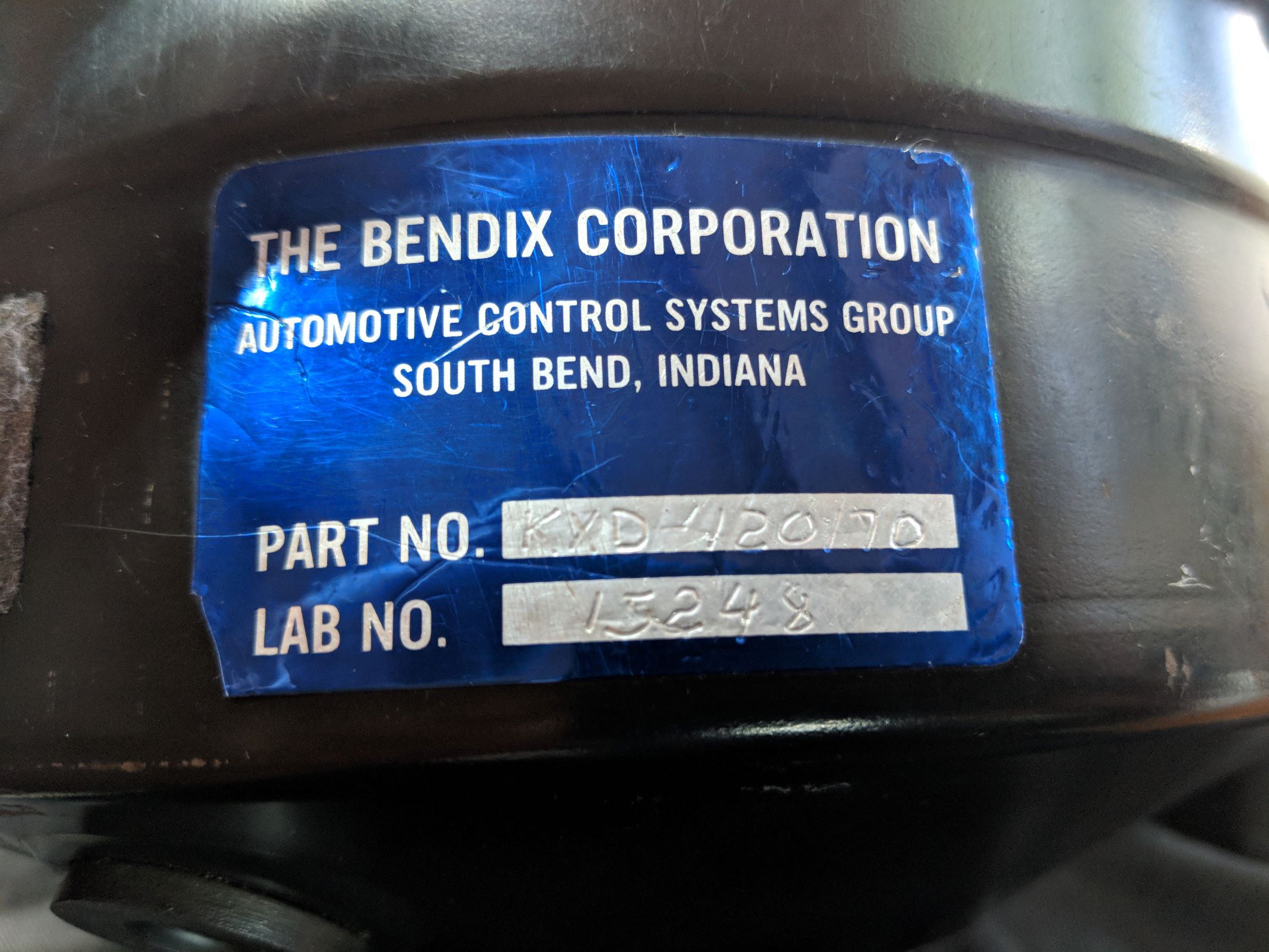

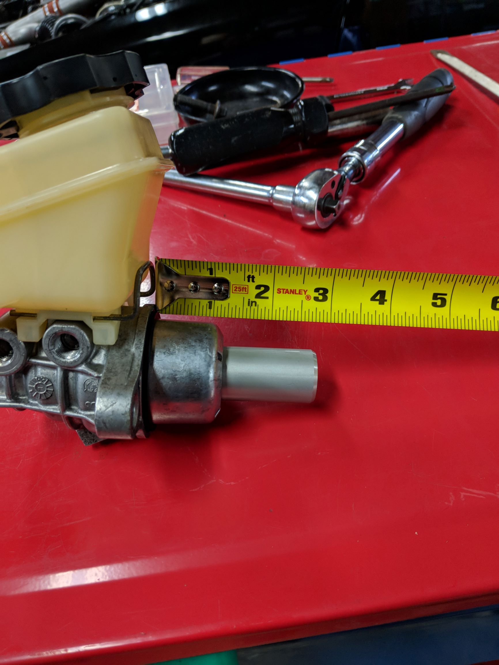

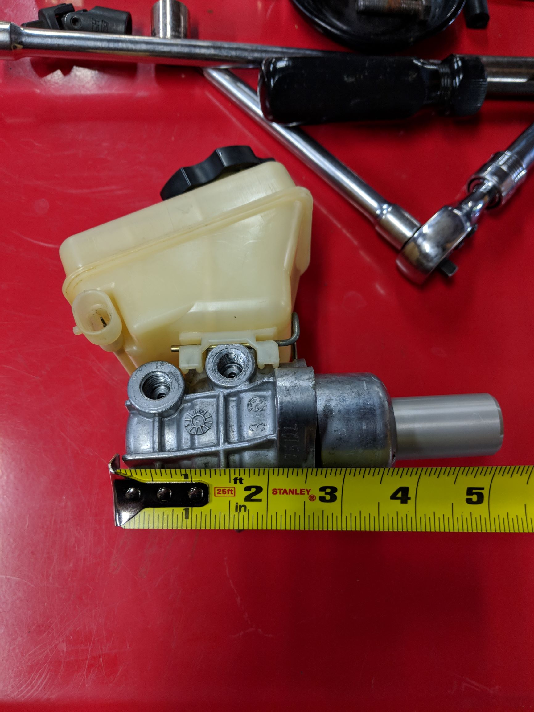

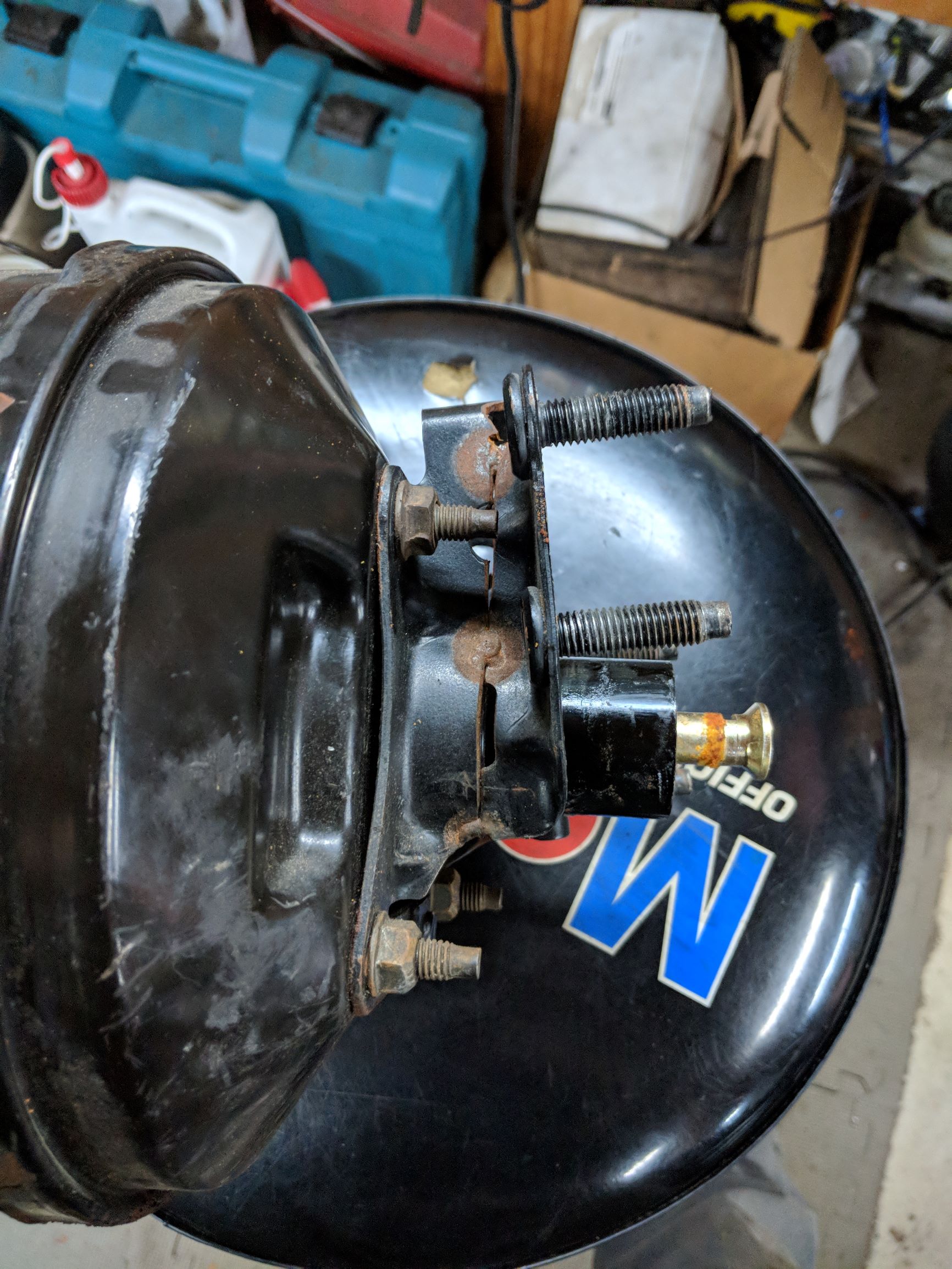

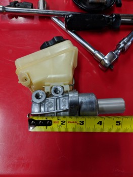

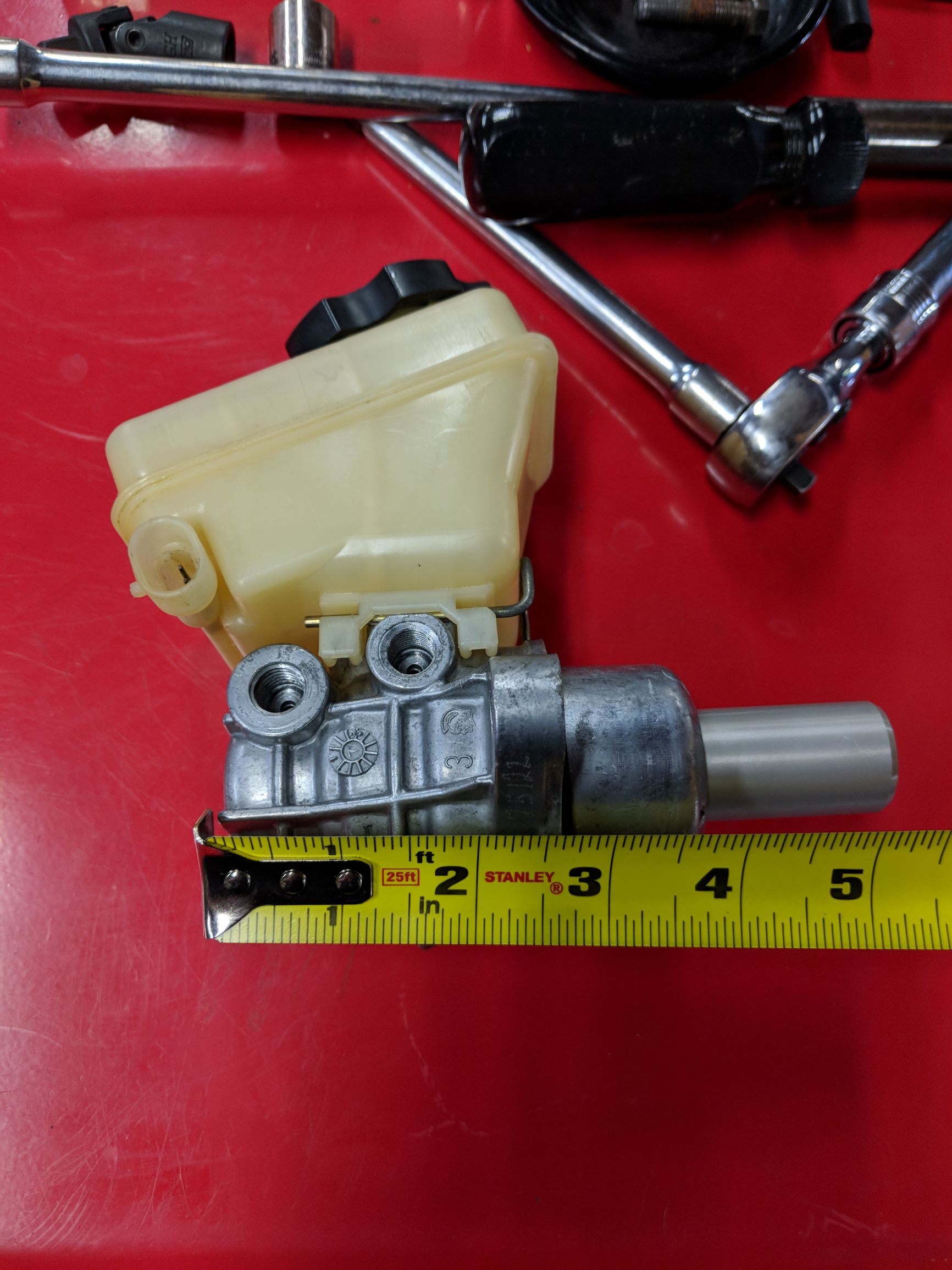

Now the fun began... Pull injectors and send out for cleaning, fully repair brake system including replace lines and rotors, also re-build the rear calipers again because I missed something the first time around (they were leaking again), as well as pull apart the master cylinder for cleaning and documenting. Still have not found what this is from... closest I found was a Isuzu truck, but the one I bought was much larger than this version.
Their highly customized brake booster.

Cool to see these details. Did they offset the brake booster?
- Posts: 10919
Re: 1988 All Wheel Drive Twin Turbo Experimental Car EX-5115
Changed the angle of it to point more up, (sorry that's hard to tell it's a side profile picture of the booster mods) and it's also not a stock type booster at all. They welded the factory bracket to whatever this unit is.

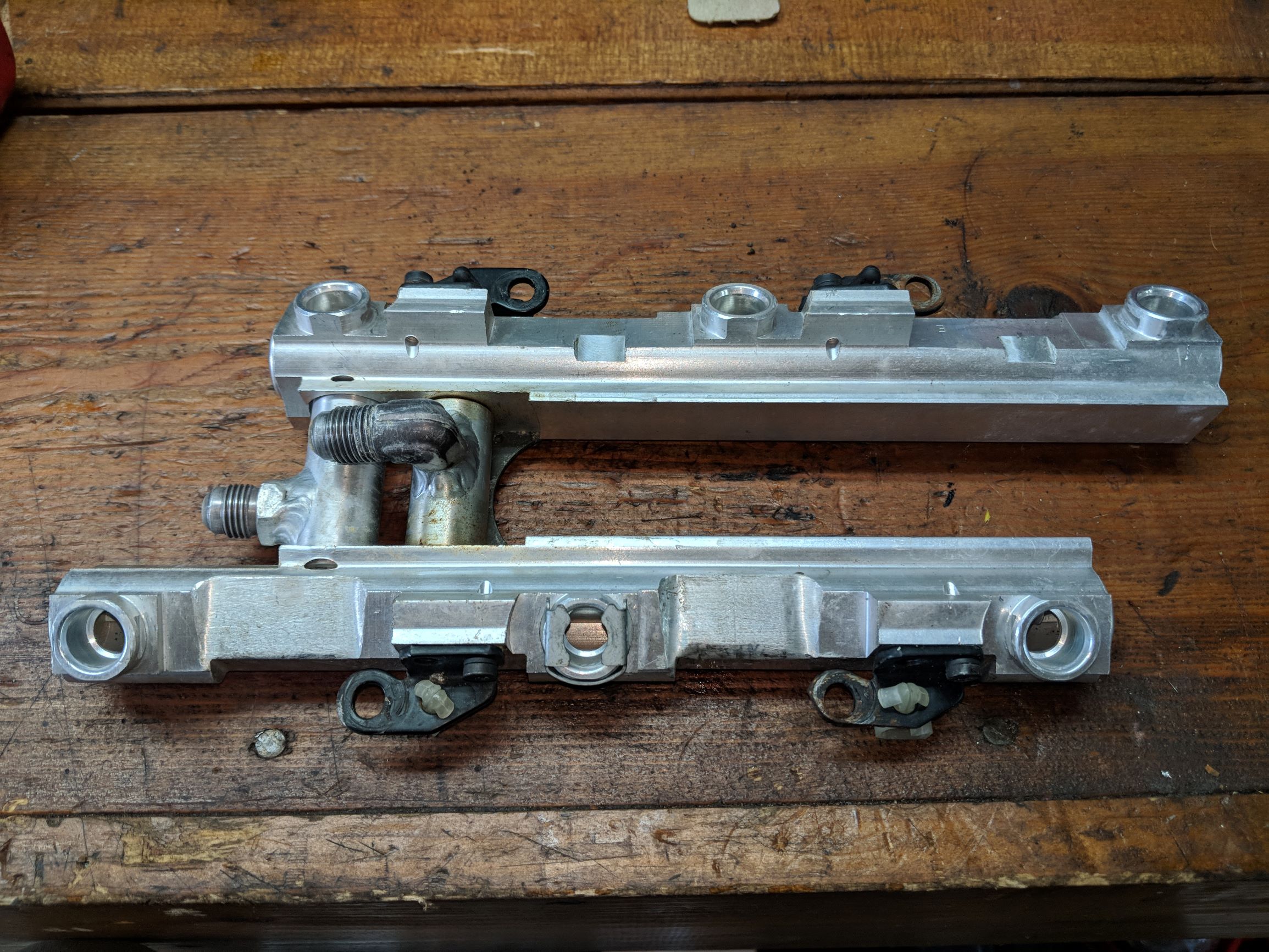

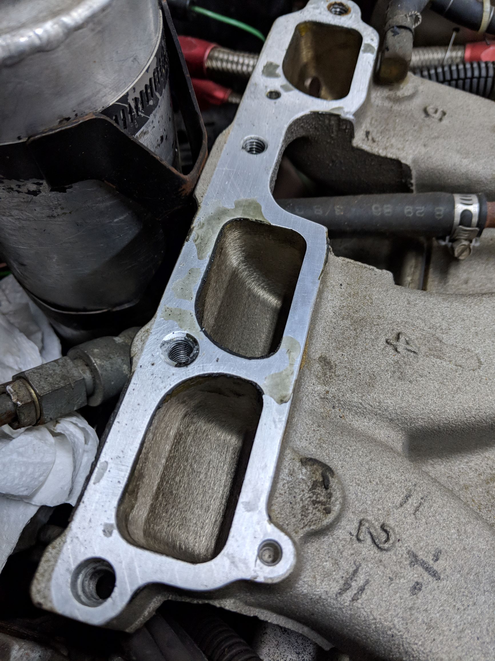

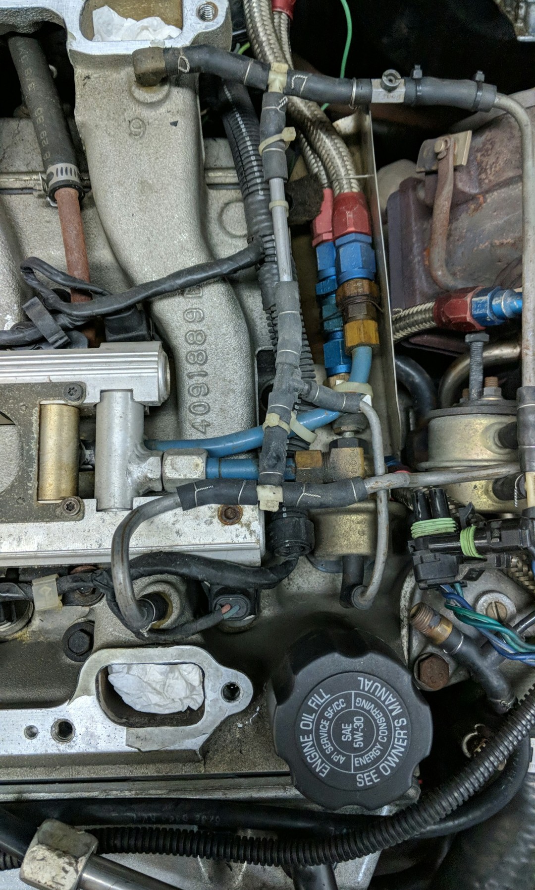

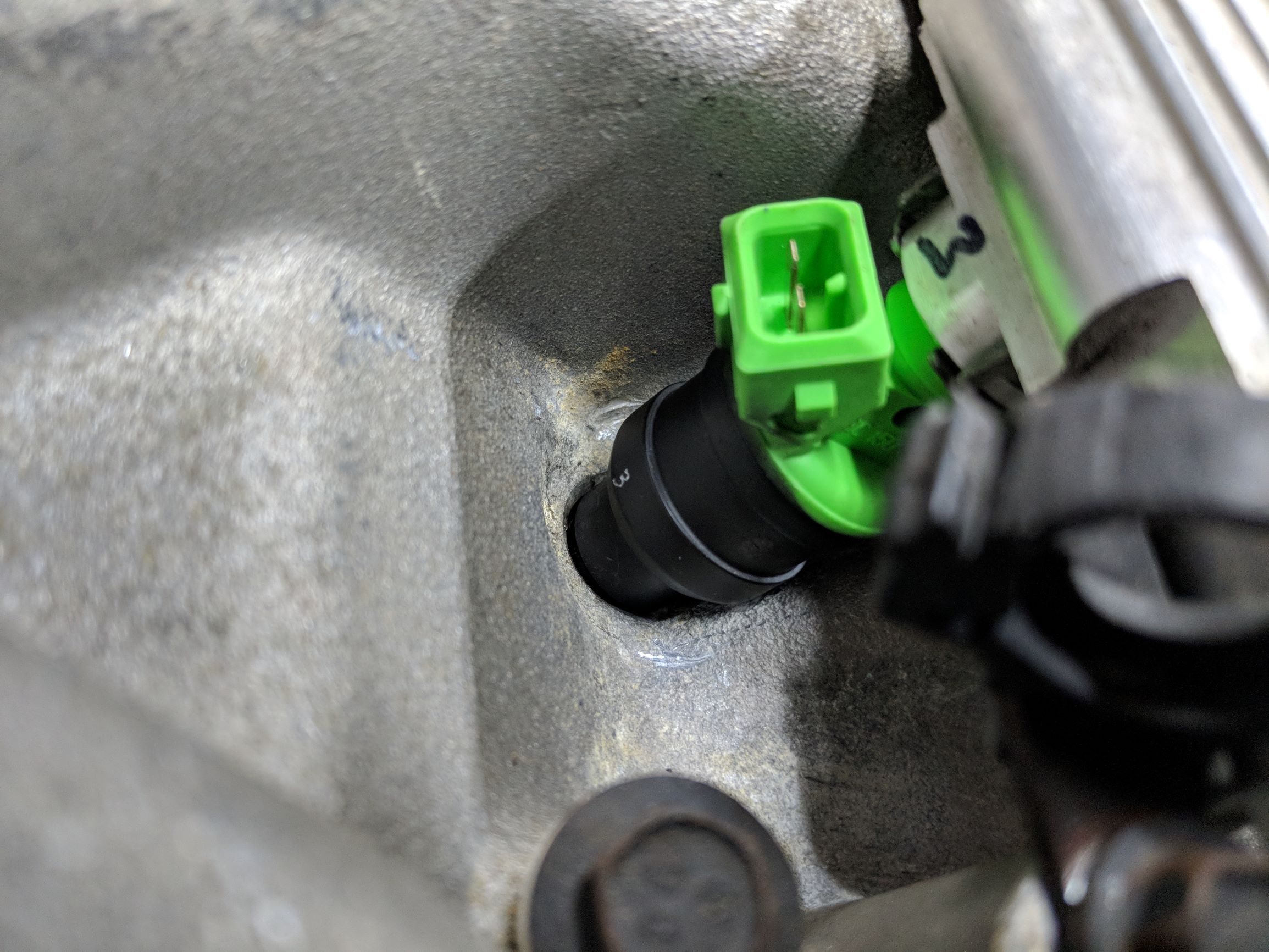

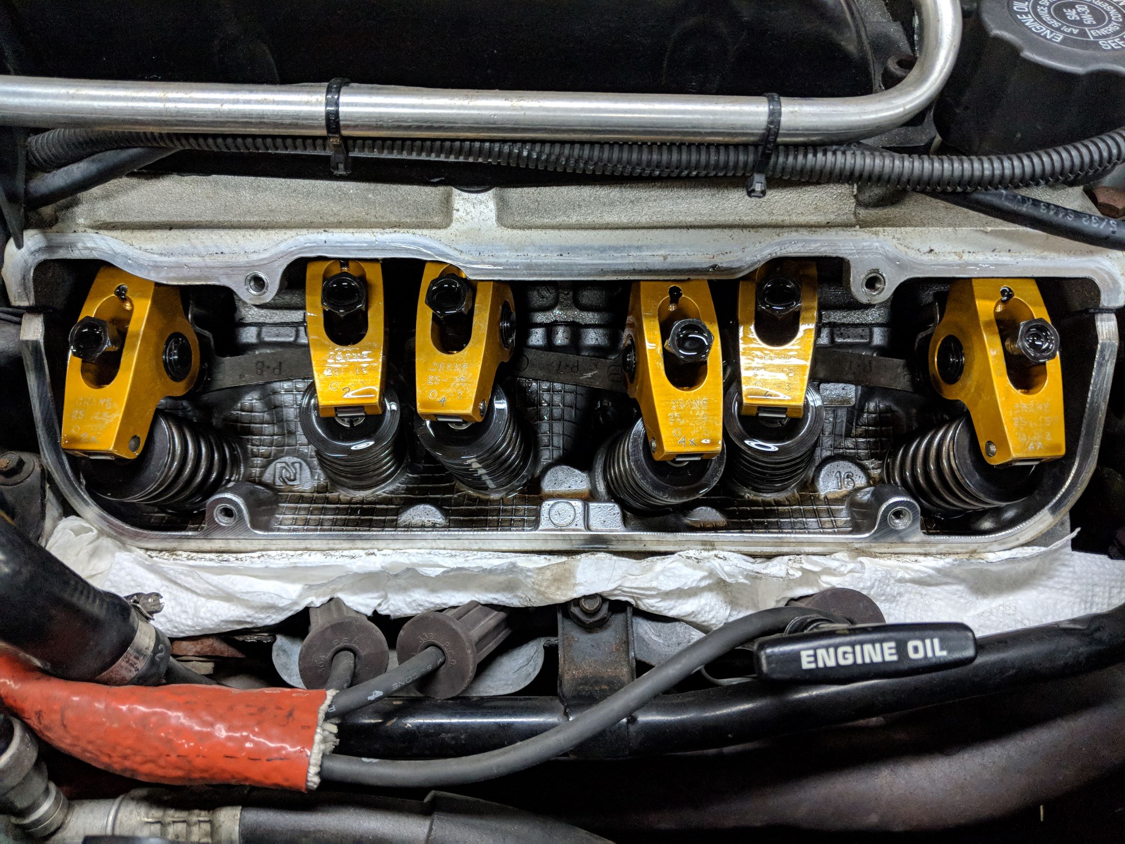

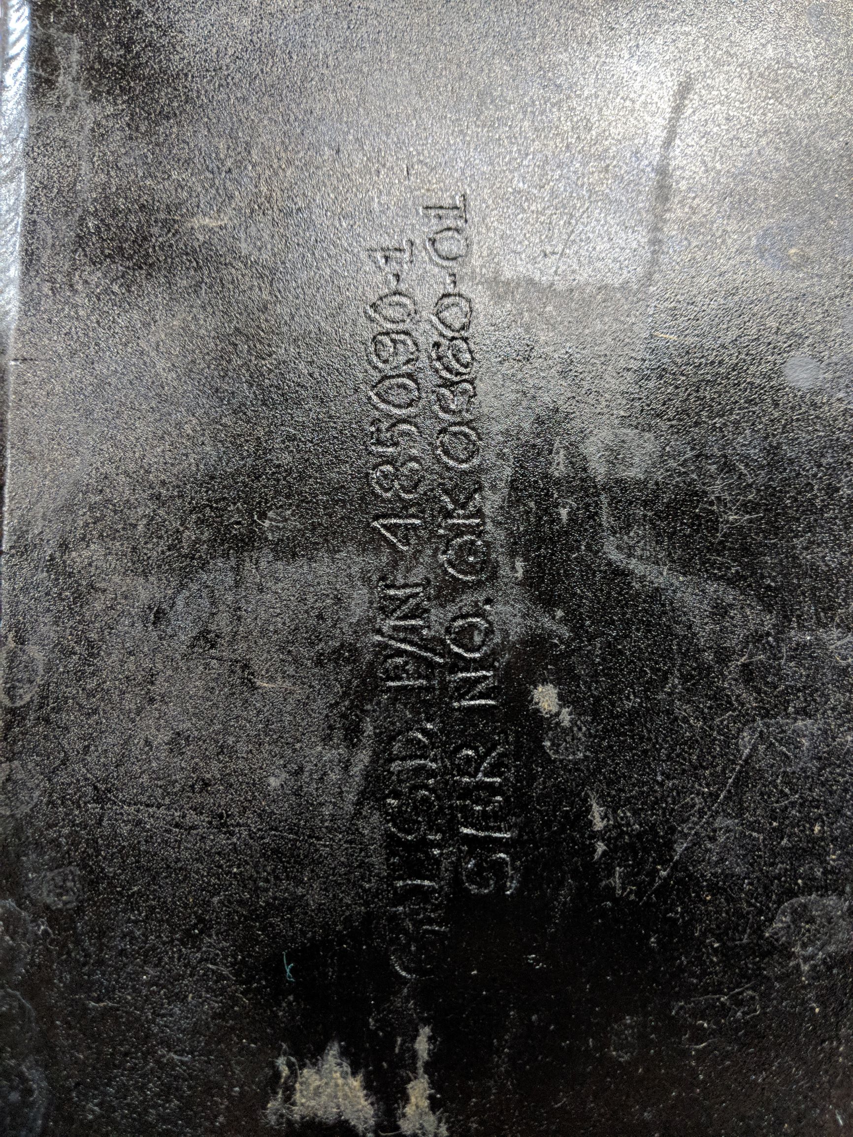

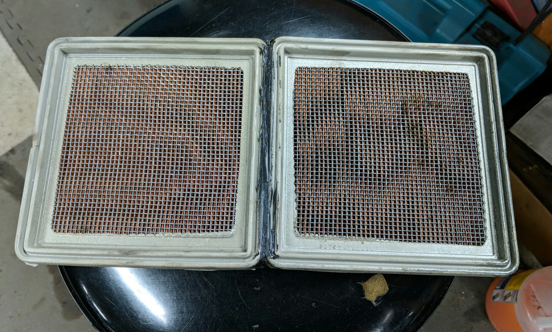

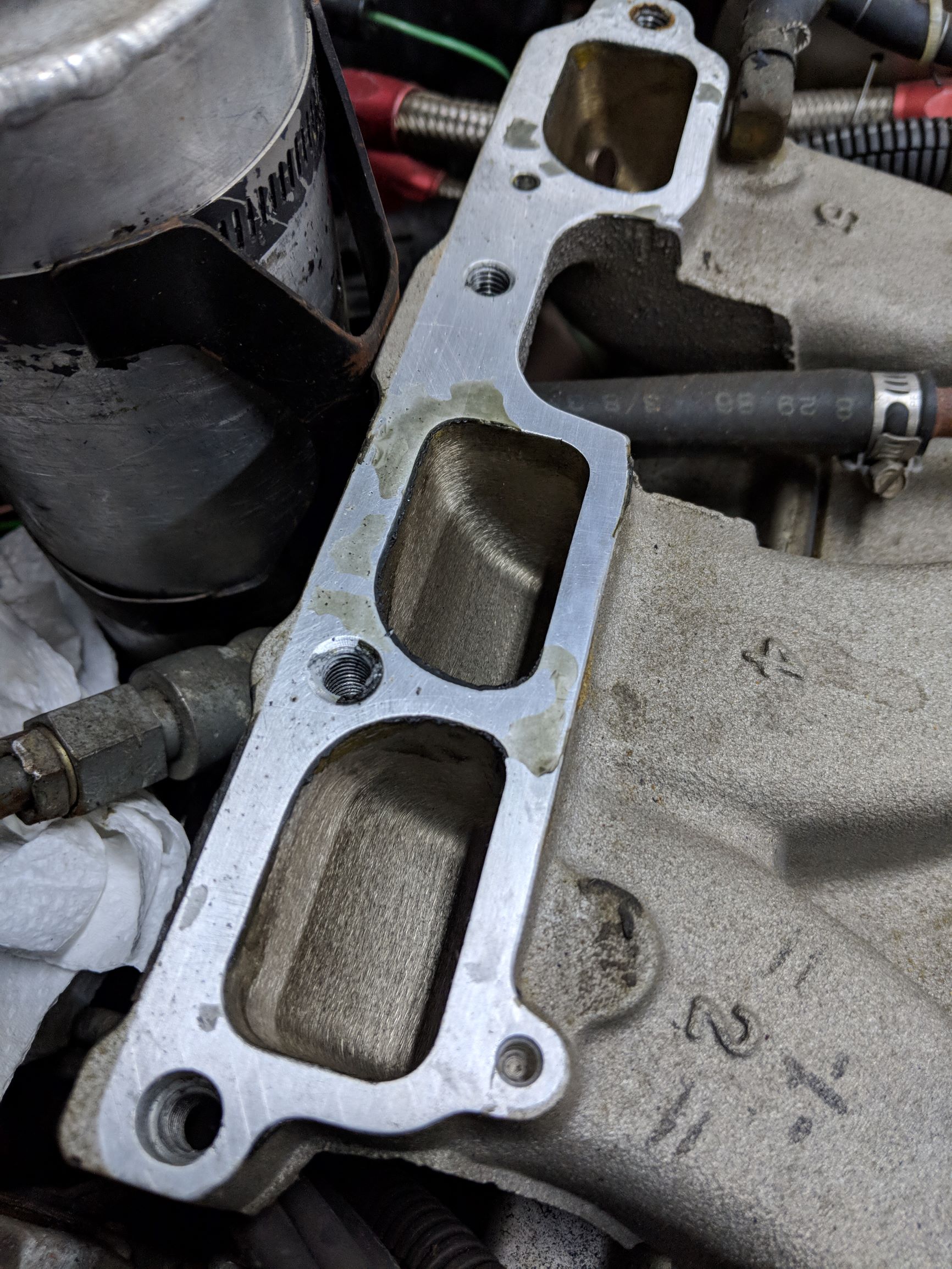

Now we get into the motor some... Fuel Injectors were junk, needed to send them out for cleaning which ended up in replacing the whole lot with a newer type of more reliable injector. 2 were dead, one open and one closed. Thankfully he was able to flow test them and figure out what they were for replacement sake. Oh and the pistons have valve relief cuts in them...

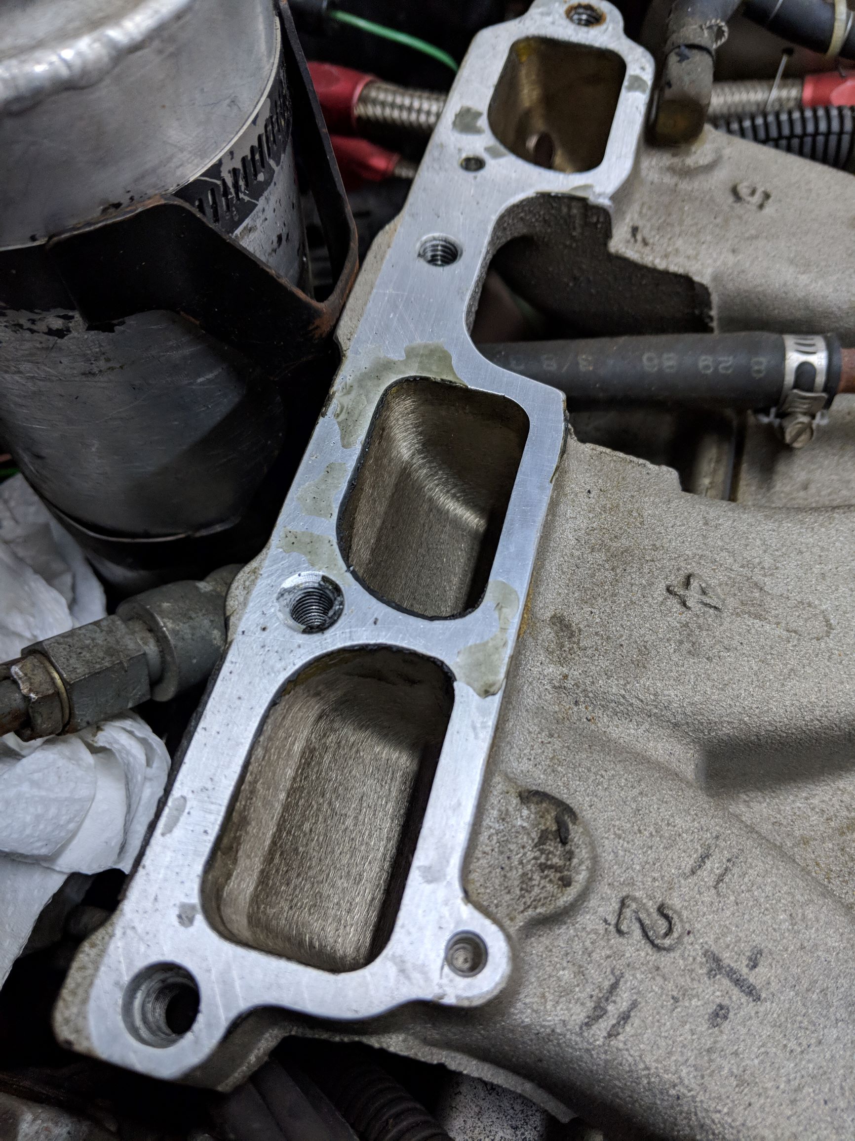

Crane gold roller rockers. Valve reliefs. Clearly some port work done to the runners... That's not stock casting. Numbers I found on the underside of the air to water intercooler. Customized fuel rail for AN lines. New Injector installed Their custom air filter location, and filter And the mess of vacuum lines under the intake. Notice the Holley jets that they used to bleed off boost for control... yikes... this will be interesting to iron out after I get the turbos refreshed.

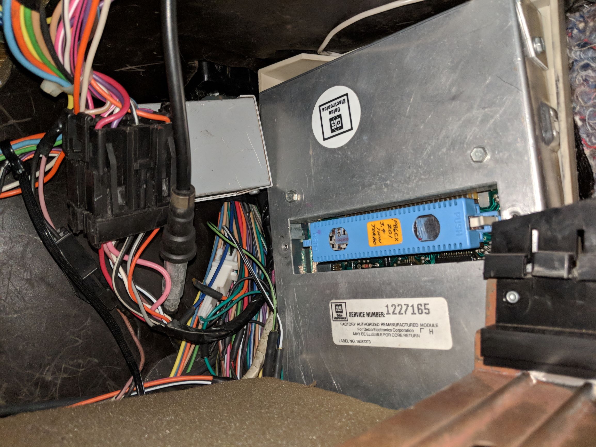

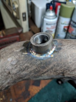

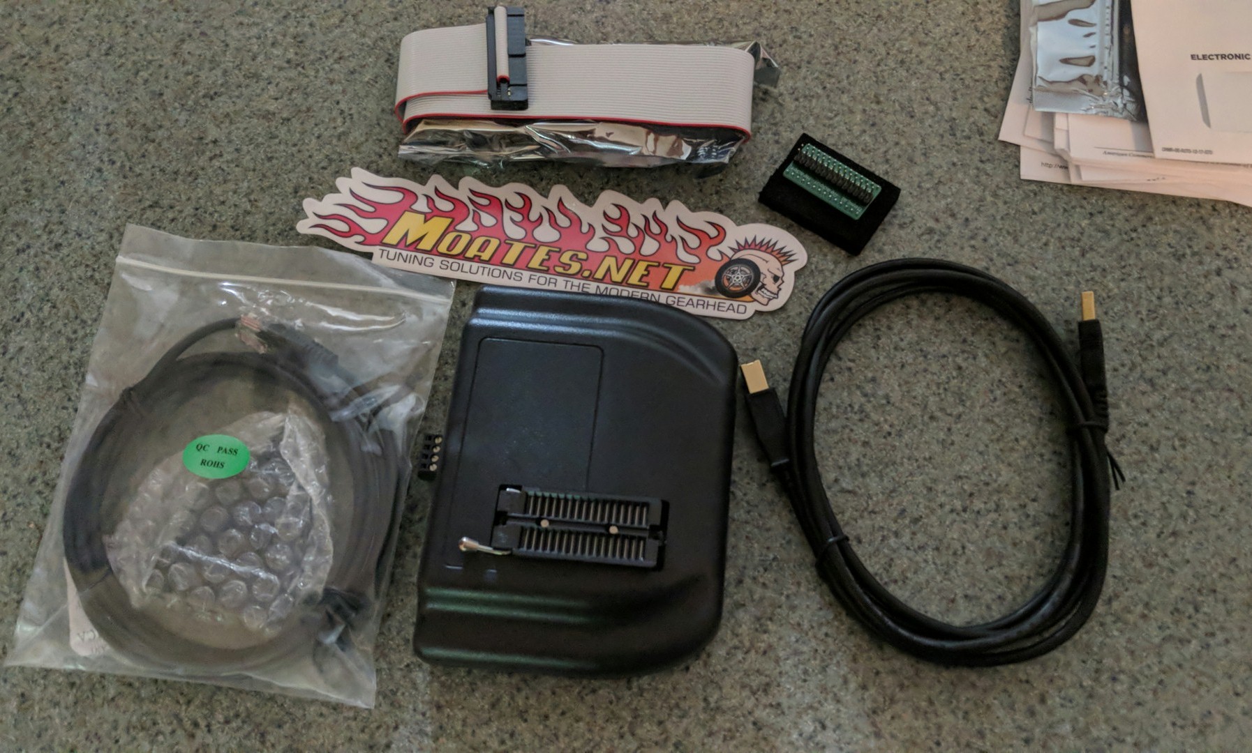

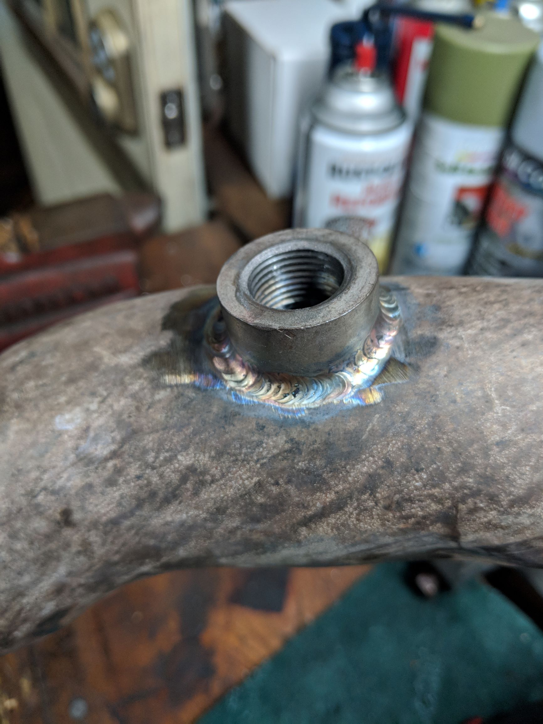

Since doing most of this work I also had to modify the tune on the ECU. I was able to use a Moats adapter to put their chip off to the side, read the details and modify the MAF tables at idle to help it run better. Something else that I noticed is this car doesn't have an O2 sensor. They had the BLM's locked and weren't even monitoring it with a wideband... that's just nuts. I installed a bung and put a wideband on it so I could see how it was running, that is how I found that idle was super rich. And with the Moates real-time adapter I was able to make changes while it was running and see it's reaction to it, vs burning chip after chip... insane how that's possible with an 88 Corvette ECU, but not OBDII yet...
Added O2 sensor bung on downpipe. Corvette Ecu Moates Hardware used.

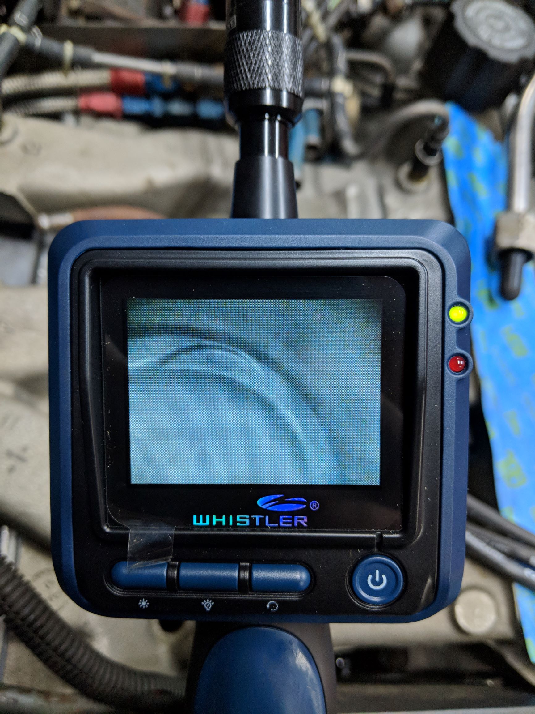

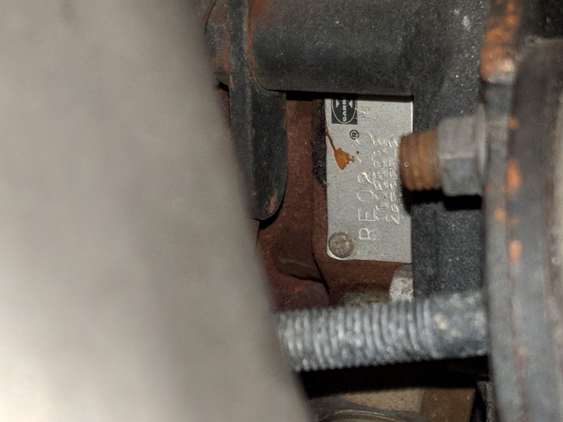

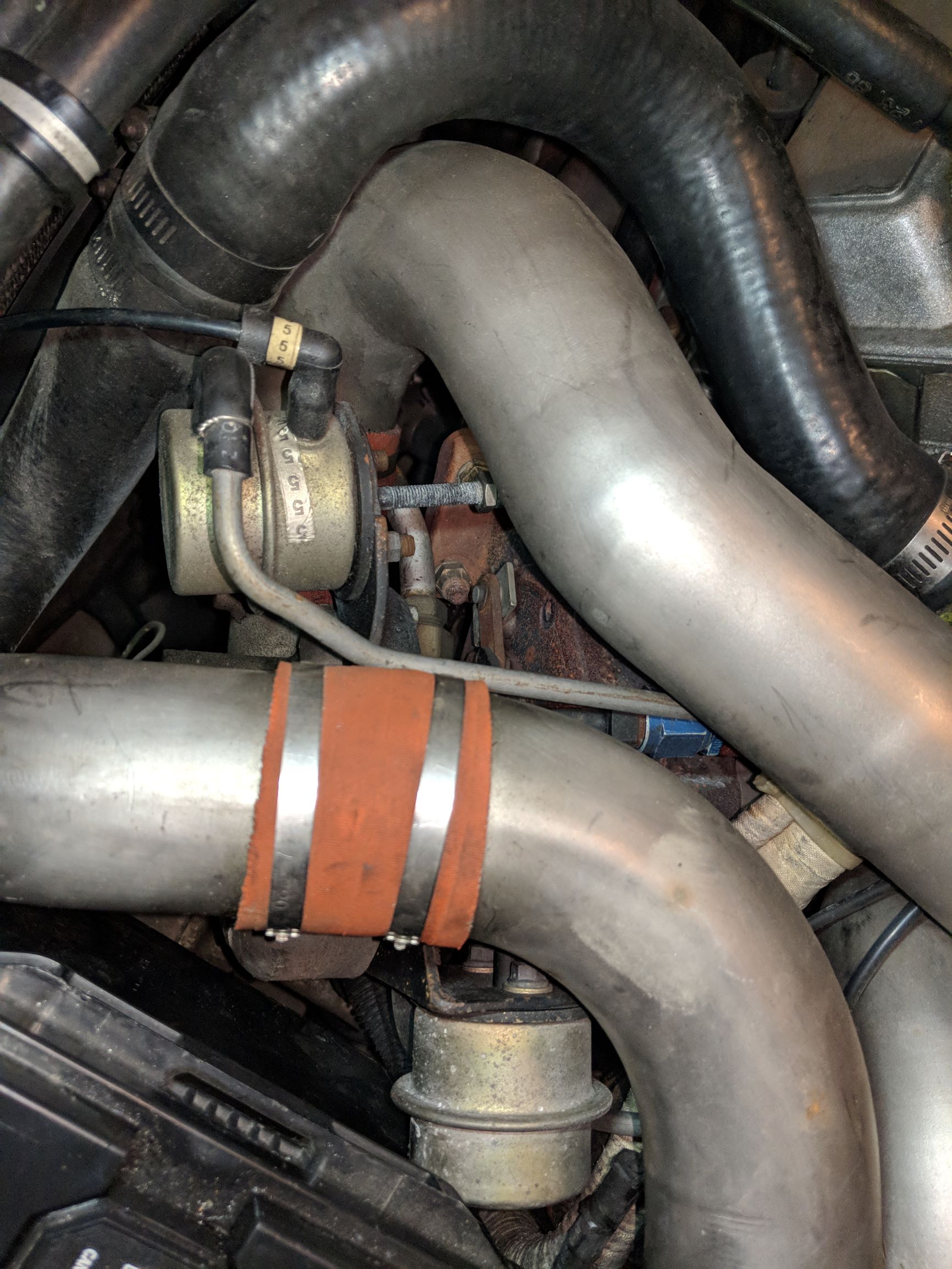

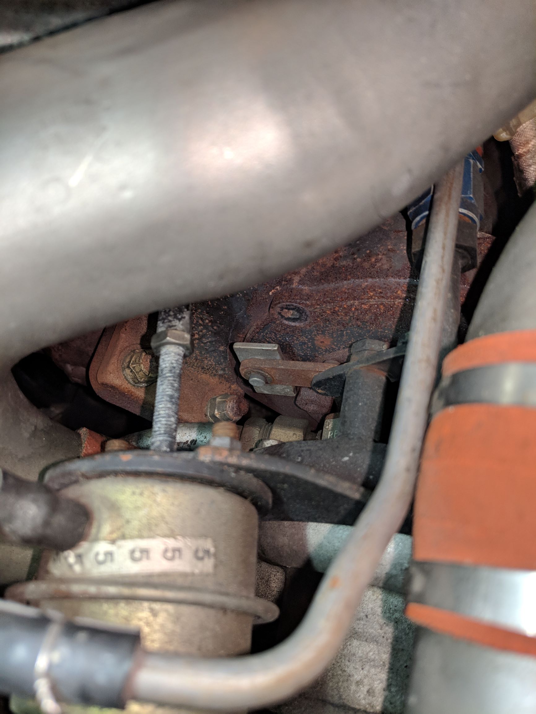

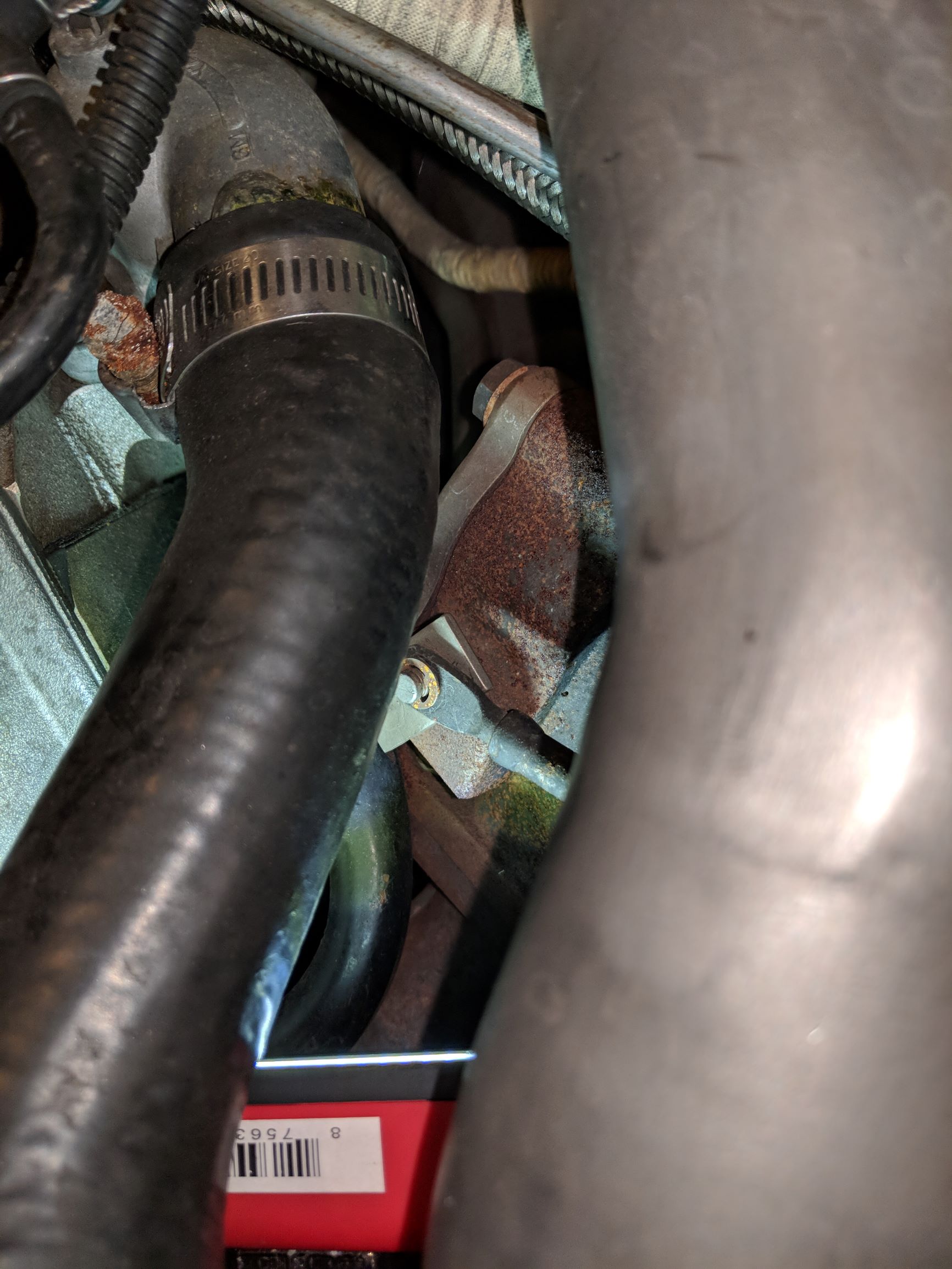

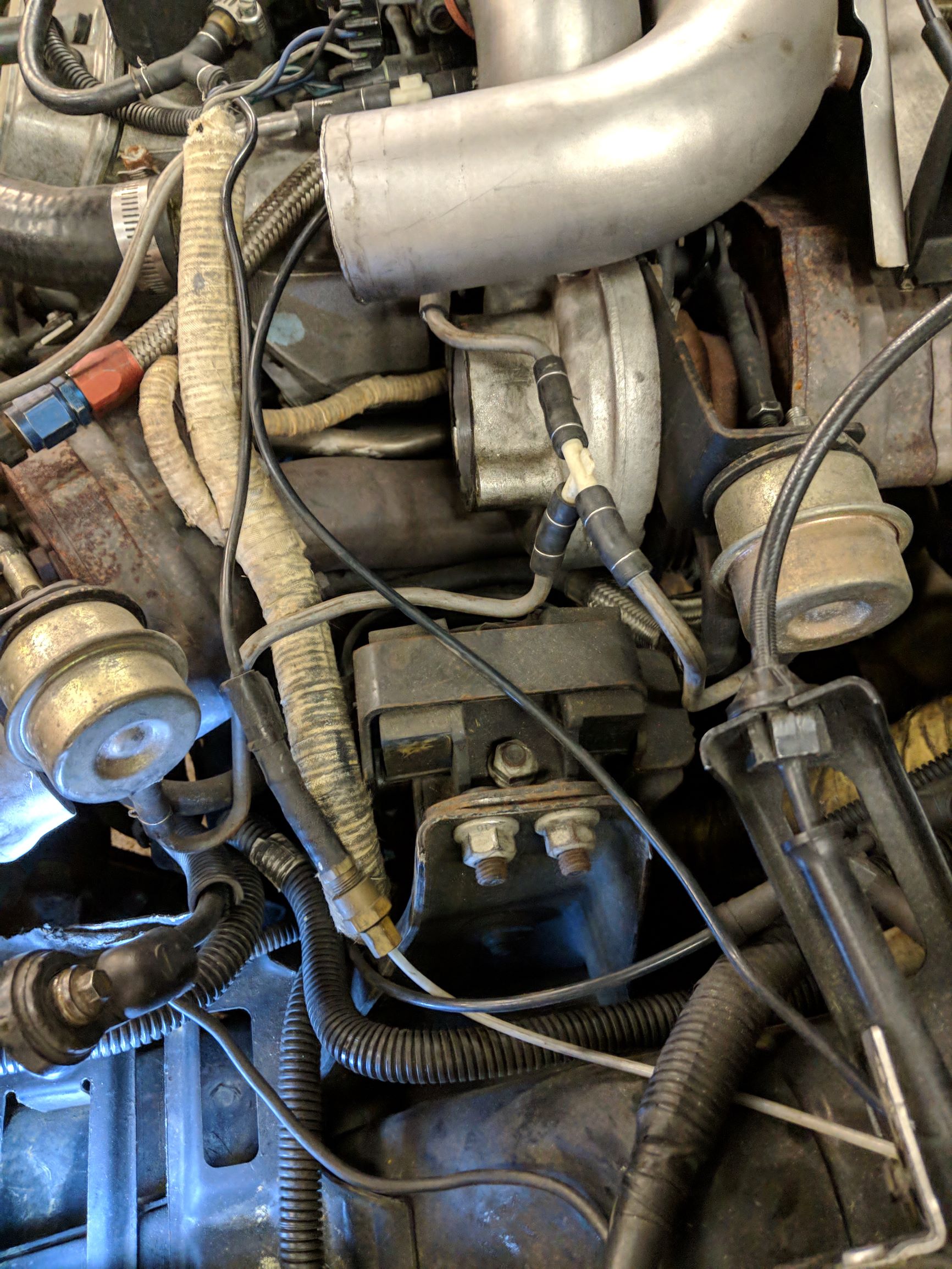

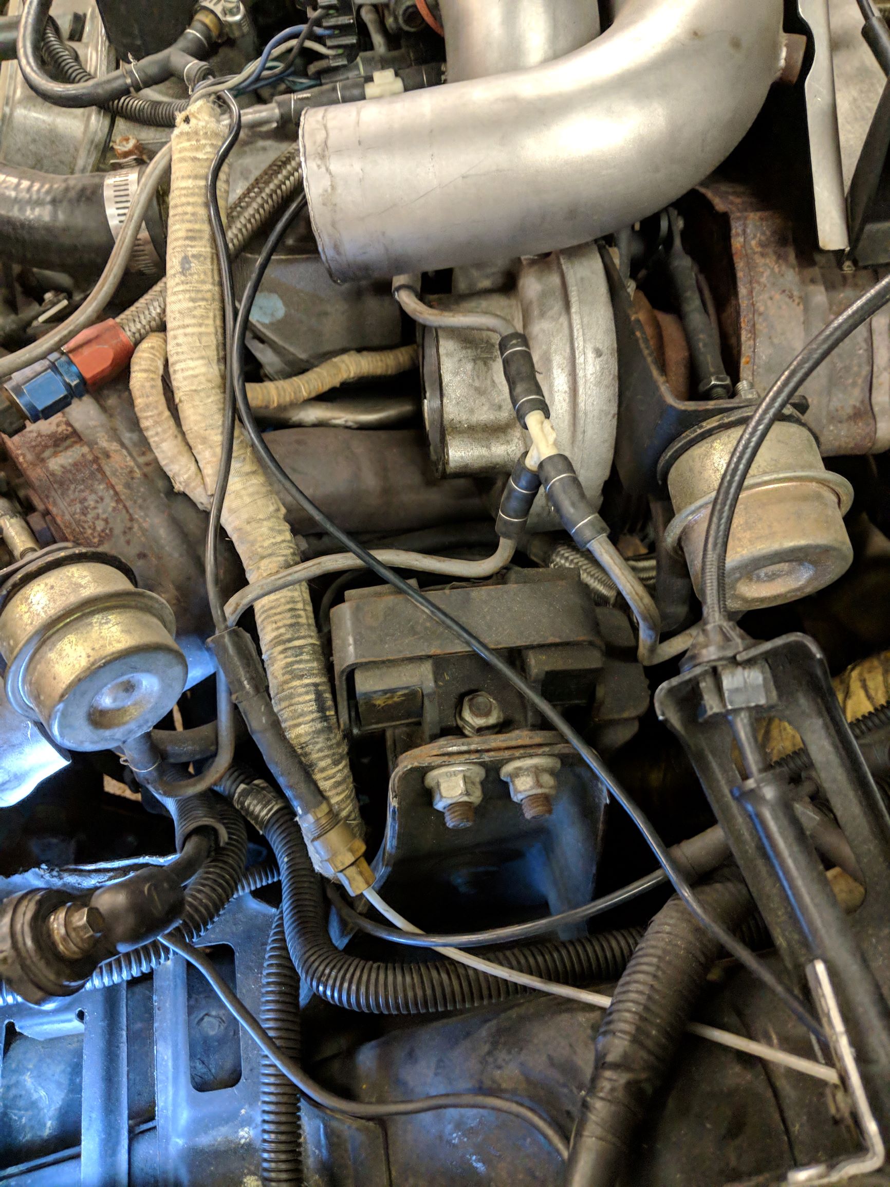

Just as a heads up, I have not "touched" the car teardown wise at all since it's been in Brooklyn. I have had way too many projects going on. The next major thing on my list is to get the fuel tank down and cleaned out, pumps checked and siphon checked since it's a saddle bag tank, unlike a factory Beretta one. I tried to pump all the gas out of it recently since it's not being used much and the gauge is registering 1/4 yet I am getting air from the pump... and you can hear it sucking down to nothing. I'm not sure if it's pulling fuel from the right side of the tank or not and I'd like to figure that system out and get it all sorted... and then it will be filled up with Sunoco GTX280 98 octane unleaded race fuel to prevent regular gas from causing issue in the future since it doesn't get driven much. It was noted to only be run on Idolene 30 at GM which is an additive free testing fuel that they use. While doing that I also need to get the turbos out to go through them. They are an interesting setup, they have both an Internal wastegate, as well as variable vane geometry on the turbine side. Sadly one of the turbos VNT systems is stuck, the actuator wont move. I'm sure it's from years of starting and moving and not letting it get up to temp. I hope it's repairable, if not Garrett will be getting a call for some custom work since they made these.... Info on VNT Turbos... https://paultan.org/2006/08/16/how-does ... etry-work/ I don't know how in the F they had these in 1988... but they did.

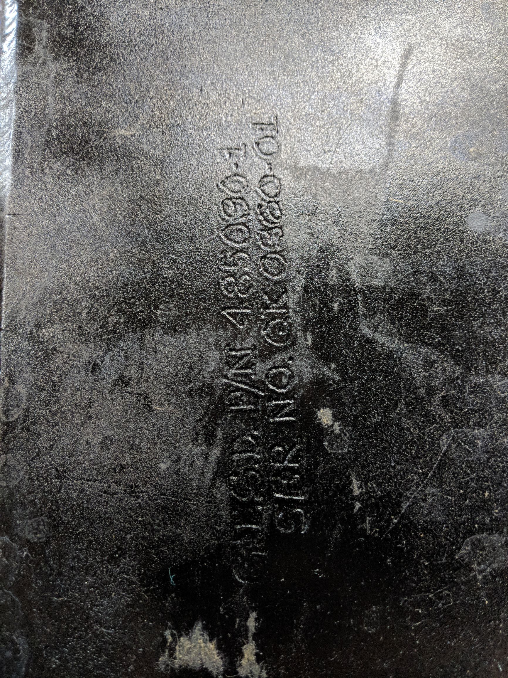

Tag on turbo CHRA Internal Waste Gate arm, Silver tab in center of photo, the diaphragm pictured is for the wastegate. VNT actuator arm. Dual vacuum diaphragms, one for vanes and other for gate.
