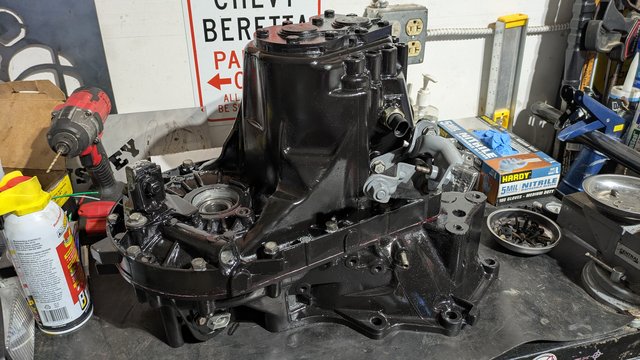

Took my junkyard 282 apart, special thanks to Eric for telling me how to separate the case!
Also a big thanks to Rex for the manual for the transmission!
https://www.mediafire.com/?y2tntusxywg& ... 5Hji6S3IRA
Someone has been in it before, I believe to change bearings, because they're all good. It did need a new detent cover, but thanks to Luke on Facebook, I was able to get a NOS one on eBay. For future reference the part number is 14082039. Whoever was in the transmission last also broke a chunk of the lip for the detent cover off, so I'll just be fixing that with some JB Weld Steel Weld.
It's all apart otherwise! I have some Permatex Gear Oil RTV I'll be sealing the case back together with before I get it all painted up. I'm also putting a new speed sensor on, I can't believe they're still available online. $42 for a Delphi on eBay.
Oh yeah, it is the 3.61 gears, so that'll be fantastic with the 3500!

You actually want anaerobic sealer, not RTV. It's a clear-red sealant...also available from permatex. I don't know why RTV is a no-no, but I've gotten that from reliable sources. Anaerobic sealer is spec right in the GM manual.

Thanks man! It's easy enough for me to find!
woody90gtz wrote: Mon Nov 18, 2024 9:41 pm You actually want anaerobic sealer, not RTV. It's a clear-red sealant...also available from permatex. I don't know why RTV is a no-no, but I've gotten that from reliable sources. Anaerobic sealer is spec right in the GM manual.

Just got some Loctite anaerobic sealant, fixed the broken lip where the detent cover goes with some JB steel weld, and started cleaning up the mounting surfaces today!
I also got my new speed sensor and connector from Rockauto, along with finding the new axles for the 5 speed swap on closeout for $30 a piece, along with an A/C kit that includes the accumulator and expansion valve for $108 on closeout as well!
Slowly piecing this turd together!

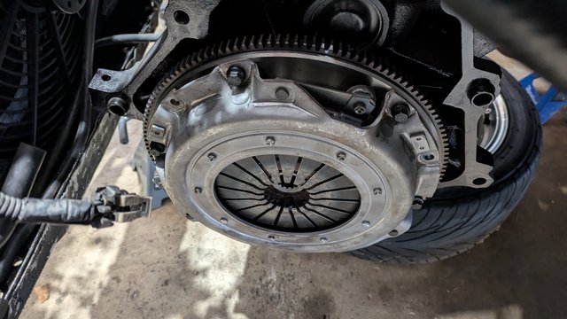

Trans is together finally together, now I'm enjoying the fun process of identifying all of my harnesses that I didn't label so I can modify the harness for the swap. I did get my OEM Exedy clutch installed today too! Quick photo of the car in its current state too... 🤣

OEM clutches drive so smooth. I think that's a good choice on your part. Some aftermarket clutches can be grabby or chattery.

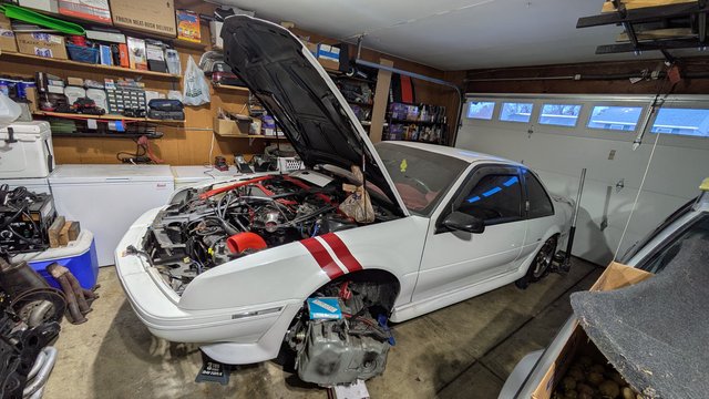

Transmission is in, motor is lined up with the new top mount as well, and 90% of the wiring is ready!
No trans mounts yet, but it is at least bolted up to the engine.

The ol' "Mr. Mike" mount with the zipties and strut bar. haha
Now just see if you can fab something up. Might even be able to use the 4t60 mount holes like I did.
