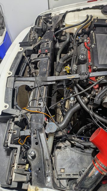

Trans is together finally together, now I'm enjoying the fun process of identifying all of my harnesses that I didn't label so I can modify the harness for the swap. I did get my OEM Exedy clutch installed today too! Quick photo of the car in its current state too...

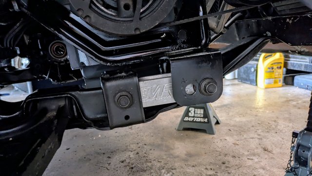

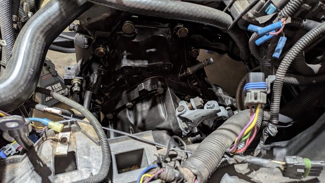

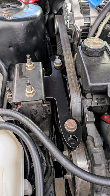

Transmission is in, motor is lined up with the new top mount as well, and 90% of the wiring is ready!
No trans mounts yet, but it is at least bolted up to the engine.
- Posts: 4747
Re: The Derretta, 1994 base with some attitude.
The ol' "Mr. Mike" mount with the zipties and strut bar. haha
Now just see if you can fab something up. Might even be able to use the 4t60 mount holes like I did.
