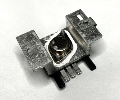

Thanks for the information,got lucky and find at web market place another dash(hope it's ok...).But there is also another problem with dash,when driving lights are put on,dash go black.I looked at wiring diagrams that there is one transistor(remote dimmer) after dimmer switch,and electronic cluster relay which choose lights power source to cluster.Can you say locations of remote dimmer transistor and cluster relay?
Posts: 1858
Re: -89 GTU digital dash
The component is under the dash, to the left (IIRC) of the steering-column.

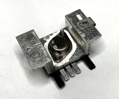

Not too hard to access either. My '90 Yellow Indy had this part fail several year ago, the previous owner bypassed it and the dash lights came on full-bright with the ignition-switch, not great for night-time driving. Luckily, I had a spare...
Part looks something like this... Common on a LOT of GM cars of the day.
