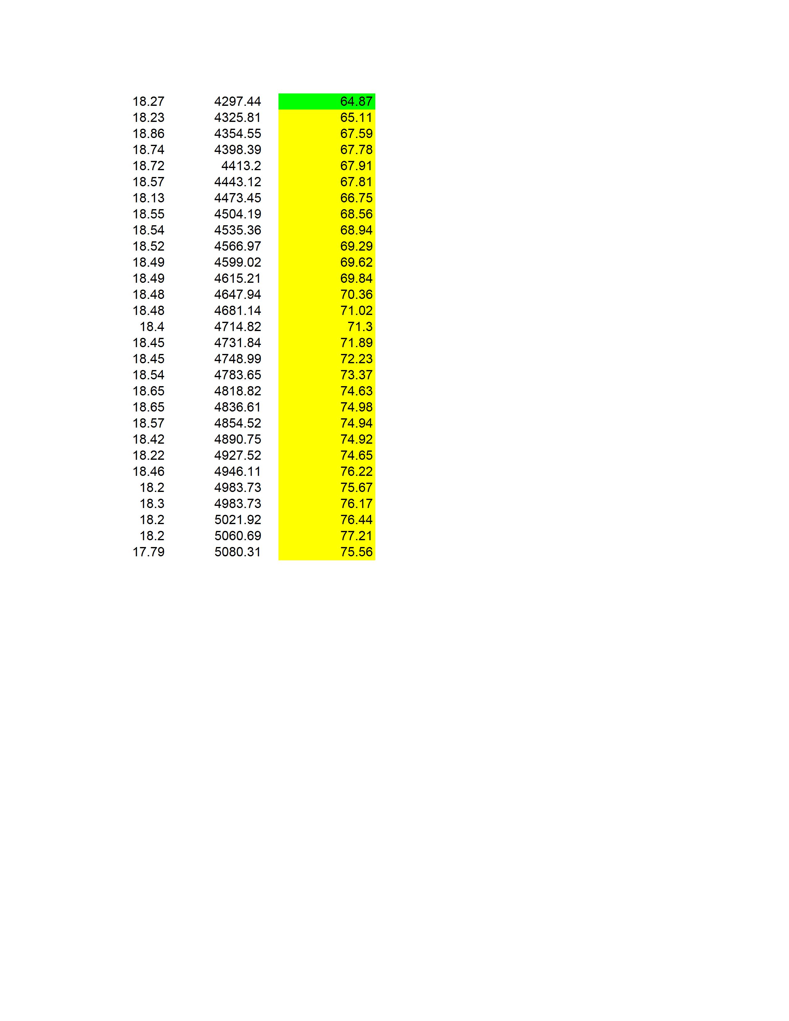

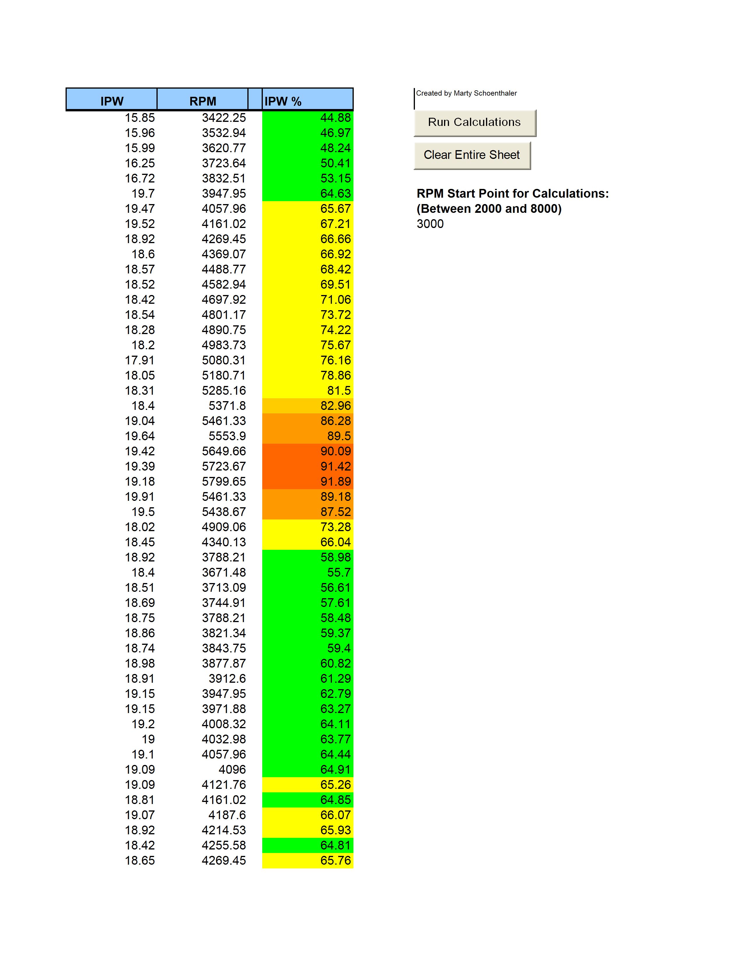

Ouch, 92% duty cycle!! My poor injectors!! LOL
The more I think about it, it may indeed be lack of fuel that is causing the lack of "punch". Somewhere in between perfect and a hesitation ya know? I do plan someday on going to OBDI and tuning, but that may have to come sooner...
I wonder if the new style FPR would be enough to keep the duty cycle safe? I still would need to tune of course. The car feels like it drops off at the upper RPMs instead of feeling like it's gaining more and more. So it probably is lack of fuel. Plus it pulls to the left like crazy since the trans mount is sagging so bad, which probably creates a lack of bite and punch... Hopefully I can make it to the dealer before 5:30.. I doubt I can even walk to my car and get out of the lot before then though.
