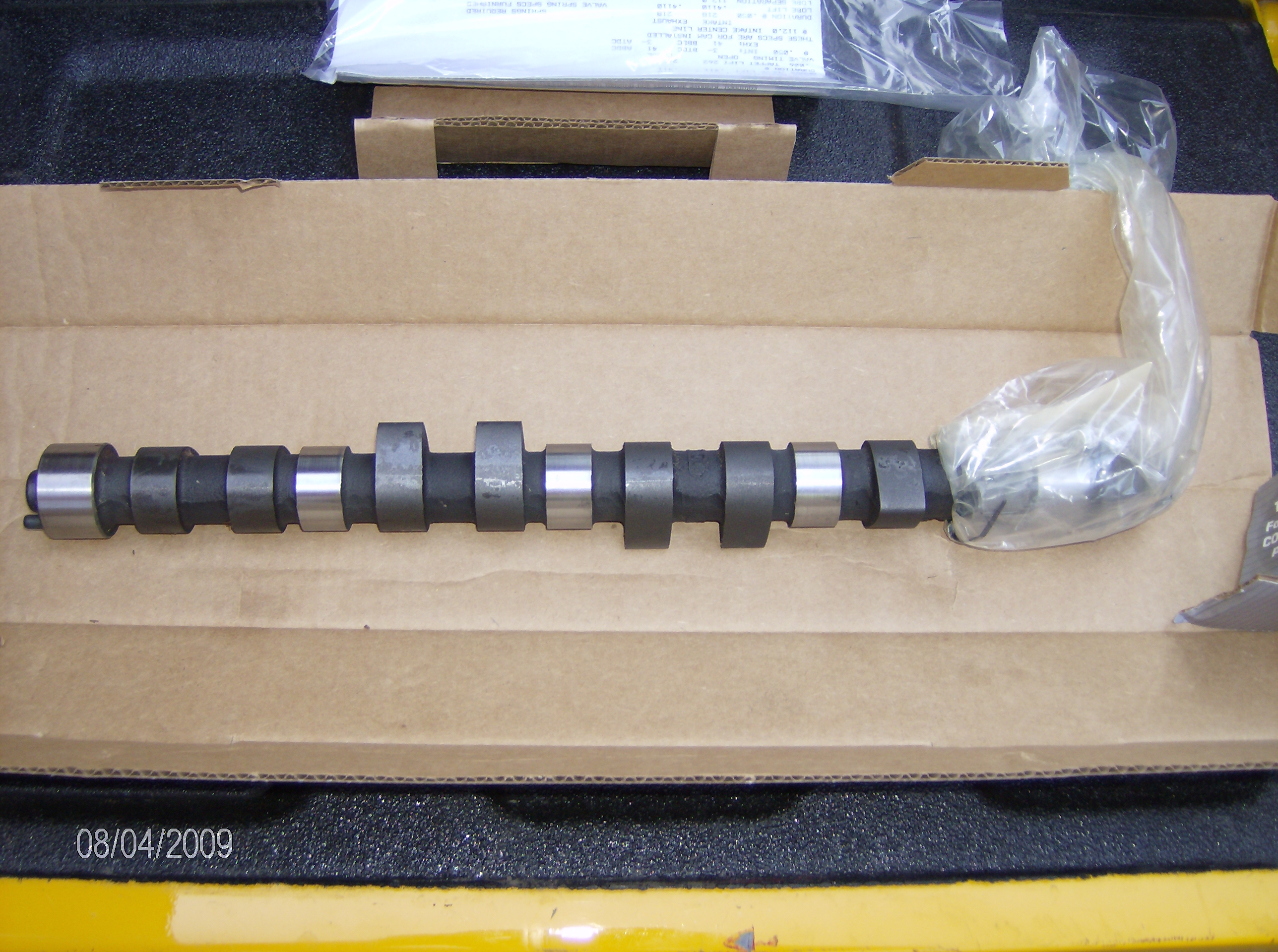

2009, the installation of newly grinded W 41 cams
intake cam exhaust cam extrude and honed intake log

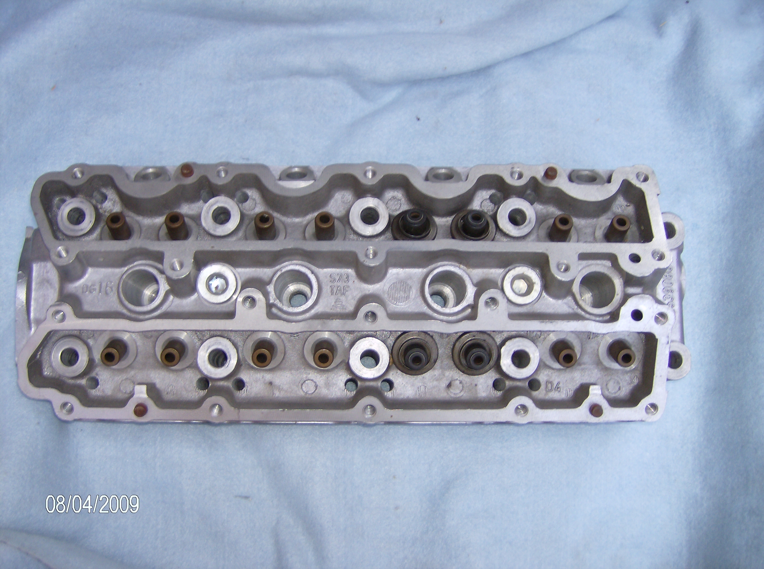

august 2009 w 41 cam swap build up.
ported and polished headcompression test
