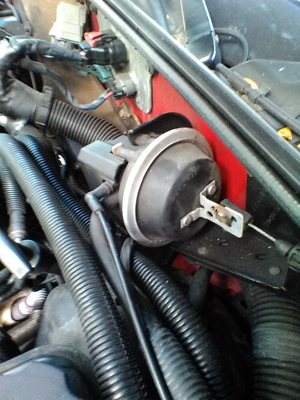

Another problem I see is my car idles around 1000. When in in gear and stop and let my foot off the gas my car slowly accelerates to 10 mph, could this be the diagram inside this

Wept narrowed it down.. Not the cruise.. Back to start ur saying 3x it has to be either the tps or iac.
- Posts: 10912
Re: 94 3100 gas problems
Idle issue could also be related to the O2 being bad... Until you get the mixture sorted out I wouldn't go after anything else, it could just be a result of it running that way.

O2 will be changed soon. I'll update my progress as I go along. Thank you for your help!
