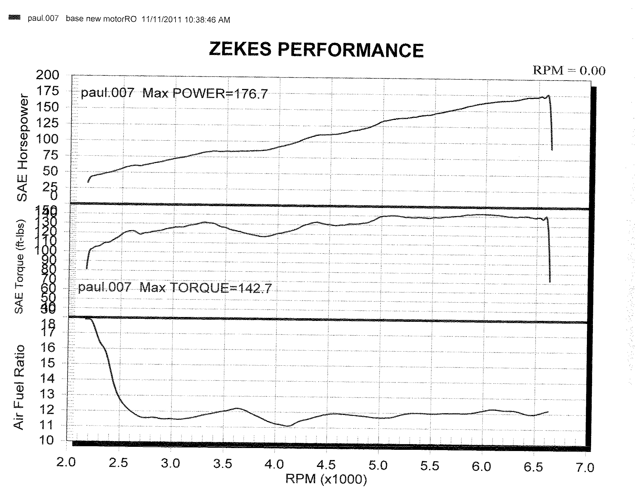

long over due update:
@ Bfest NE, little Jon adjusted my TB, it was a set screw that was causing the TB from closing all the way. Engine (idle) runs a lot better.

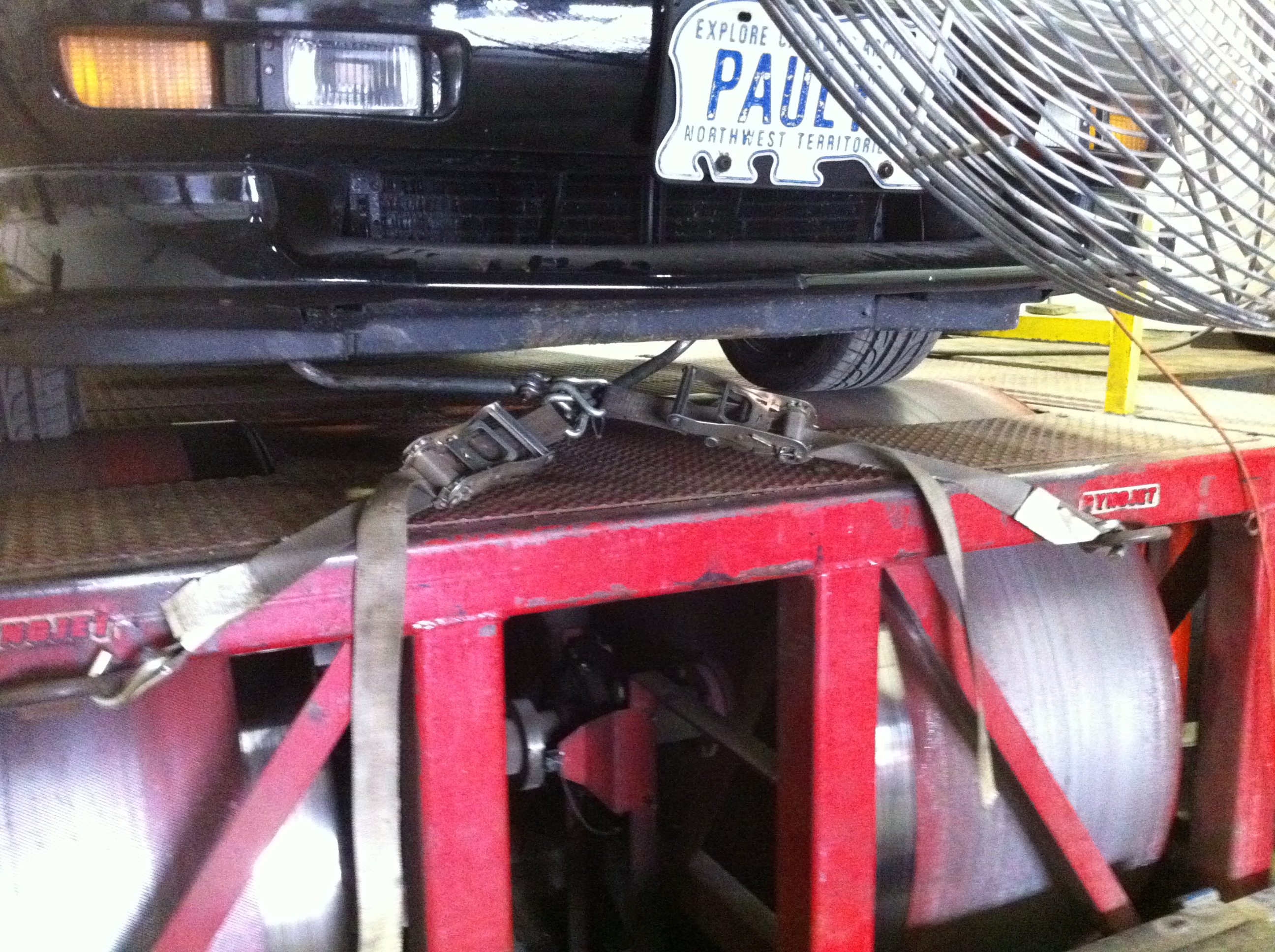

did another Dyno, 176.7 HP @ 6700rpm, 142.7 torque
This week coming up i will receive yet another custom chip from Jeff council. Dyno to come...

It'd be nice to see W41 CHP numbers at the wheels on your next dyno! If you come to Bfest next year, can I get a ride? :D
Re: Pauly's 90 GTZ rebuild.
Which year W41 though? he's only 9hp off of 93... 14hp from the 91-92 numbers...
It's a fun car, I took it for a drive with Paul after we fixed the TB set screw.
It's kinda funny, everyone wants W41 stuff and its really only worth 10hp. I honestly thought it was more than that.

3X00-Modified wrote:Which year W41 though? he's only 9hp off of 93... 14hp from the 91-92 numbers...
Haha, 91-92 W41 obviously! More power!!! UGH UGH UGH! 93 W41's lost 5hp due to having a lower flowing cylinder head. His car has the better flowing one! ;) I know W41 cams/chip only add 10hp, but when combined with a header, and full exhaust it really wakes the car up! Plus a bit of a lopy idle just sounds cool! lol

scd88ga wrote:It'd be nice to see W41 CHP numbers at the wheels on your next dyno! If you come to Bfest next year, can I get a ride? :D
when i show up, ask me then..
paul
SuzukiGhostRider
Posts: 2464
Location: Milan NM
Post by SuzukiGhostRider »
Are those WHP number or CHP numbers? I would assume WHP but just wondering?
Small correction to a previous statement. W41 CAMS only make 10hp extra. As stated when combined with better springs, a header, an 086 head (vs a 753 head the W41 SCX's came with) and maybe a light port'n'polish,a tune,etc. it can add up to 40hp+ if you know what you're doing. And that's just TOP END work...

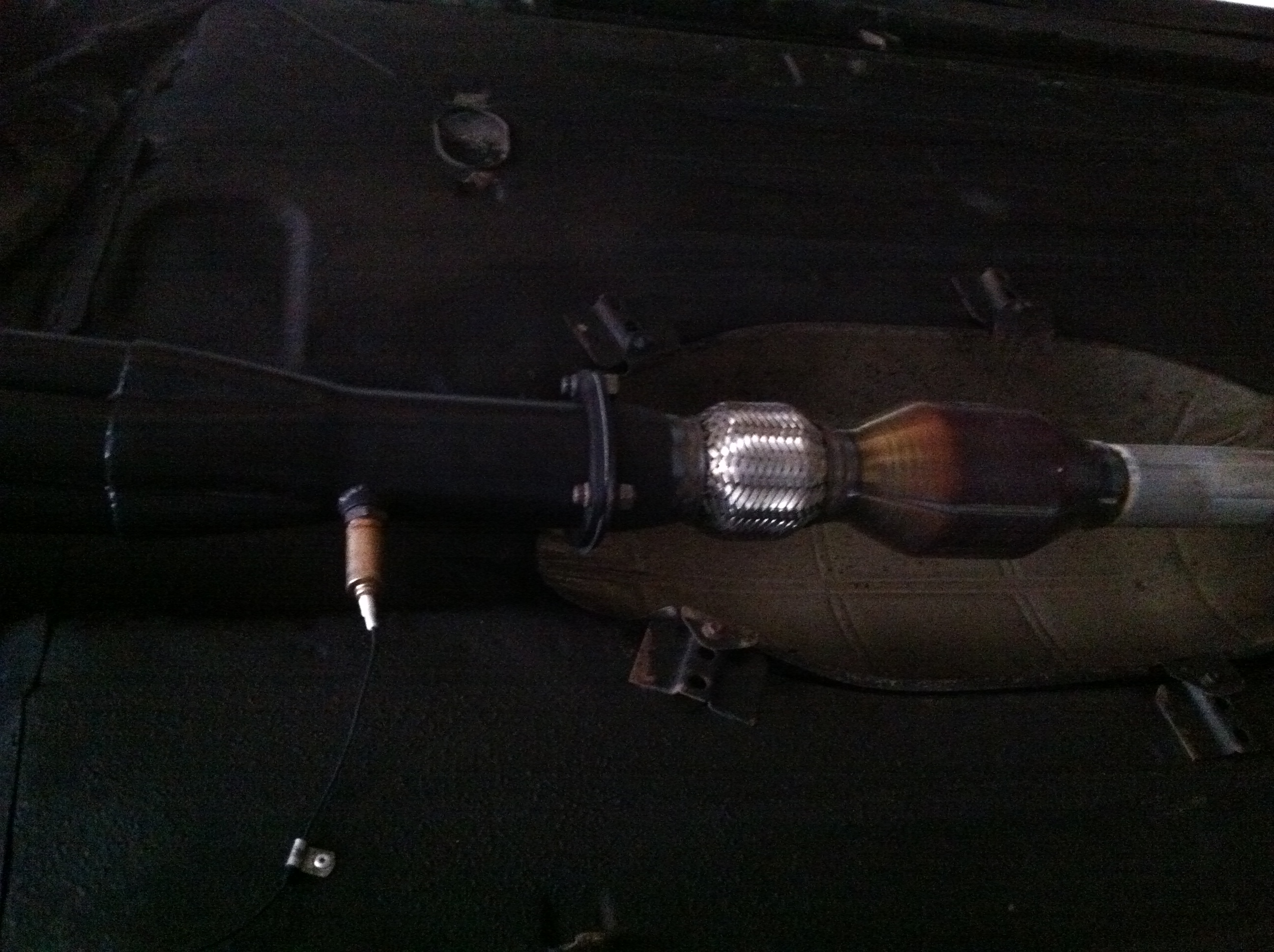

I had my calipers powder coated. They will be on the car by friday.
Imagerear
Imagerear
Imagefront
Imagefront
Imagefront

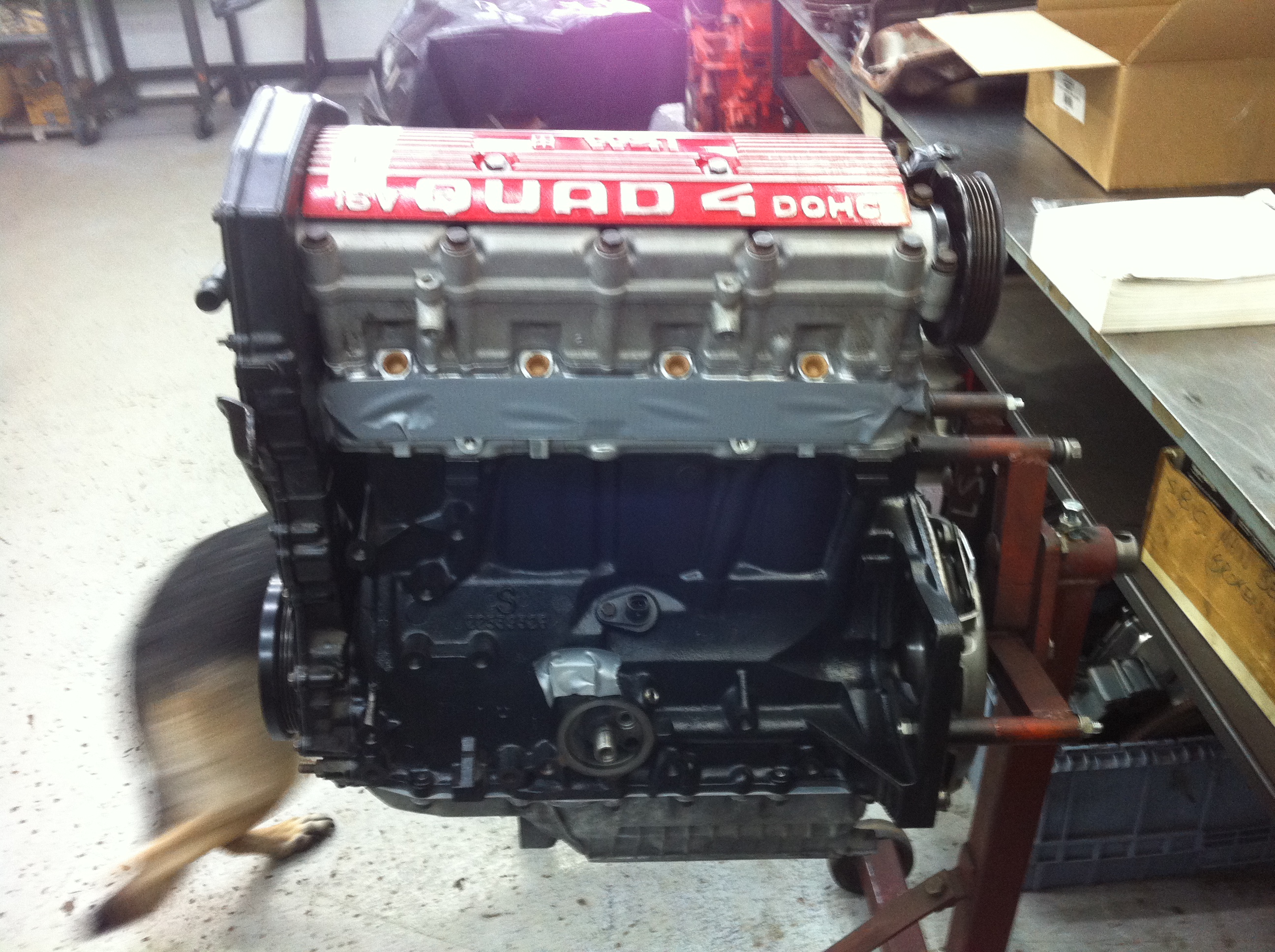

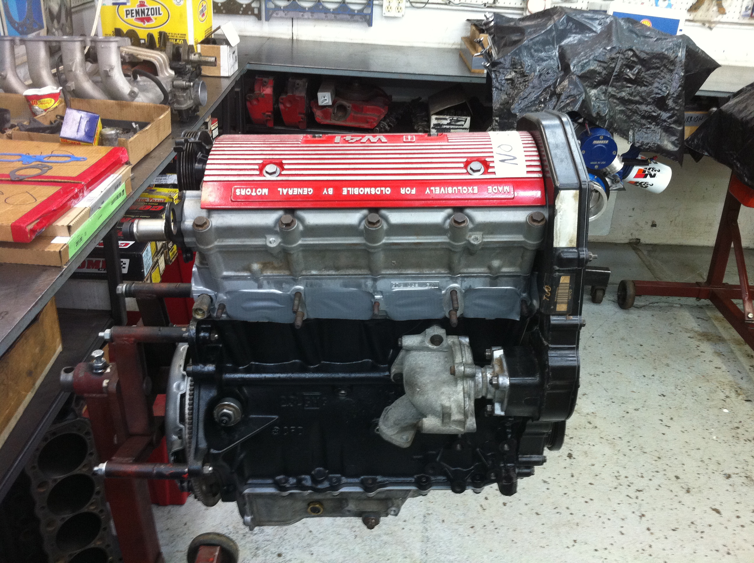

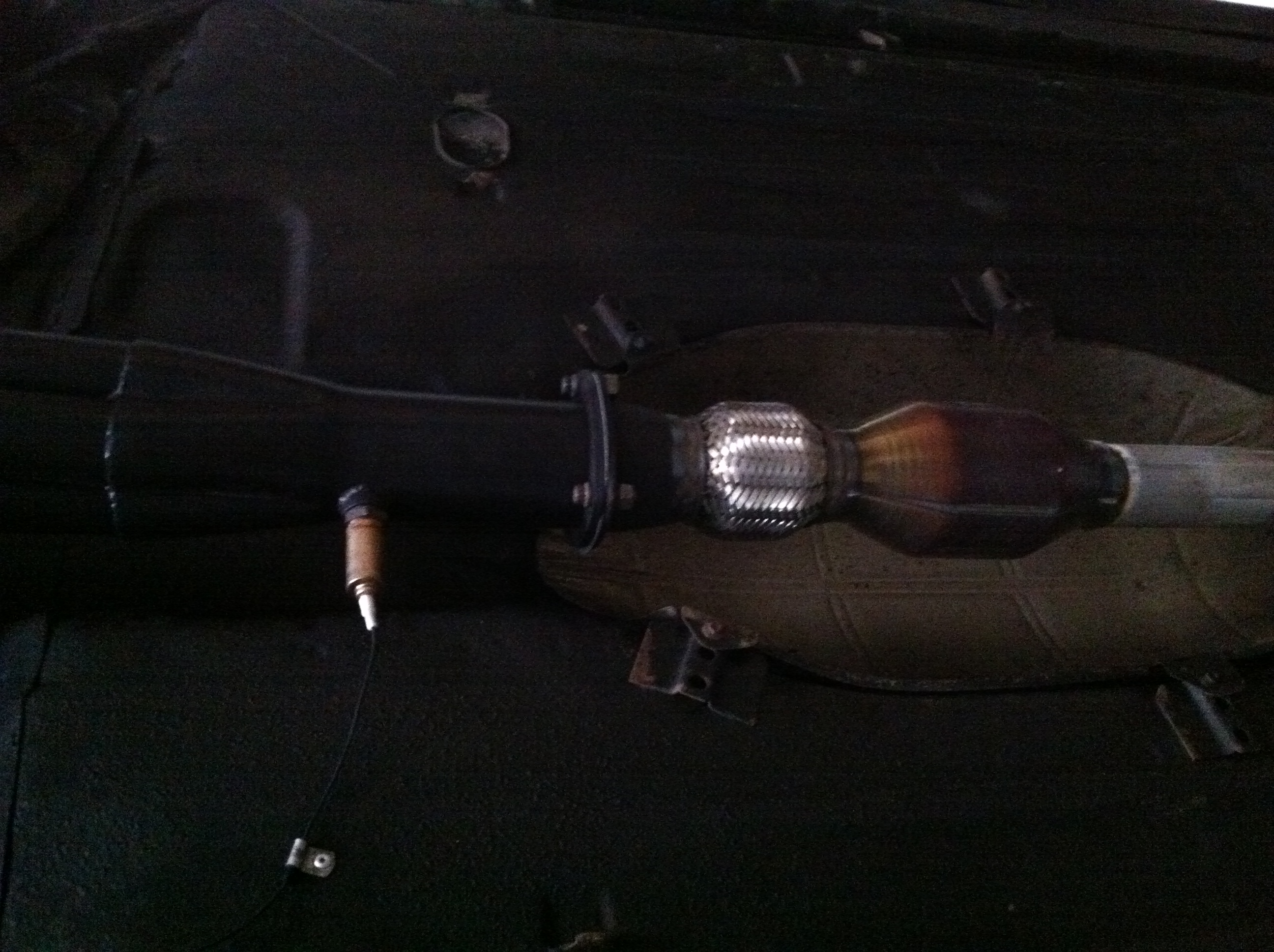

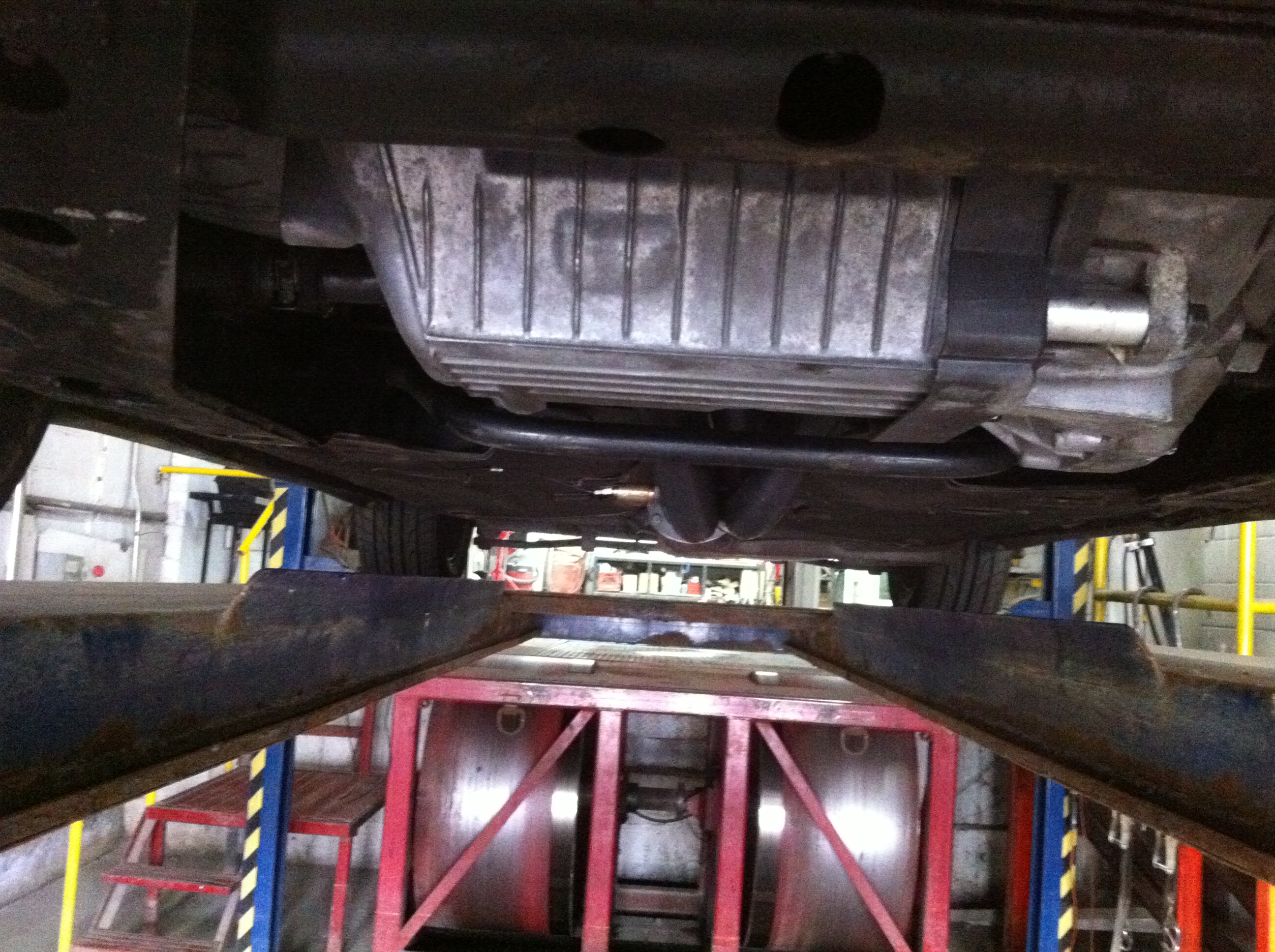

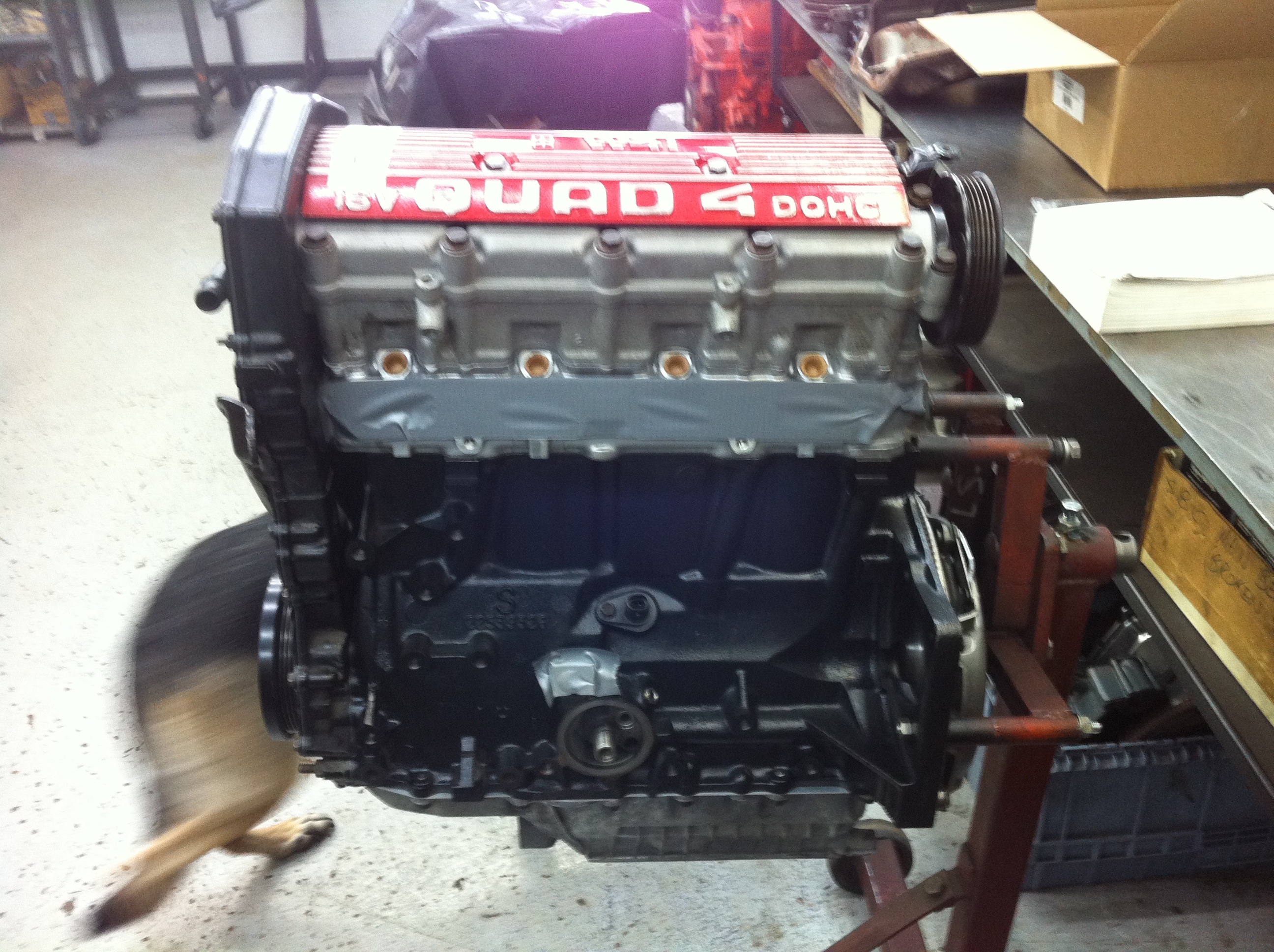

old pics from the big rebuild of march-june 2011
my pretty engine
dawg with an ass photo bomb
free flowing cat

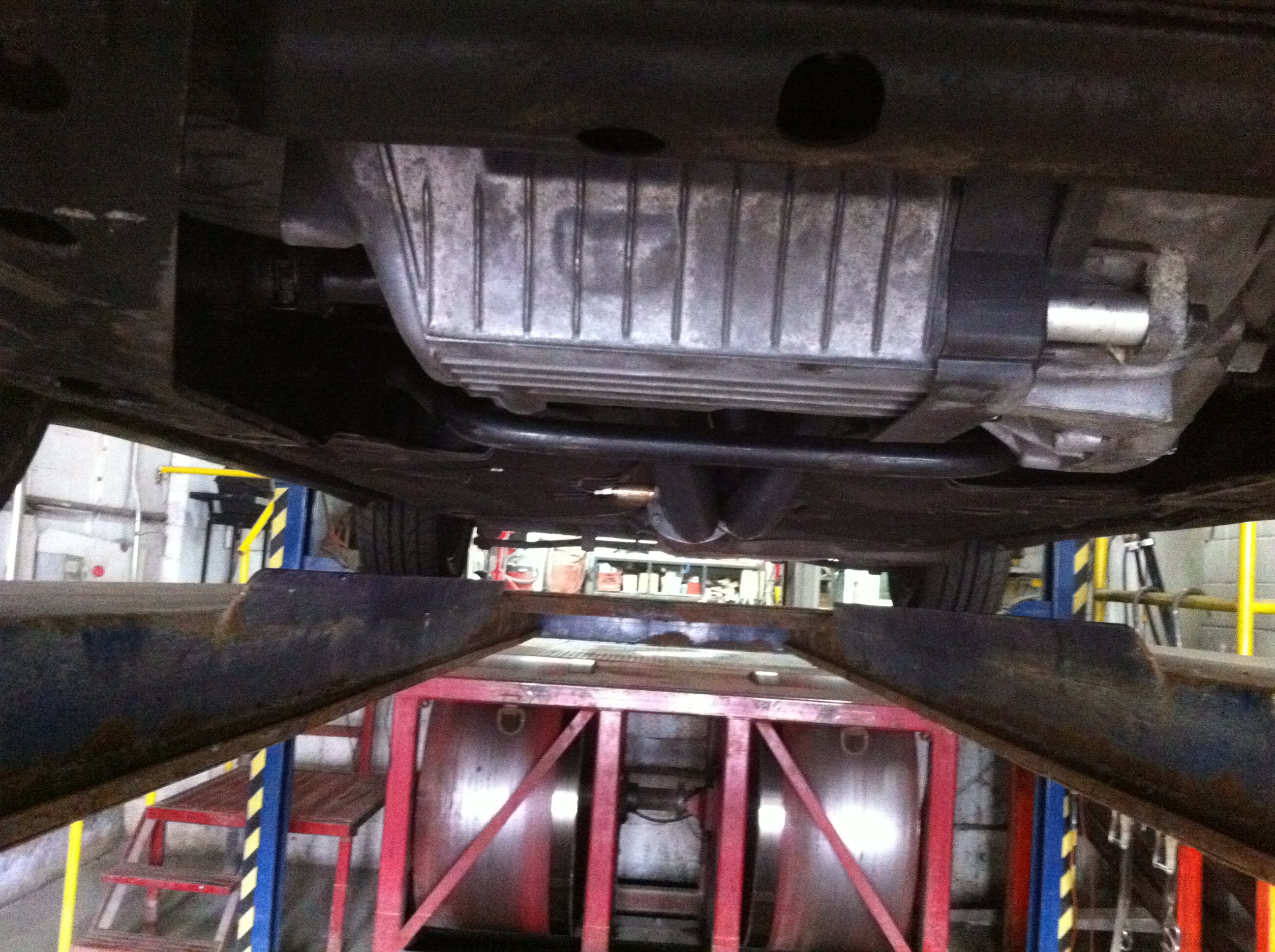

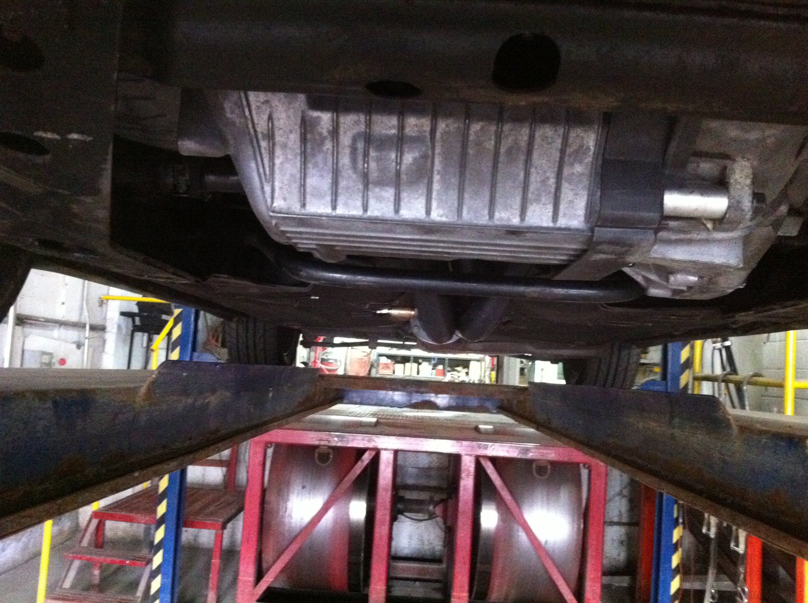

headers hanging low
dyno run...

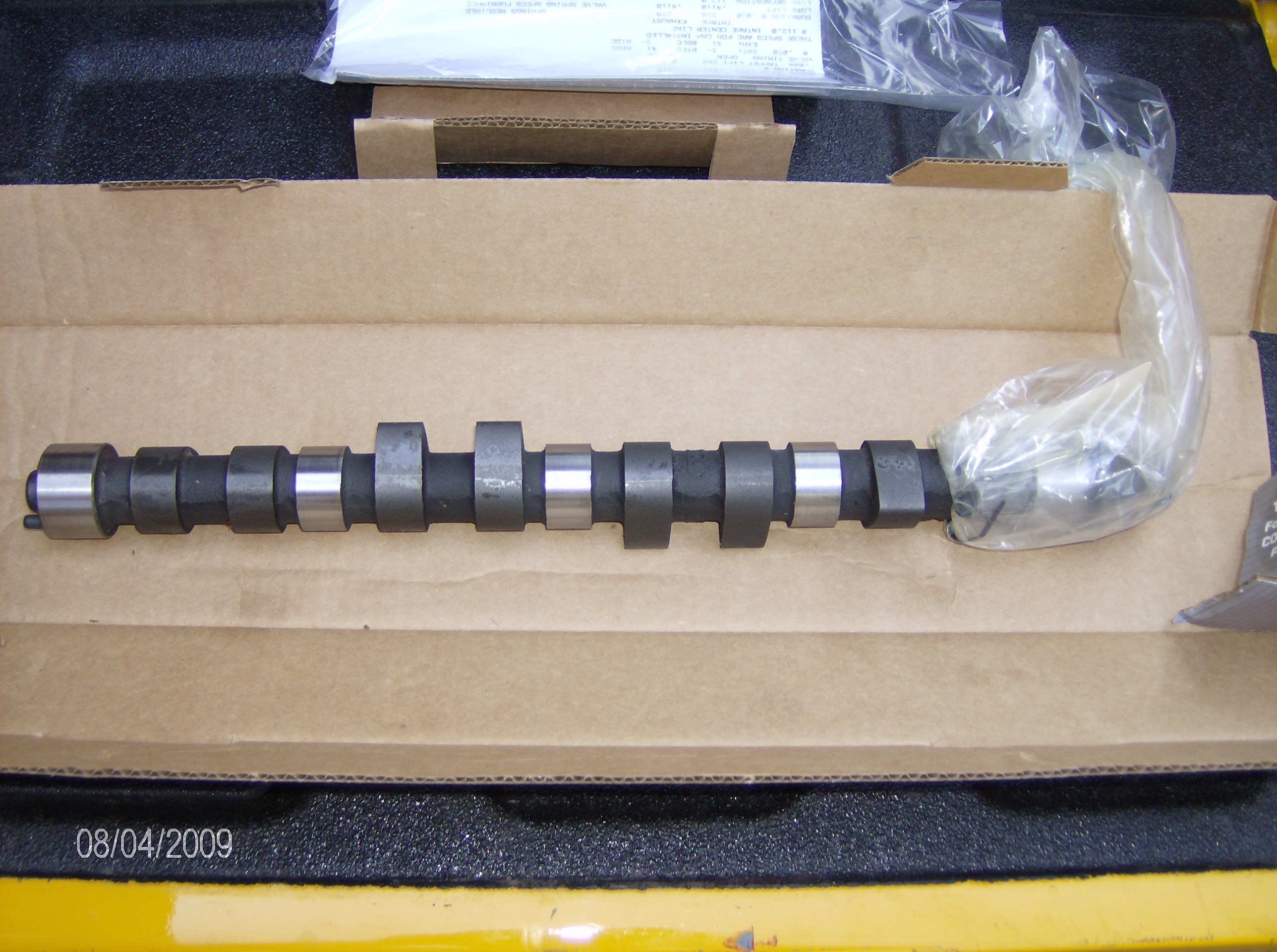

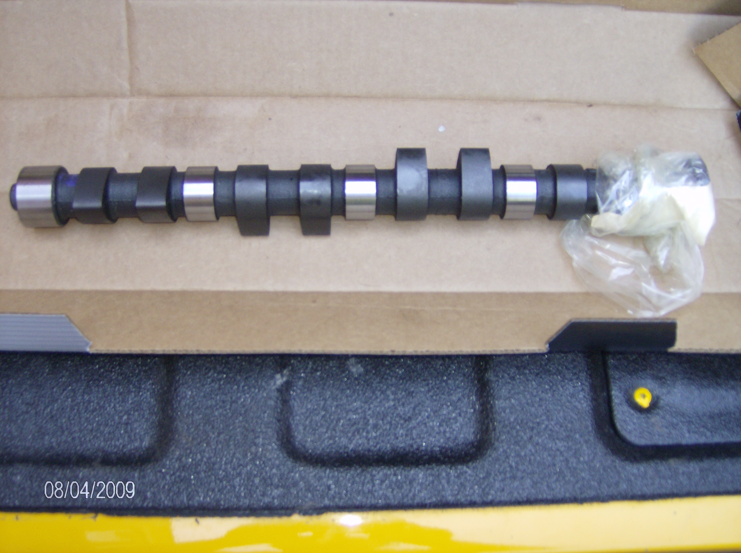

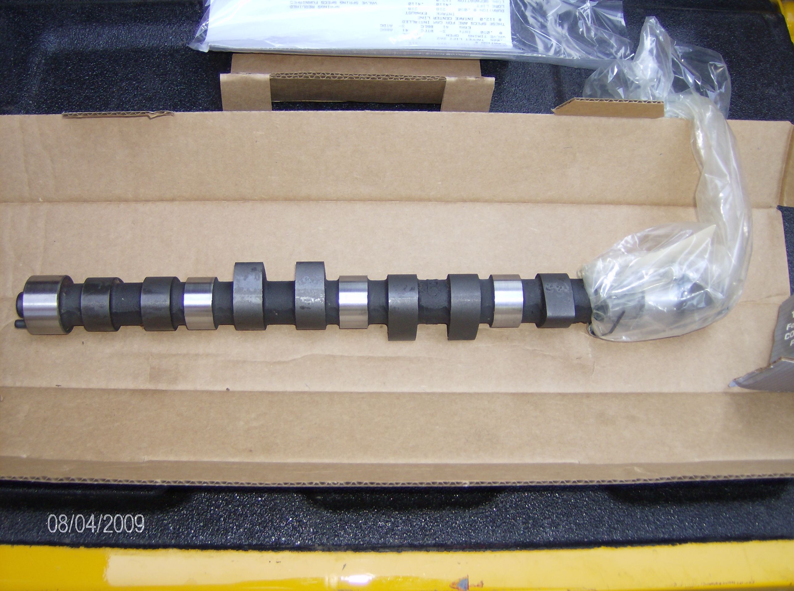

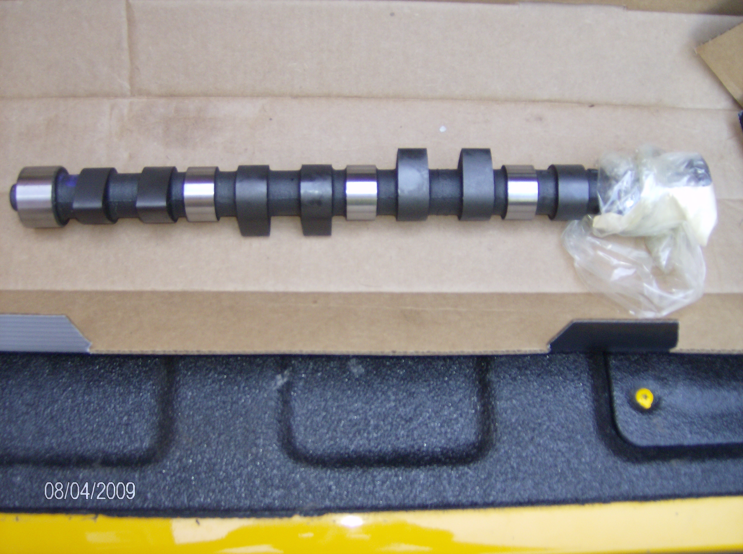

2009, the installation of newly grinded W 41 cams
intake cam
exhaust cam

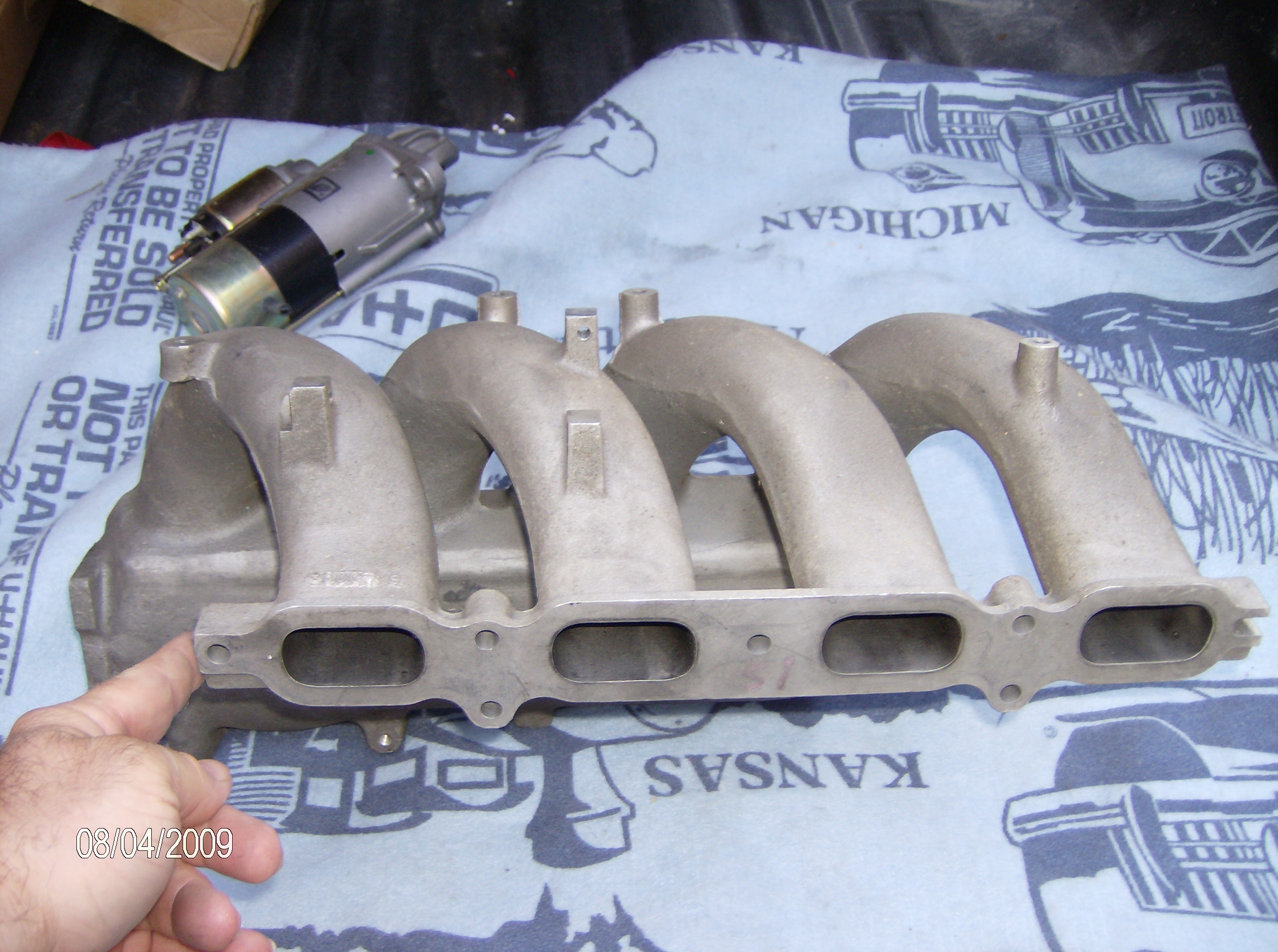

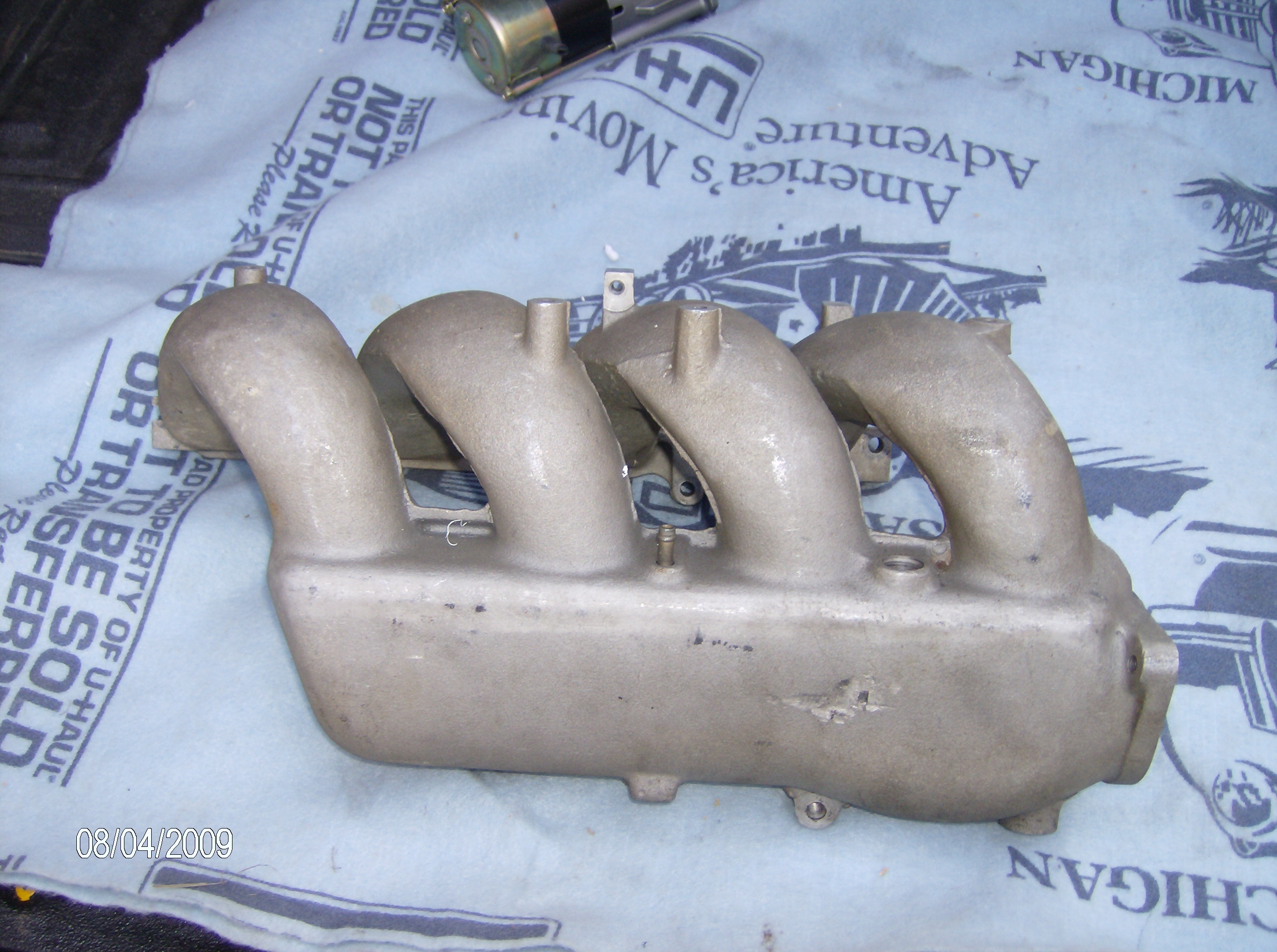

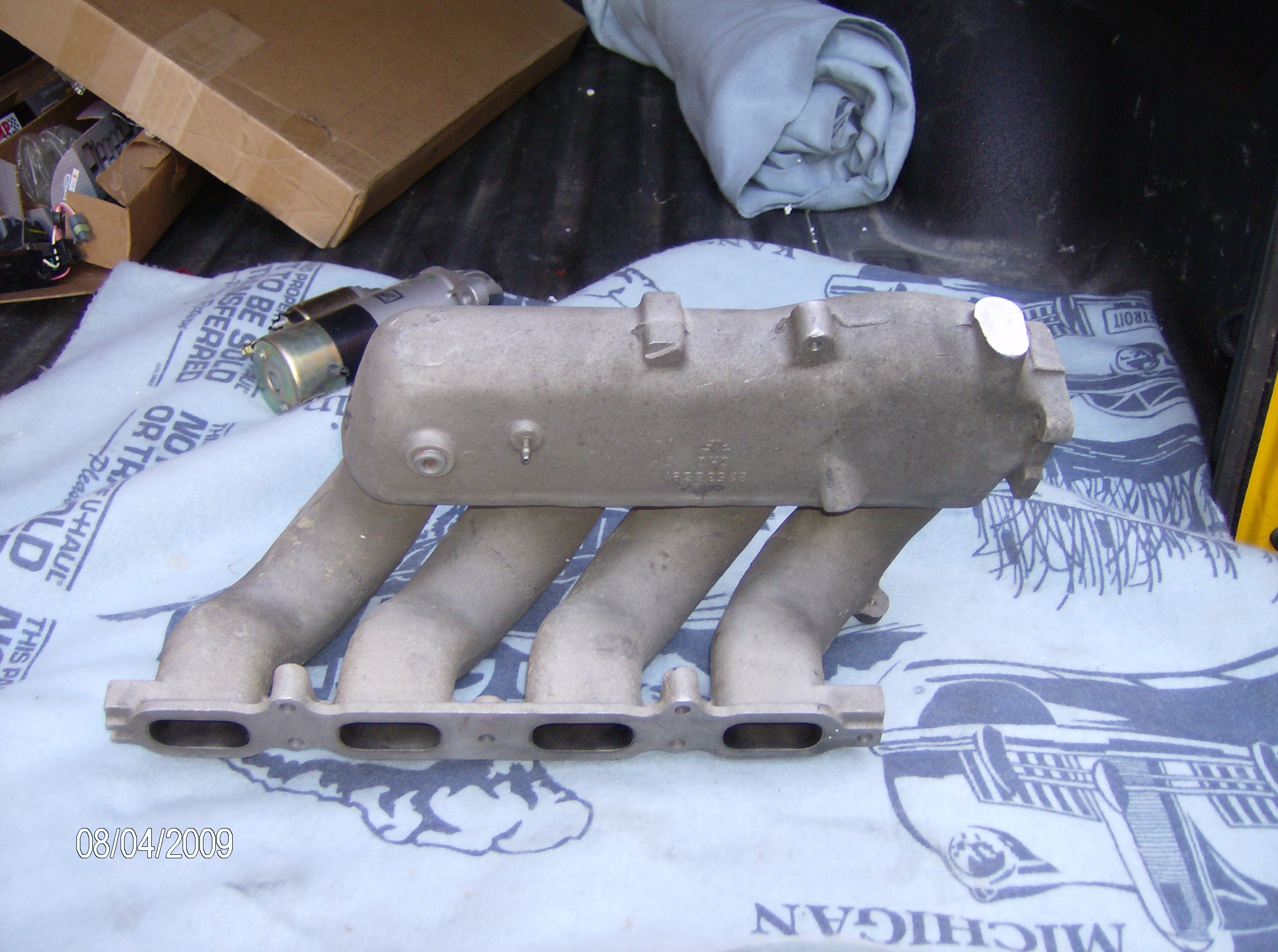

extrude and honed intake log

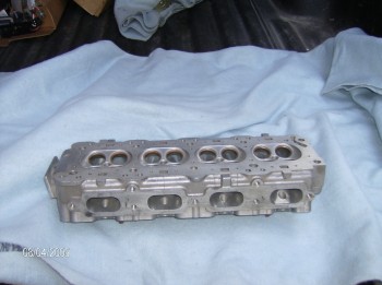

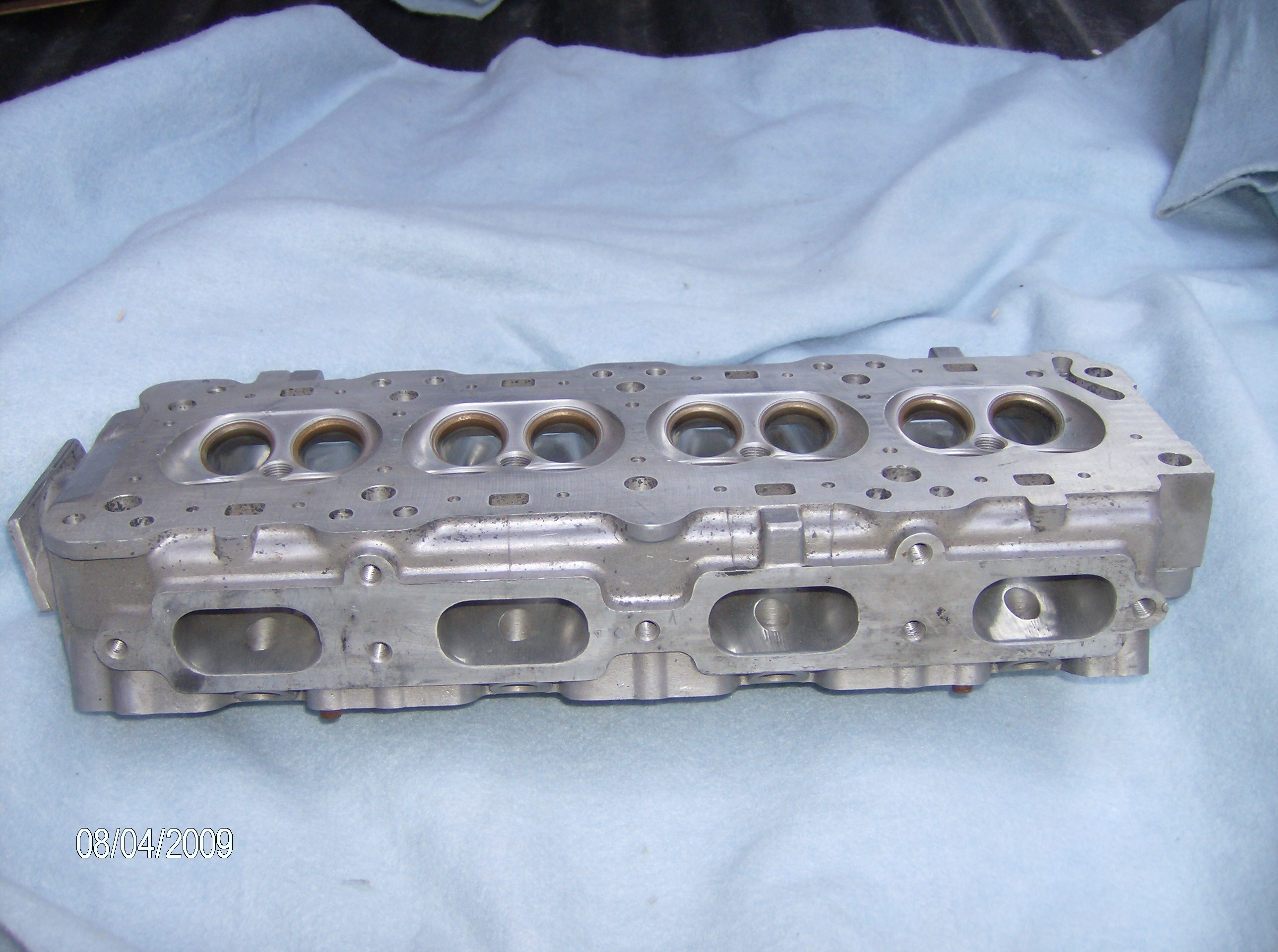

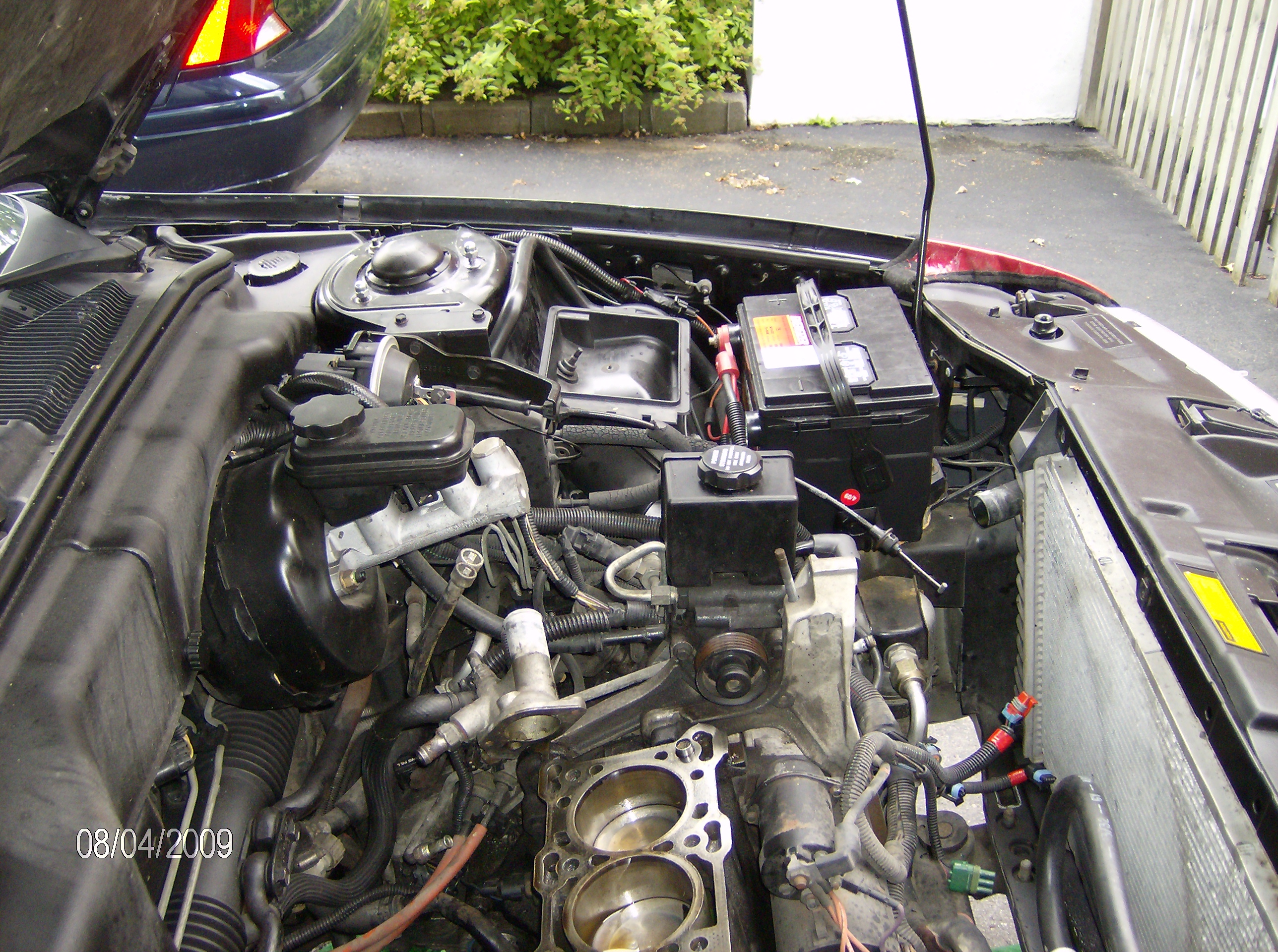

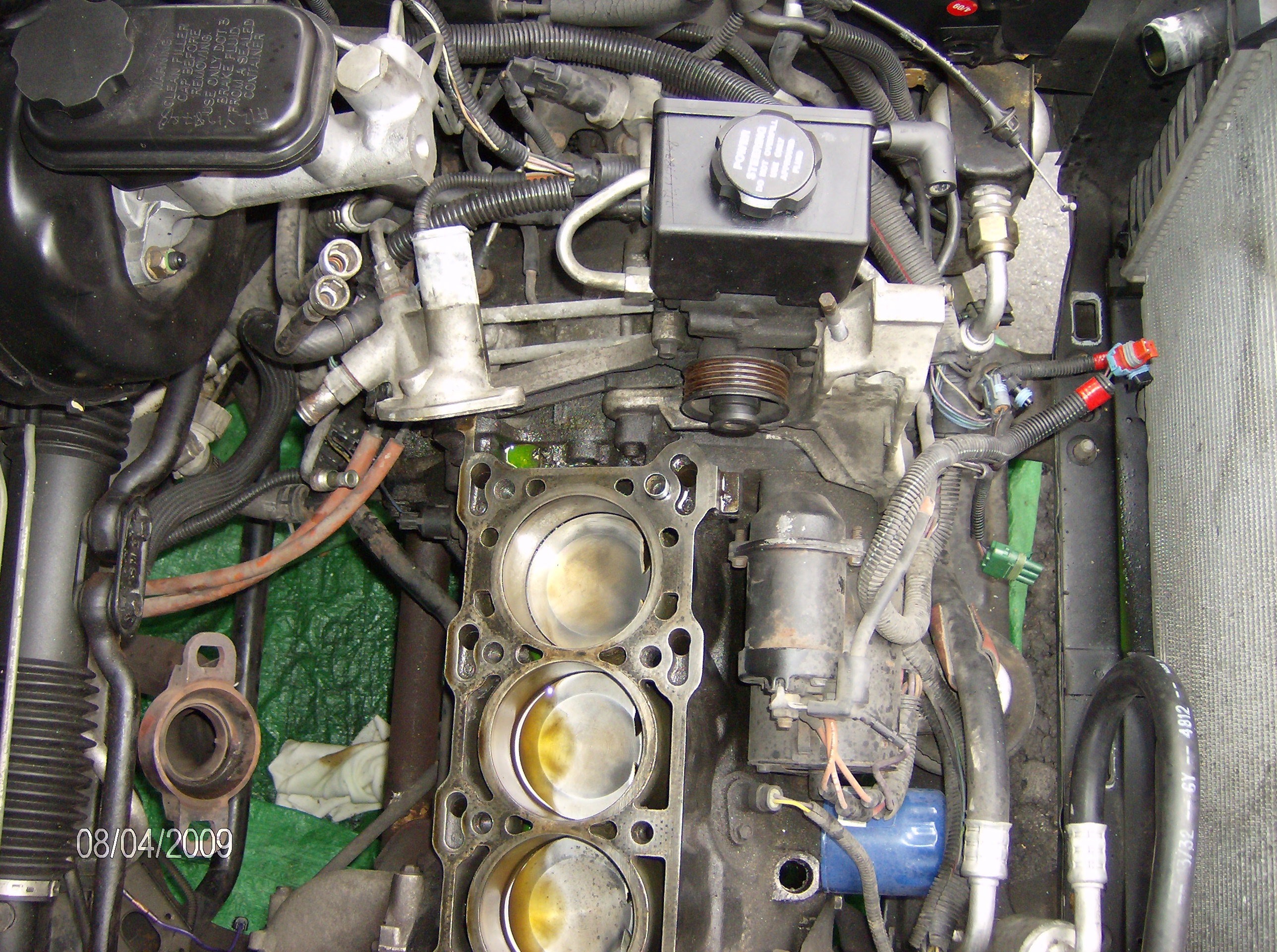

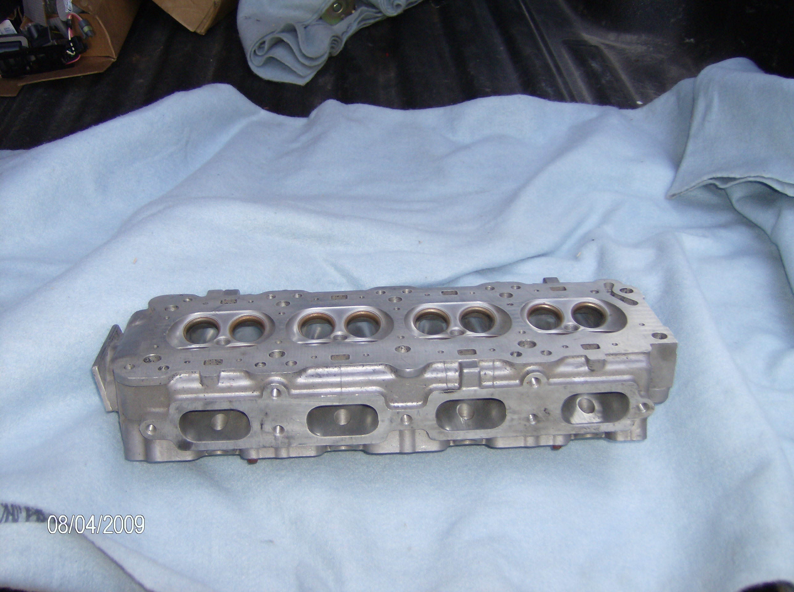

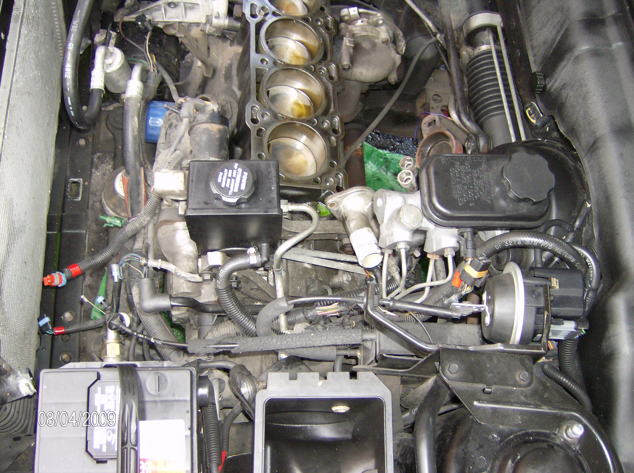

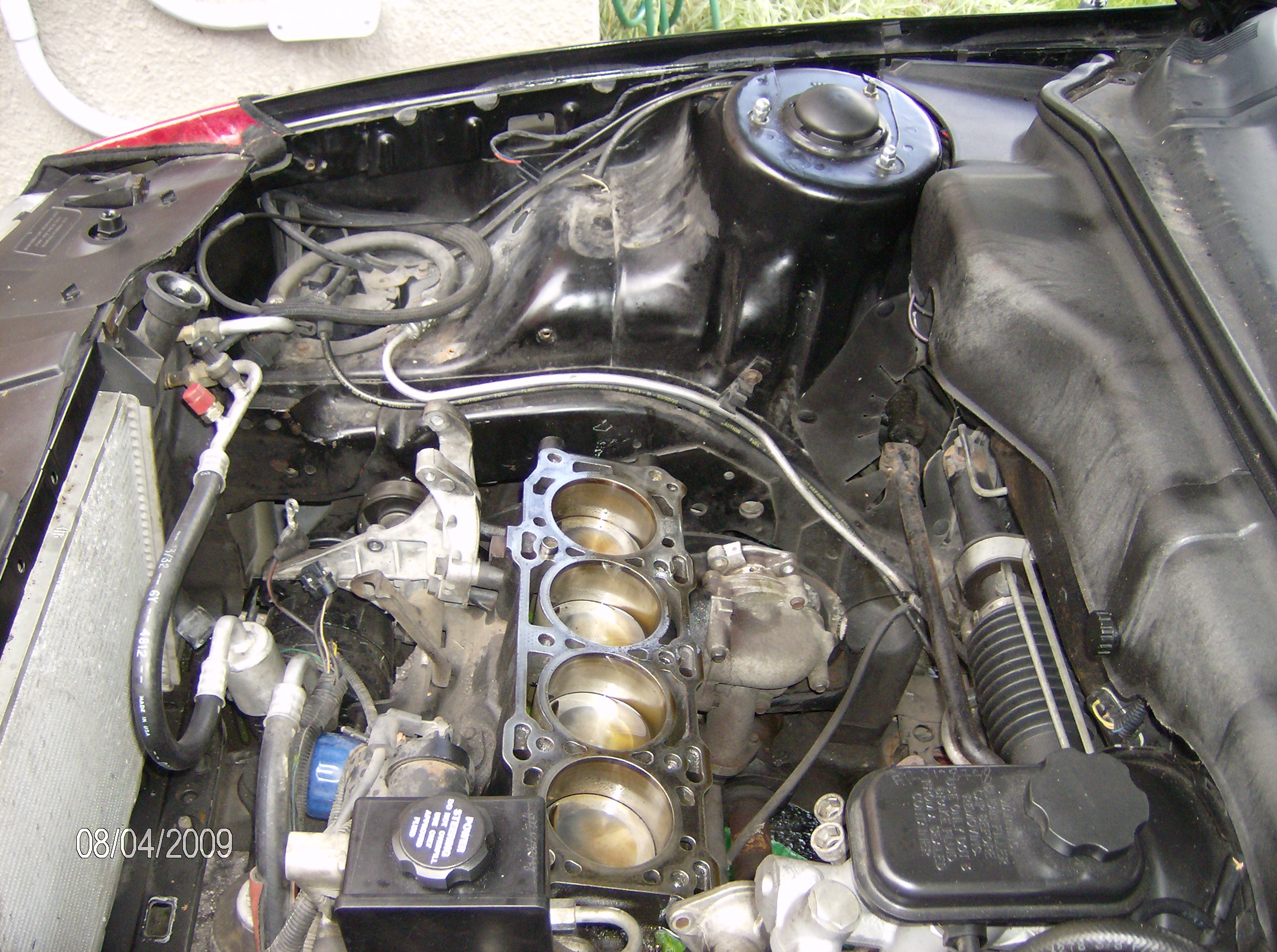

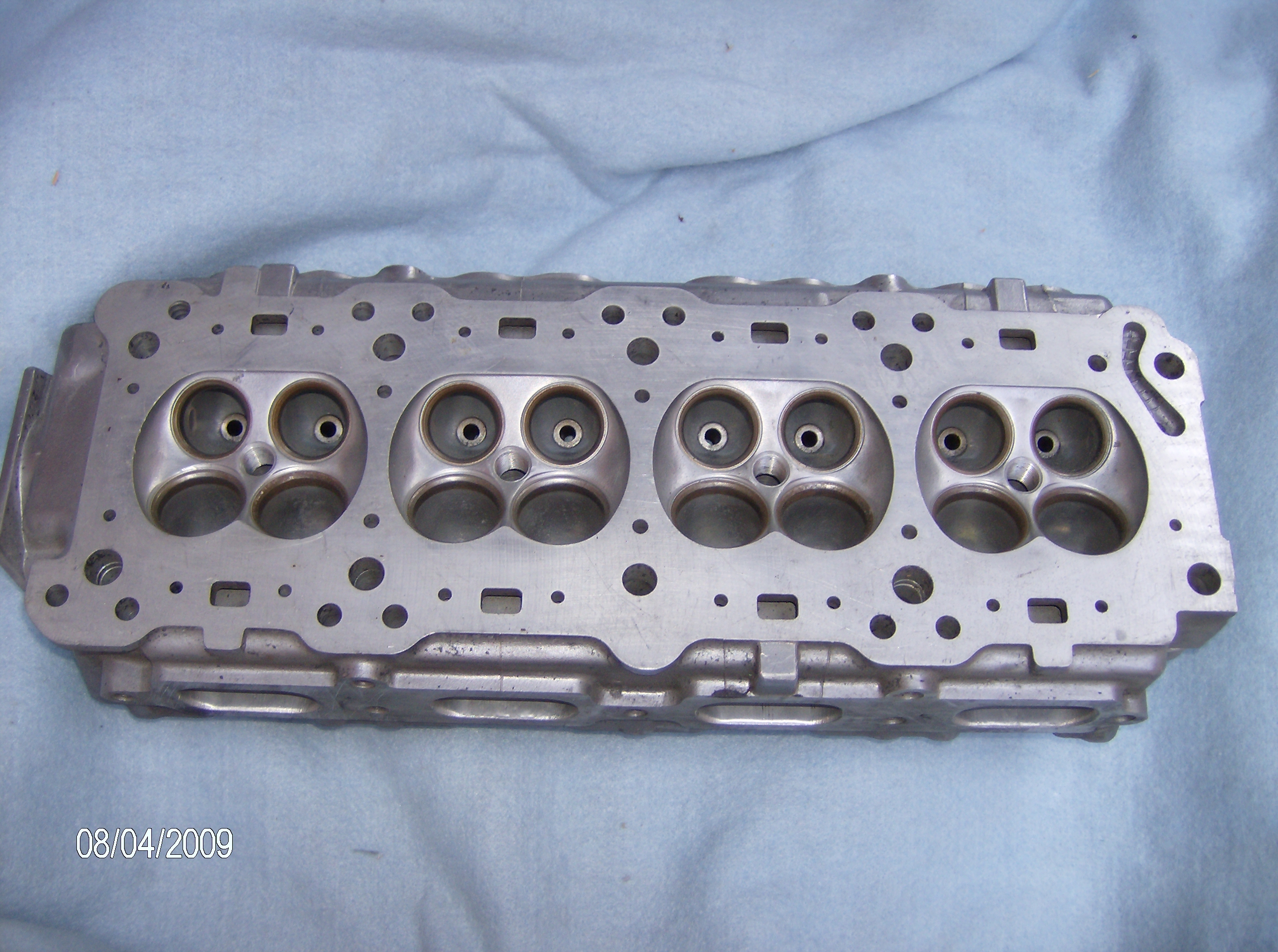

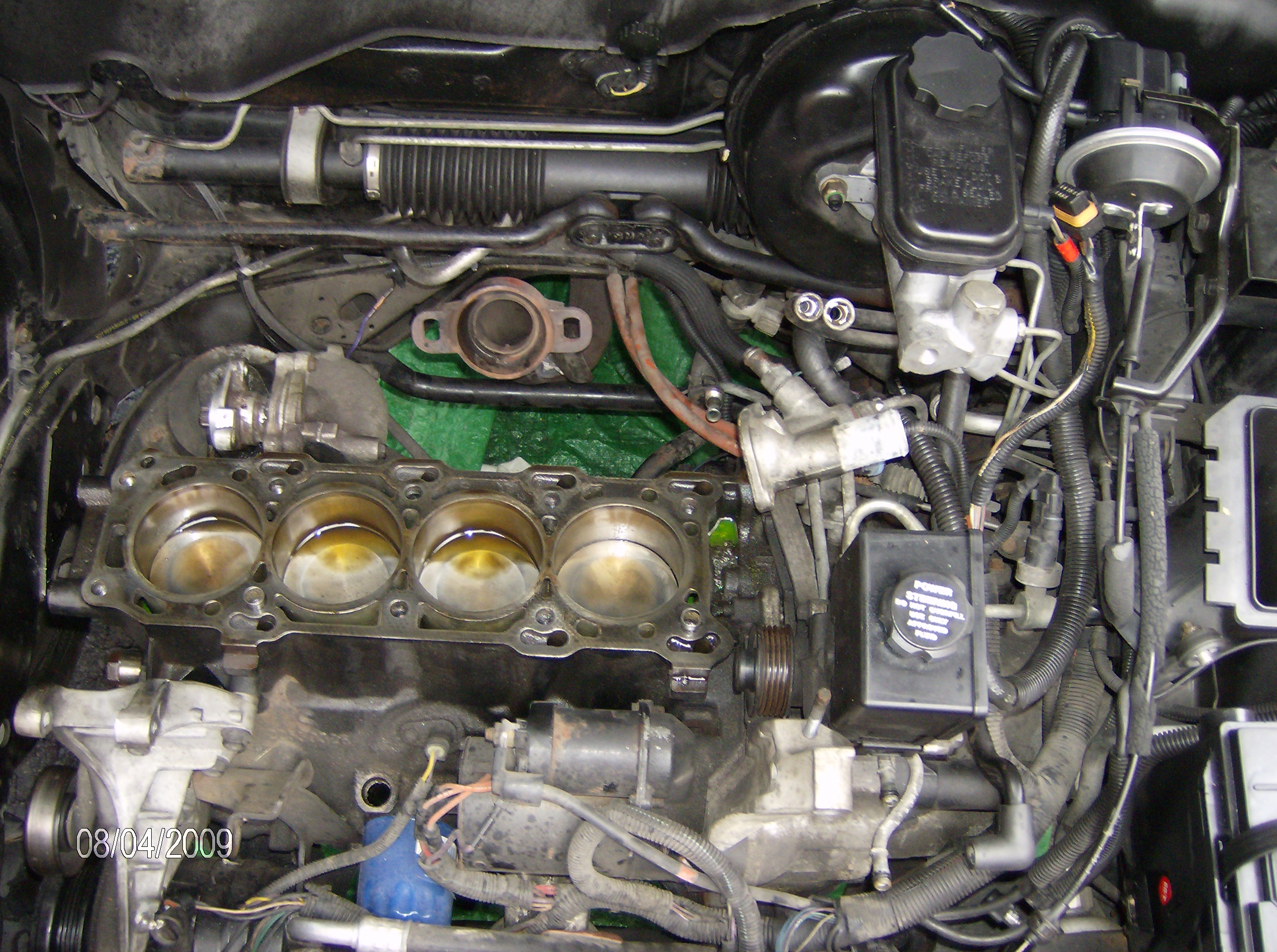

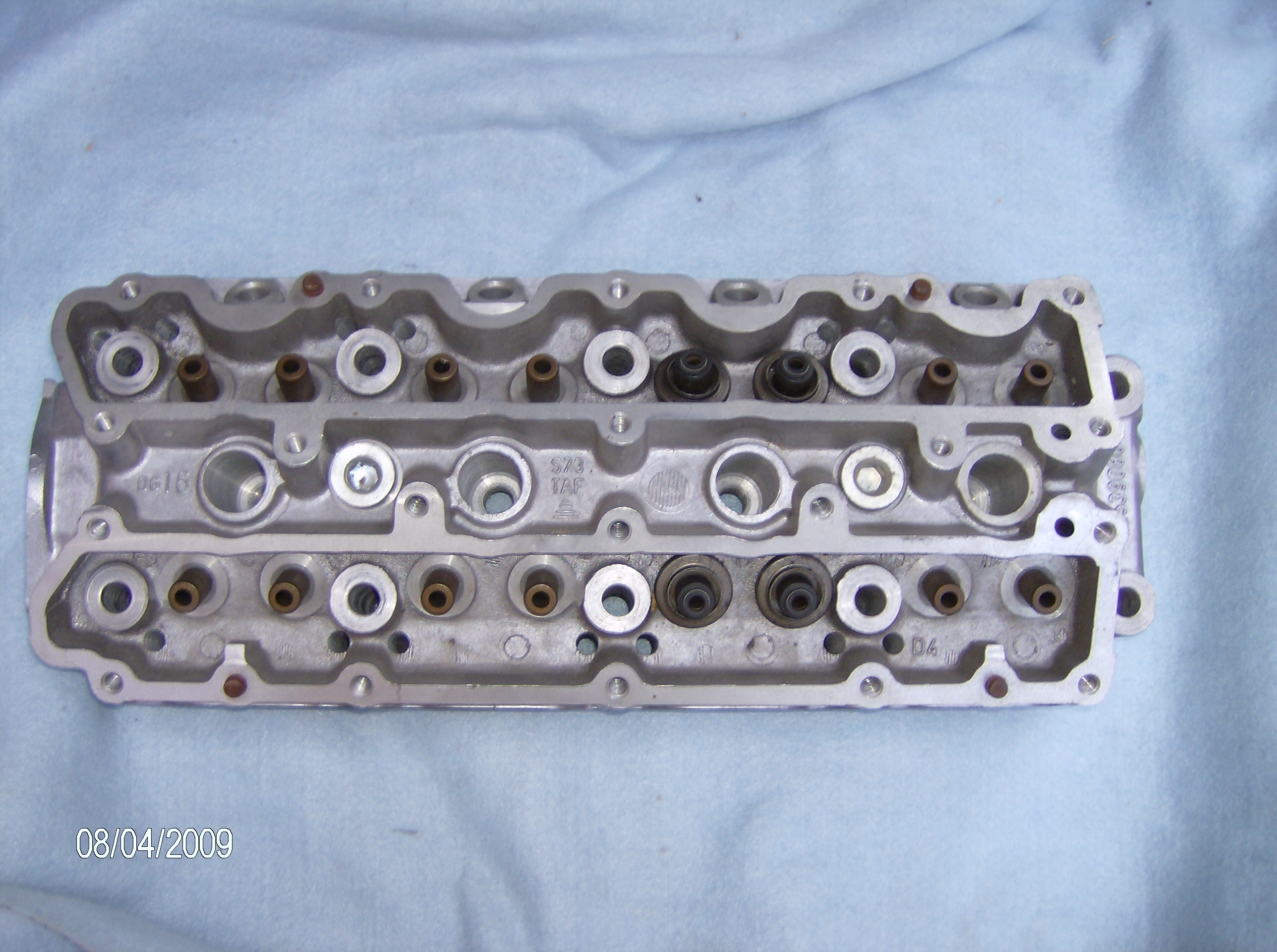

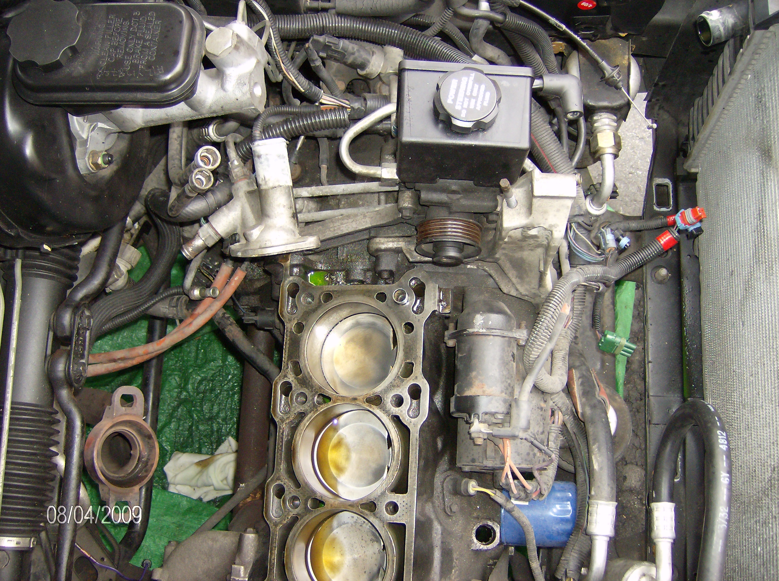

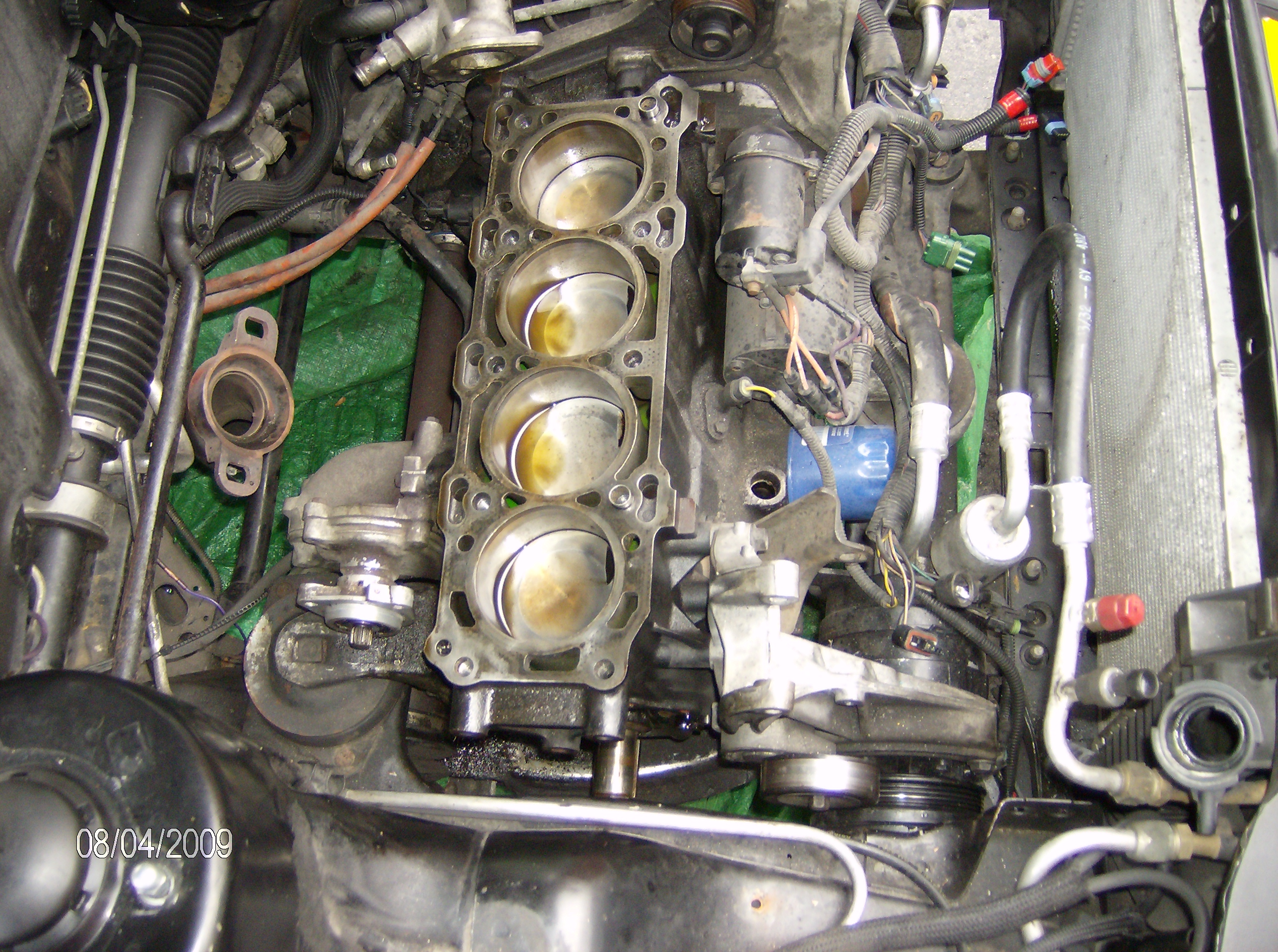

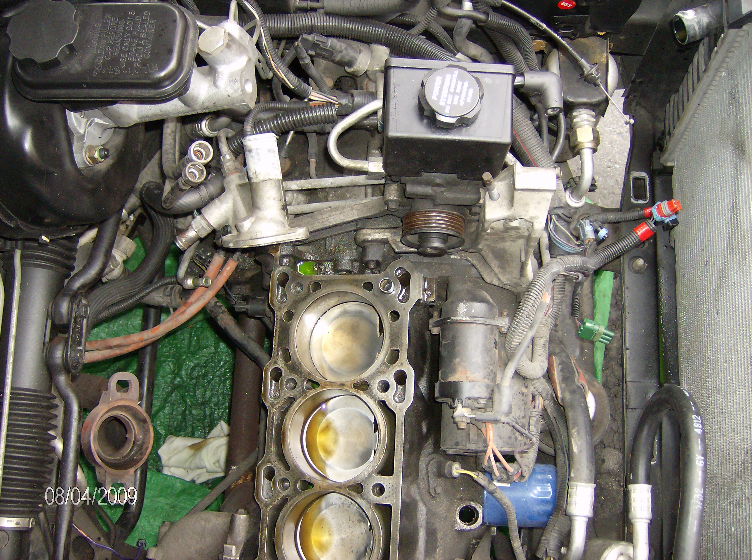

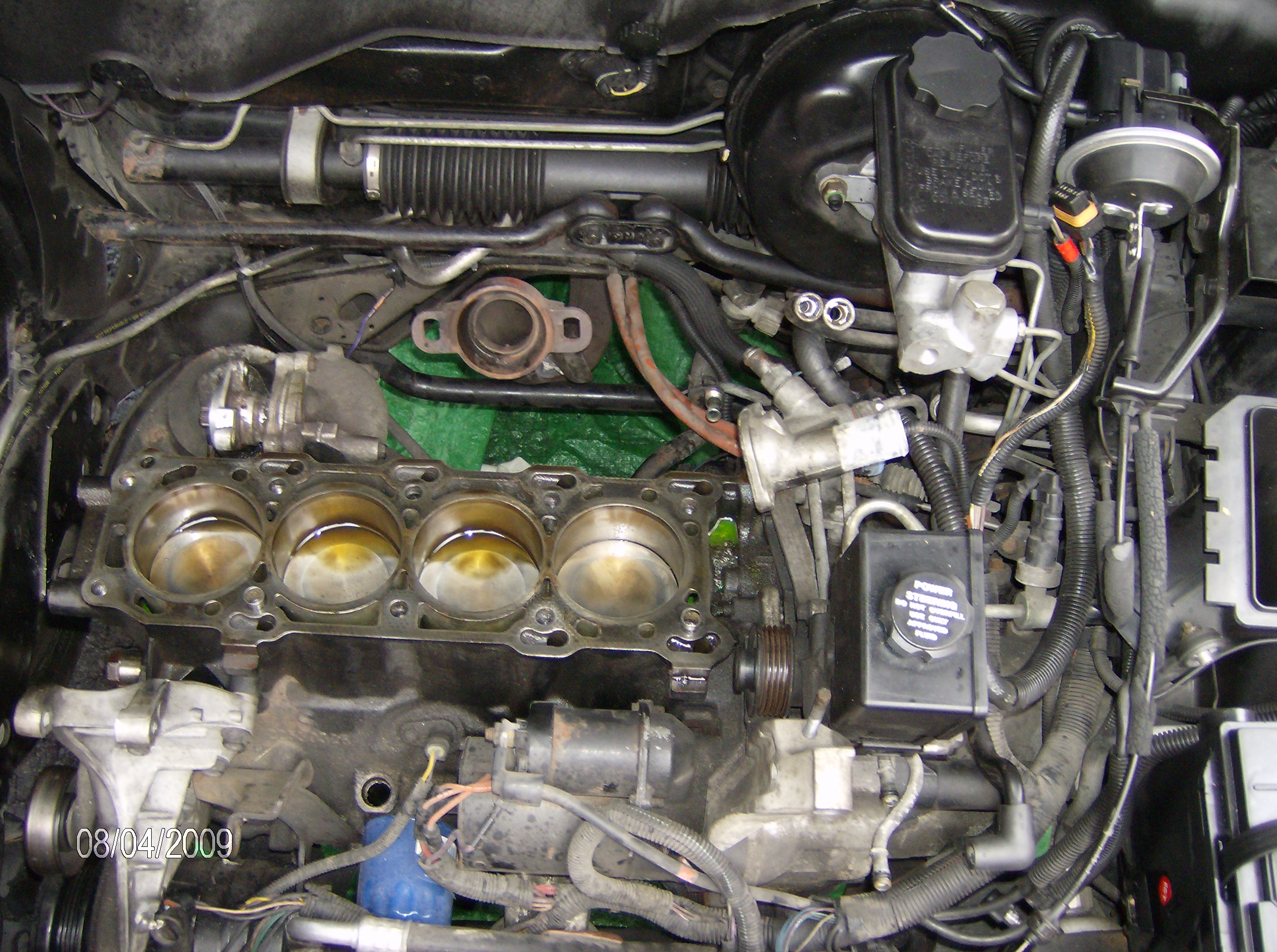

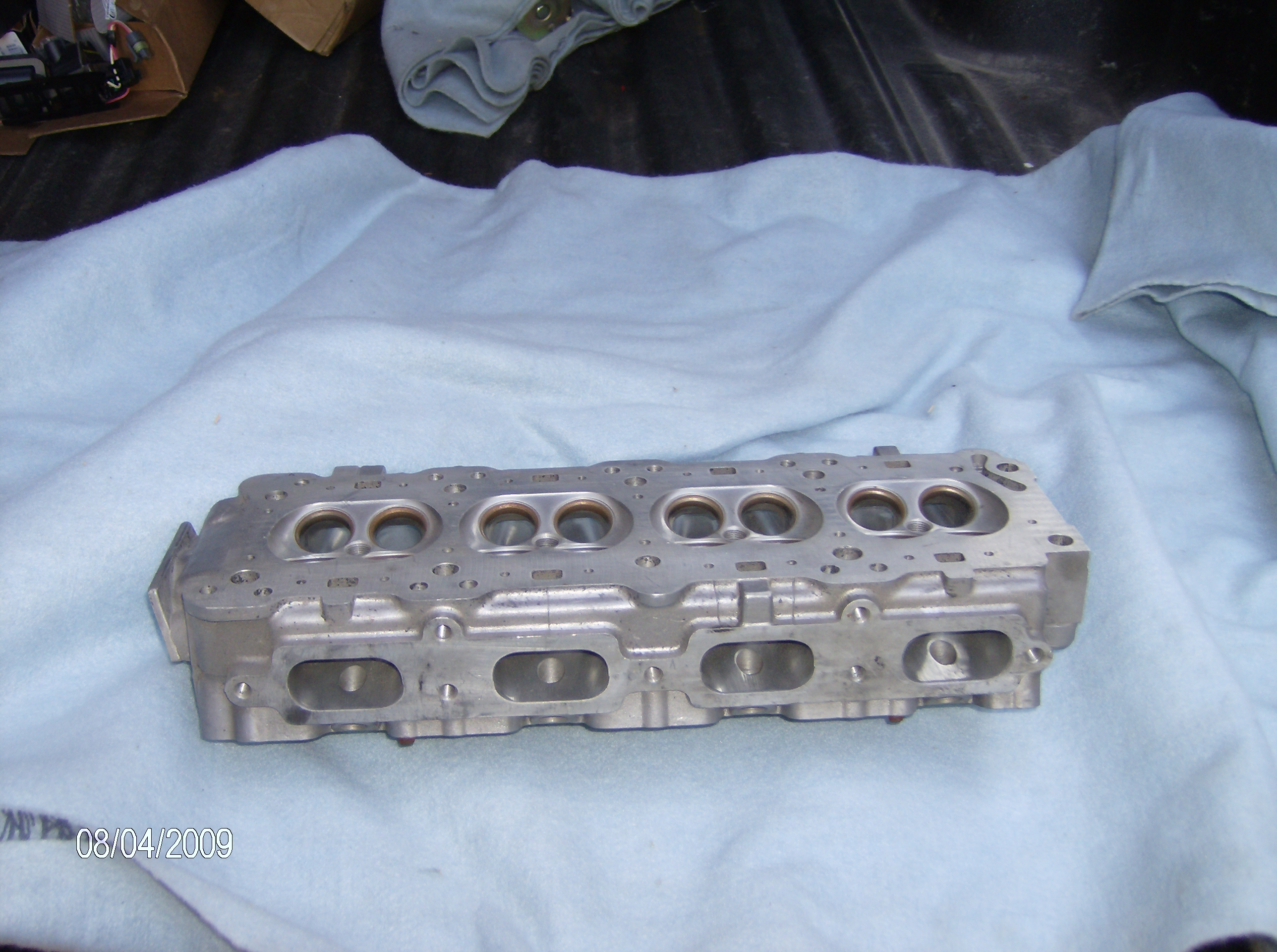

august 2009 w 41 cam swap build up.
ported and polished head
compression test
Red_Bra_Black_GTZ
Posts: 378
Post by Red_Bra_Black_GTZ »

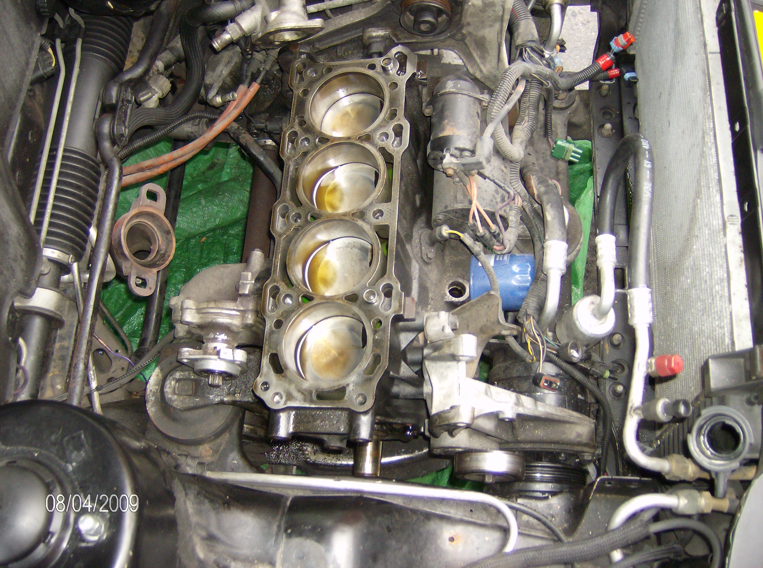

august 2009 W41 cam swap
compression test
