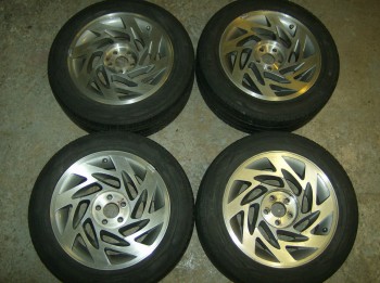

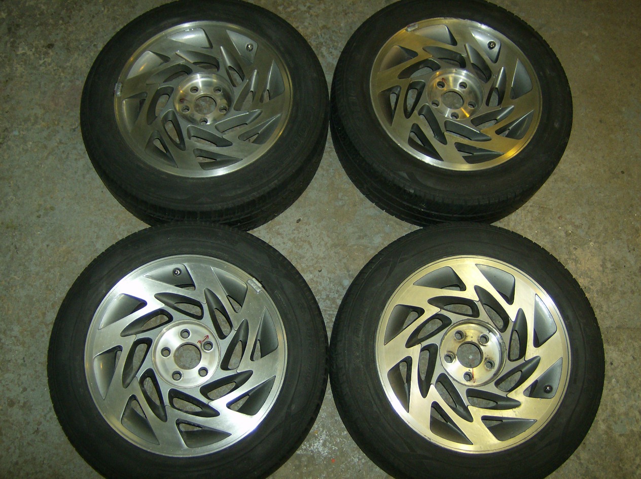

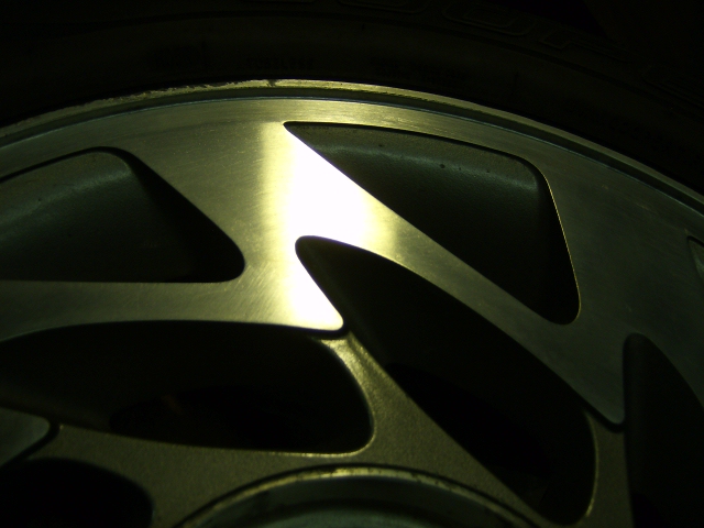

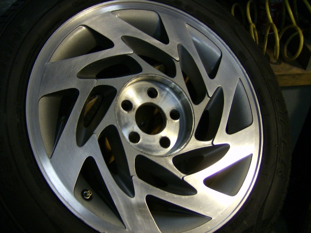

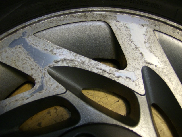

Post by ifixalot »

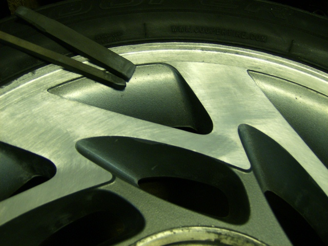

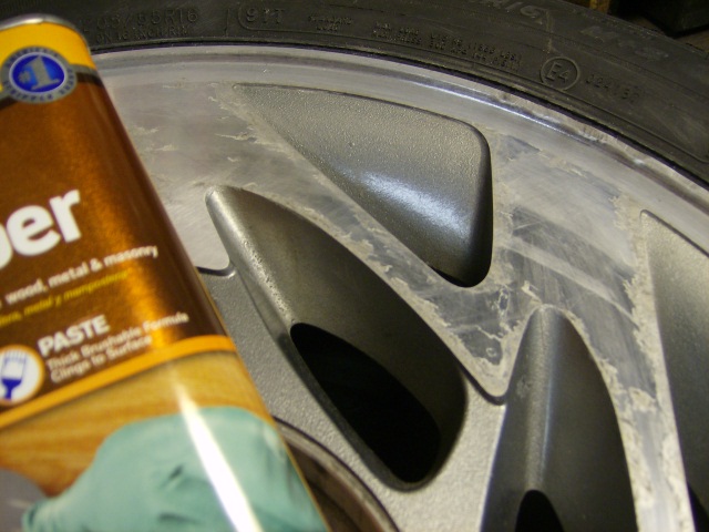

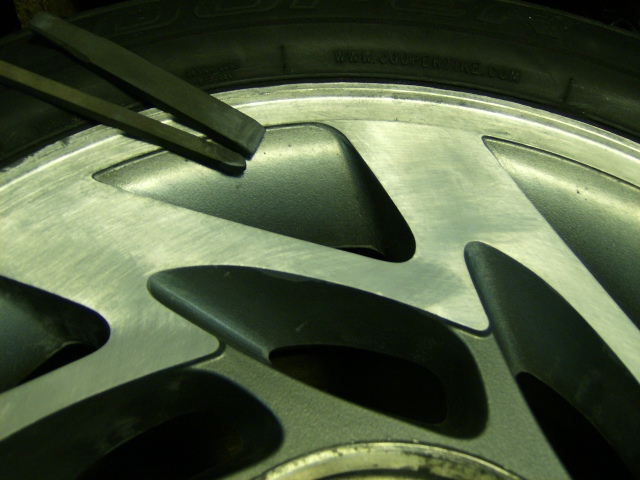

I'm using some mold maker polishing stones to clean up the aluminum after stripping the clear off.
Then I spin them on my Bridgeport mill using a wire brush to shine the surface. Not perfect but much improved
over what they were. I can't wait to put them on the 88 GT. Then I'm coating them with polyurethane.
It takes a few hours per wheel. I just hope it stands up the the weather.

They look very nice. Good work!

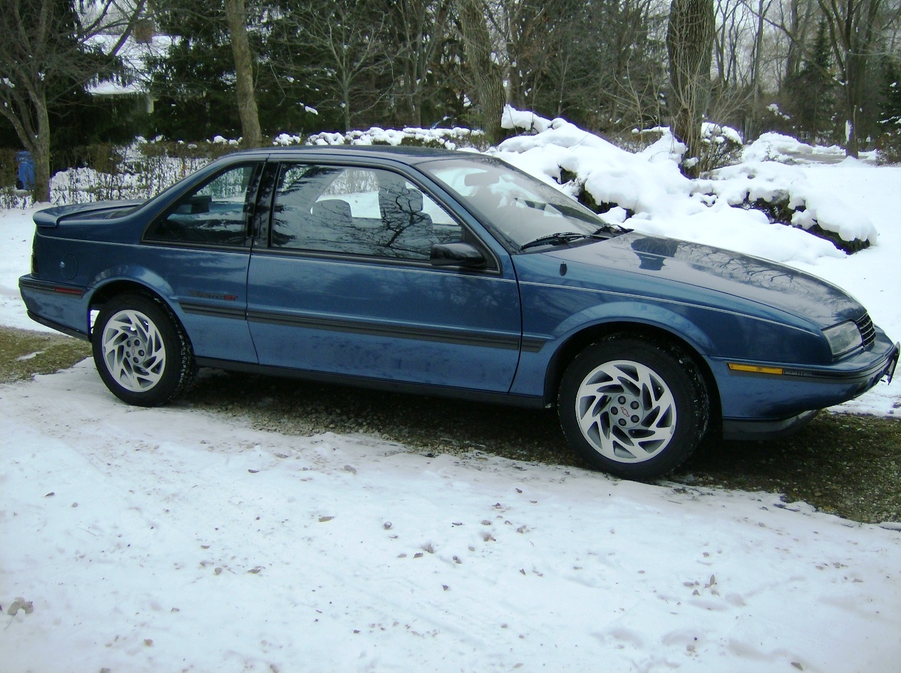

Below is a pic my 88 with her news shoes.
whiteretta
Posts: 767
Location: New Carlisle, Ohio
Re: Polishing my Z26 wheels
Post by whiteretta »
Looks good! I love that color too. AutoZone sells the 303 now as well!
