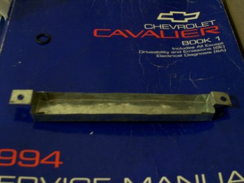

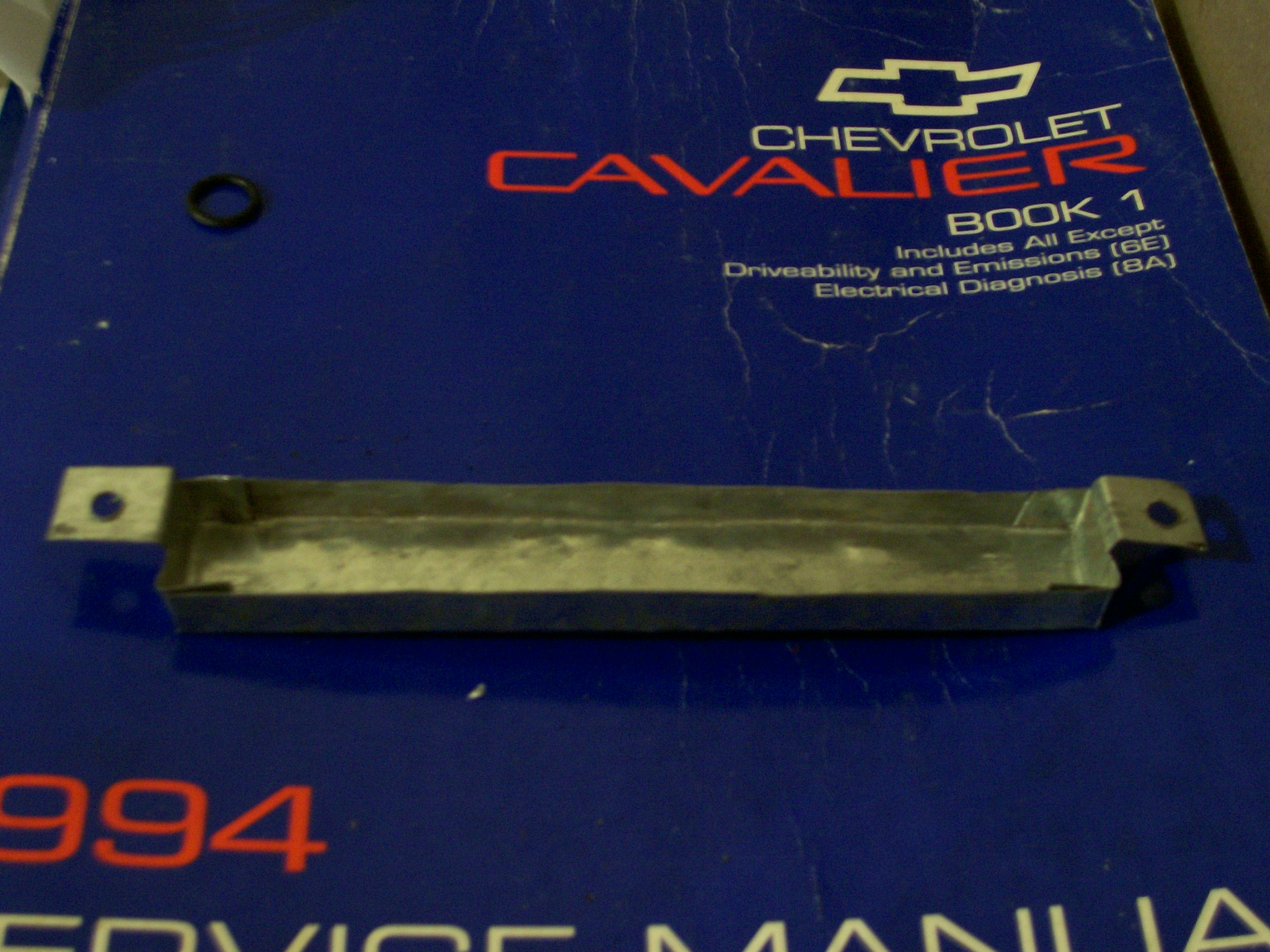

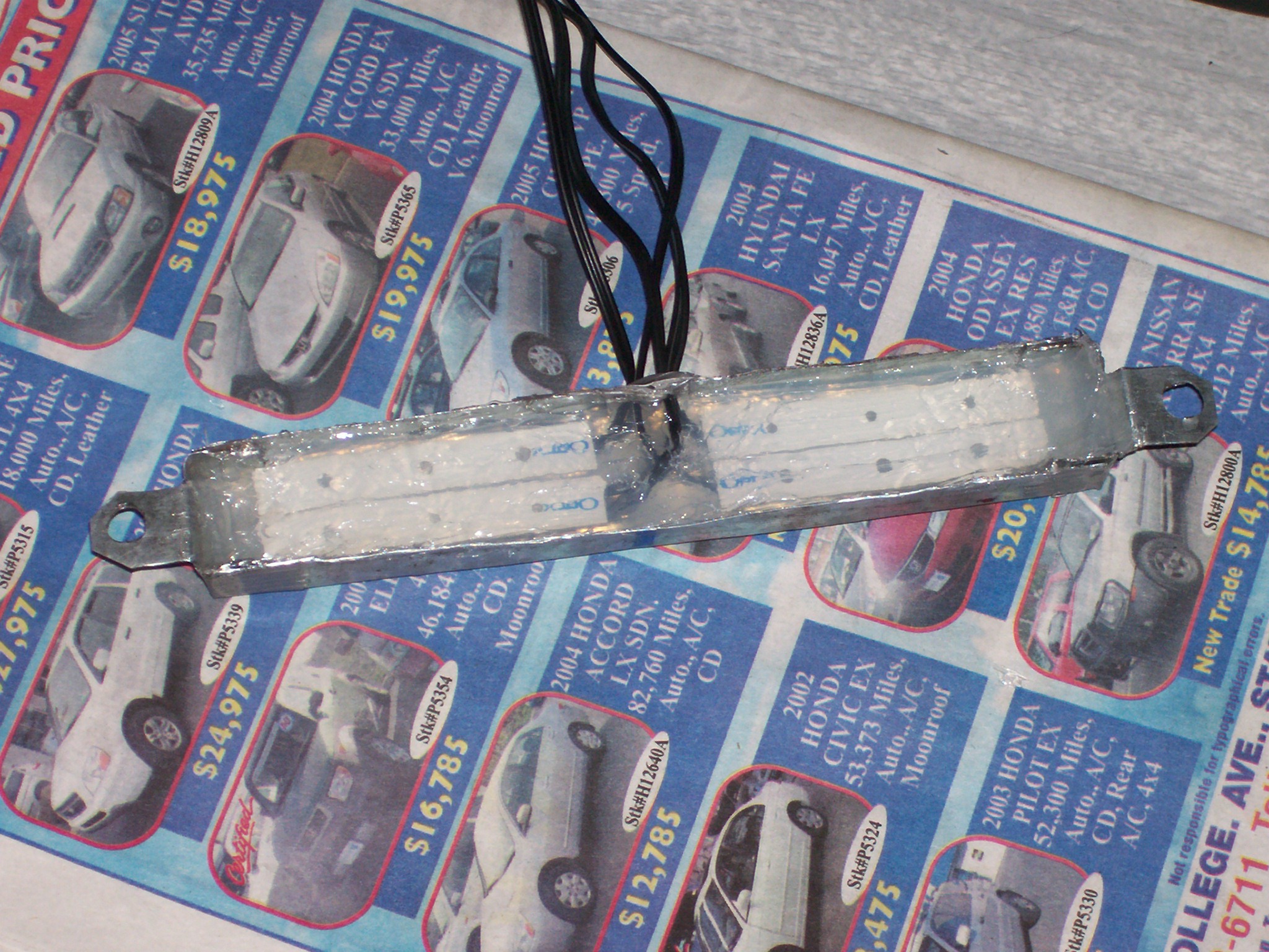

Here is a pretty cheap way to make a LED brake light for GTU spoiler. I made a tray out of sheet metal, Bought some suitable RED led strips from advance, then covered them in clear silicon. I still utilized the GTU brake light lense since it wasn't warped too bad. Spliced the wires in parallel and then utilized the factory plug so I could plug in into my factory harness. Now don't get me wrong, you can't see the individual led's like in caddy tails or anything but it lights up faster then regular bulbs if you're savvy to that.
