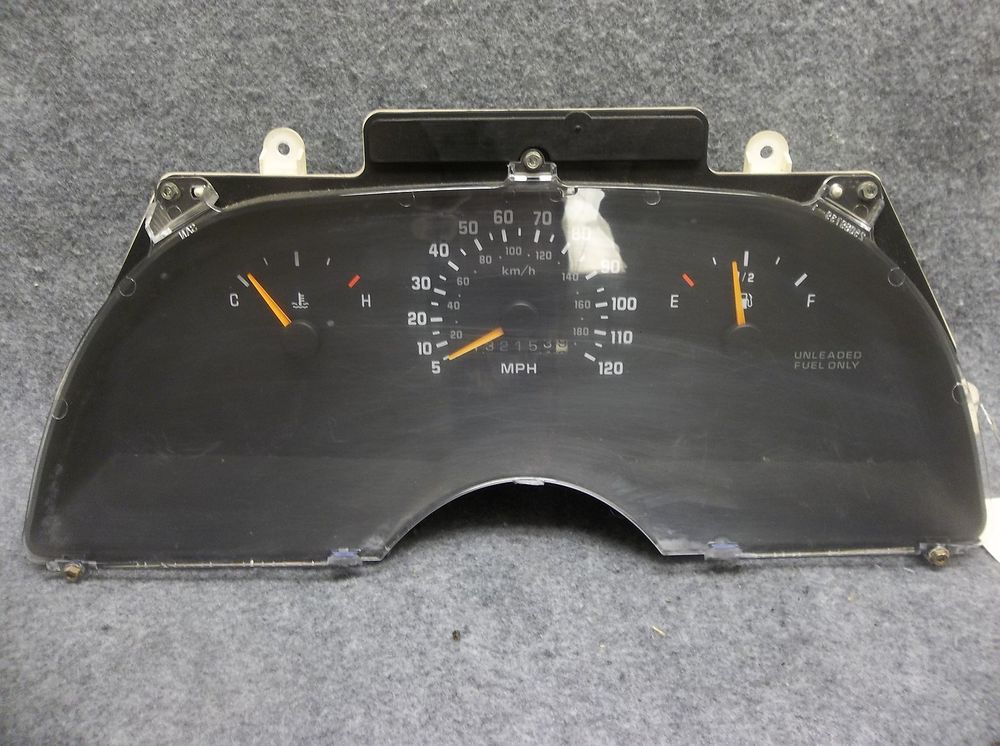

The dash is a different shape, and the harness and plug is different, that would all need modified to work.
I don't know if the OBD2 ECM will output what is needed to make the digital cluster display correctly. I don't think it does, someone else will have to help you with that.
If you have the base cluster and want all the gauges, there is a tachometer cluster for the 96 Beretta, its a direct swap. I did that on my 1996 Beretta in the past, works great. I also swapped my odometer from my base cluster to keep my exact mileage. Just make sure you put the speedometer back in the right spot on the 96 tachometer cluster if you disassemble it to swap your odometer into it.
You would also need to swap the oil pressure sensor for the gauge if you don't already have it.

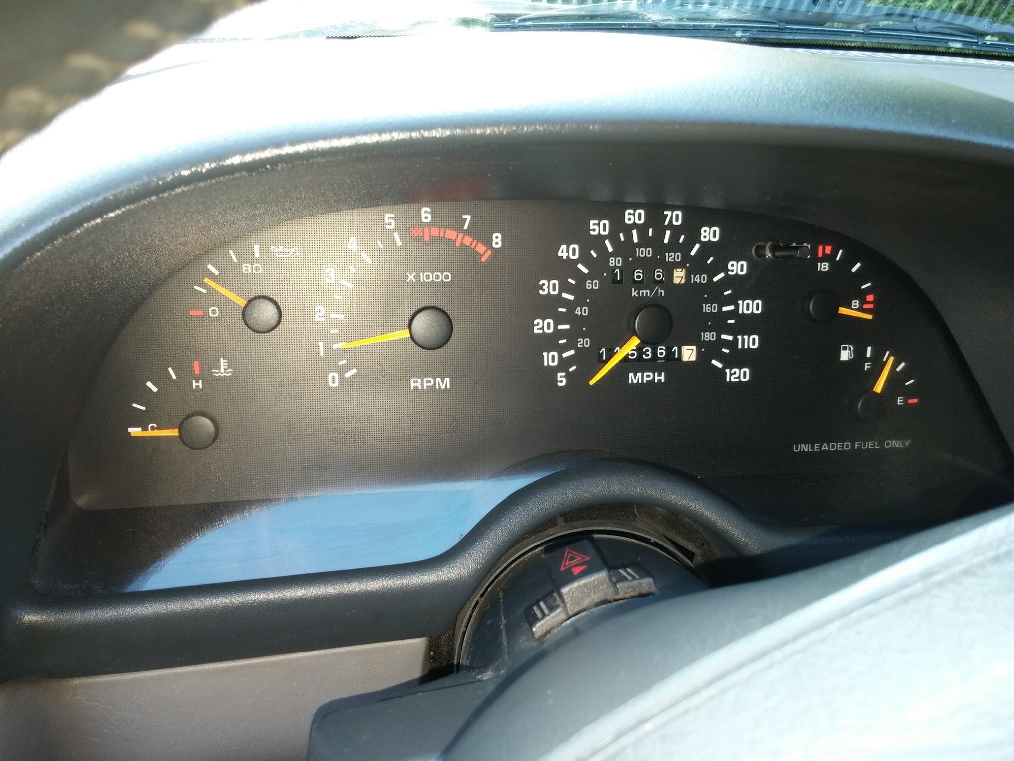

Below is a photo of my tachometer cluster in my 96 Beretta:

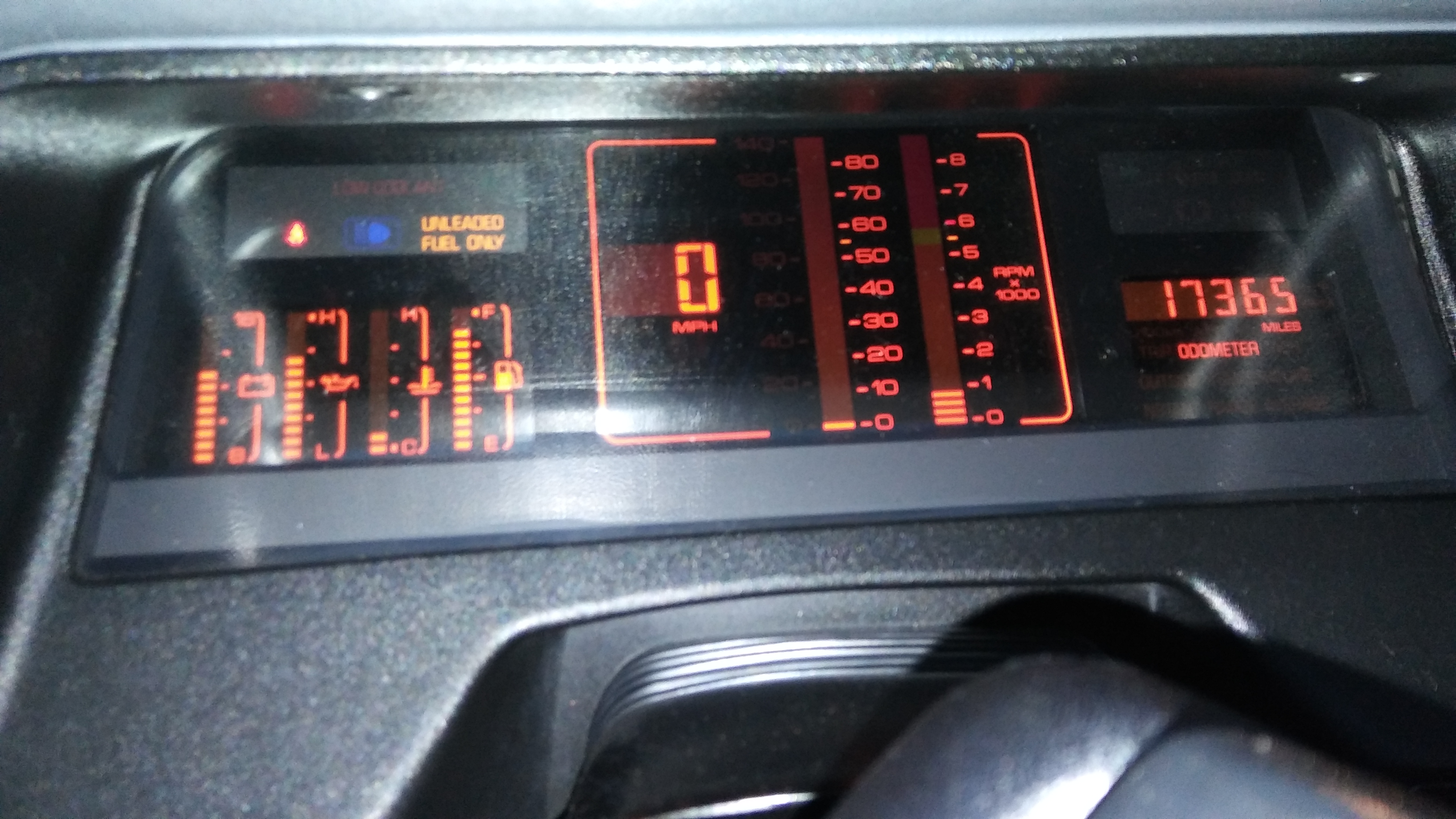

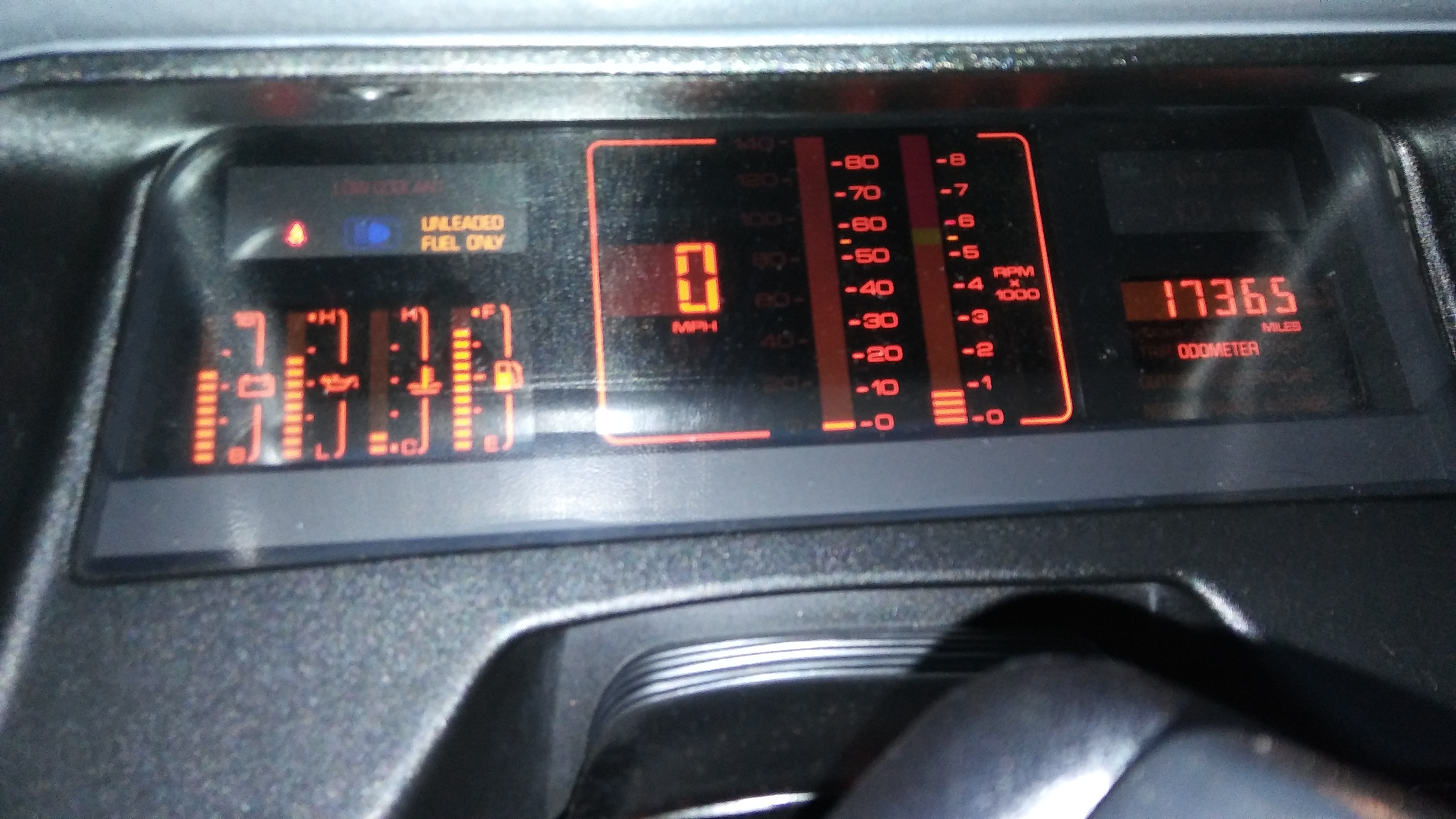

Below is a photo of my digital cluster in my 1990 Beretta:
Below is a random photo from the internet of the new style base cluster:

Thanks, I do have the upgraded cluster with the tach and stuff. But since my car is mint and I don't wanna do a bunch of modifying on an entirely original car with 65k, do you think I would be able to just make the cluster light up and stuff with no ECM? I thought about using it as a cool decoration or something.

65K miles? Thats awesome! Of the cars that still exist, not many of these cars are under 100k miles anymore, way less than that are under 20k like my Indy.

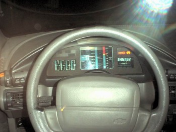

I need to see a photo of the corsica running the digital dash. I didnt think a corsica had one modded into it.
I havent looked much into the digital cluster to know for sure on running it with OBD2.
The cluster would be a cool night light. lol. I once had an analog cluster connected to a signal generator to read high speed. lol.
Thanks. Its not too hard because it always has a spot in the garage. I only meant to post the pic to show the difference in shape. lol.
I've seen a digital cluster sell on ebay for like 250 some time back. I dont know if there are any listed now, they are a bit rare.
If you make a post in the wanted section someone might reply that they have one they arent using. They may also have the wire harness. It depends who has what in their parts stash. lol.

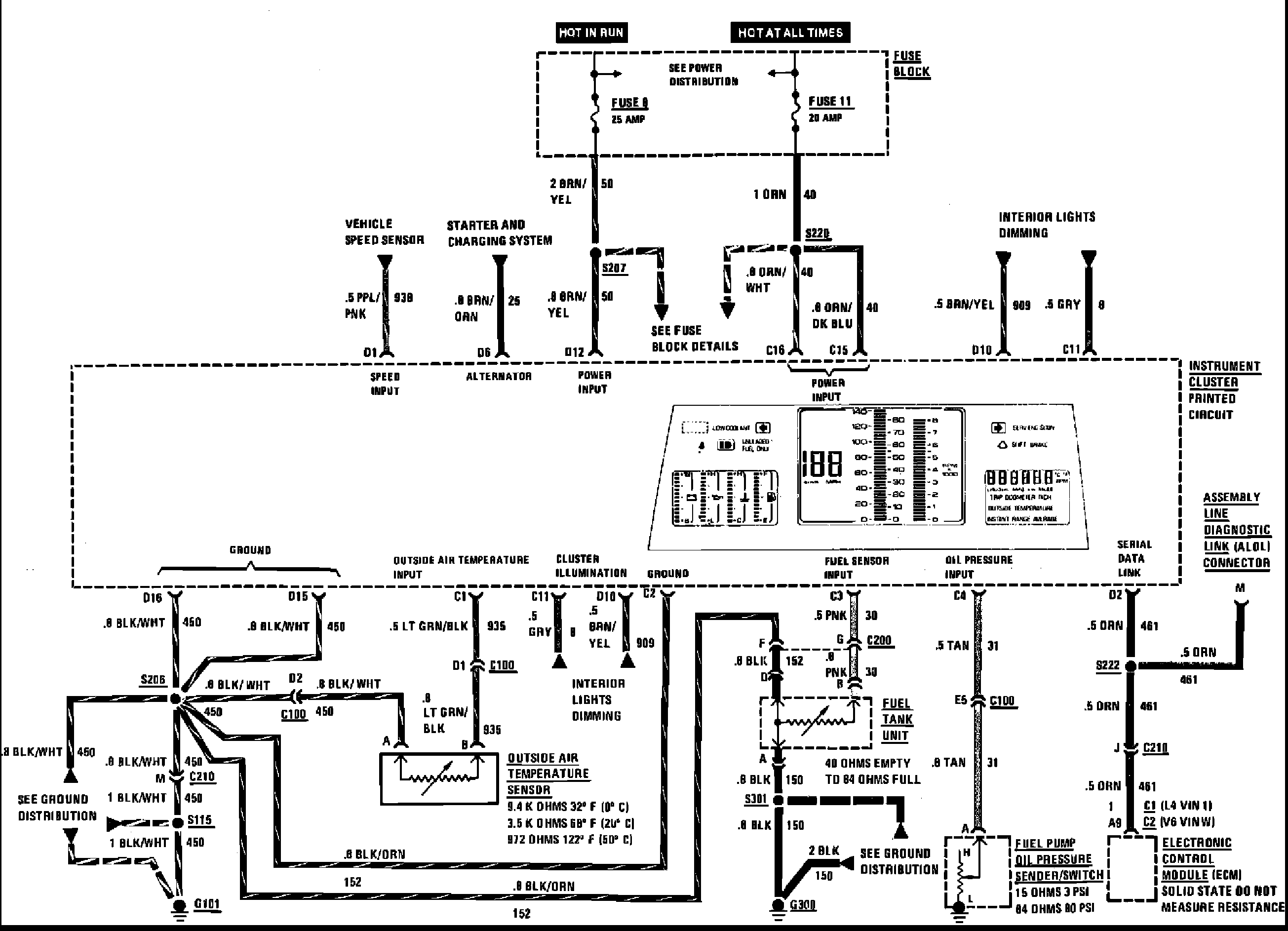

Posts: 1852
Re: Would a digital cluster work in a non digital car?

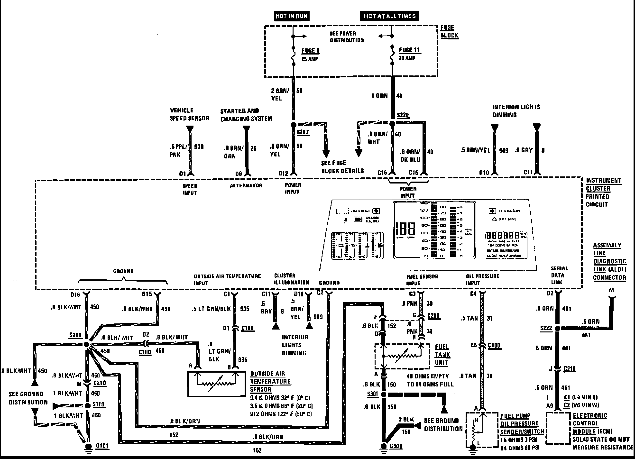

This may help... I have a pinout list too, if anyone needs it.
Downloaded these from this site years ago -the thread is around here somewhere...

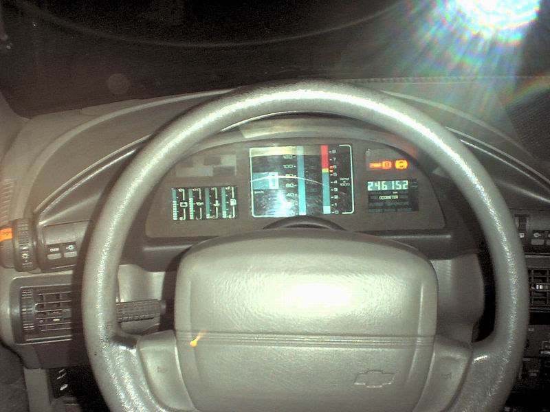

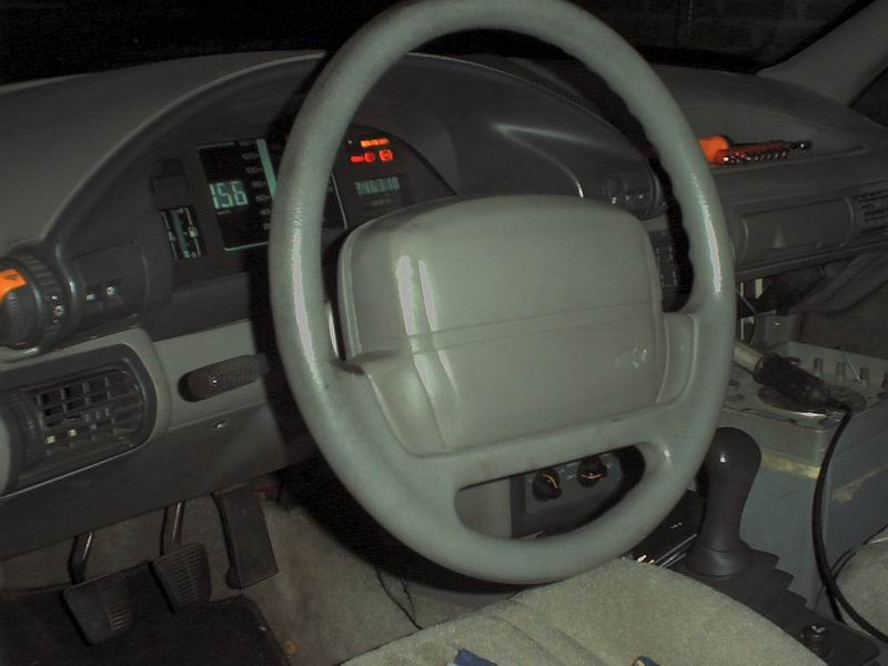

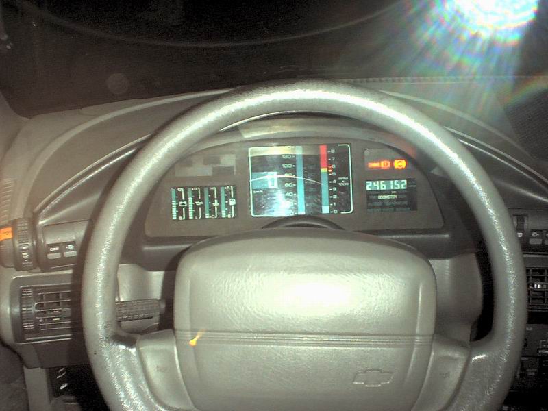

IIRC, this was swapped into a Beretta, probably because it was a clean dash, and clean is clean, Corsica or otherwise.

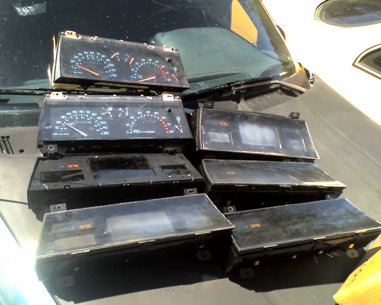

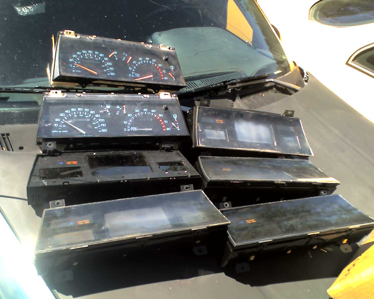

Some of mine... I have three Berettas that originally used the digi-dash, and two other cars I've considered swapping them into, so spares are a MUST.

Looks like it can fit in a Corsica dash. I'm wondering if the plastic dome is tall enough to house the digital dash on the 96 Beretta, looks like its raised a little to fit over the column?
This makes me want to do this on my own car.... lol. I'm curious how they modified the dash behind there.
Don't those digital clusters stop registering mileage at 250,000? That would be the only drawback imo.

Rettax3 wrote:This may help... I have a pinout list too, if anyone needs it.
wow. Thats pretty cool. I really wanna do it but I dont wanna mod the car. Could you get me the pinout list?
Posts: 1852
Ahh, here it is... Have fun. :D
Beretta digital pinout.docx
(70.13 KiB) Downloaded 1051 times

Rettax3 wrote:Ahh, here it is... Have fun. :D
Thanks! :good:
