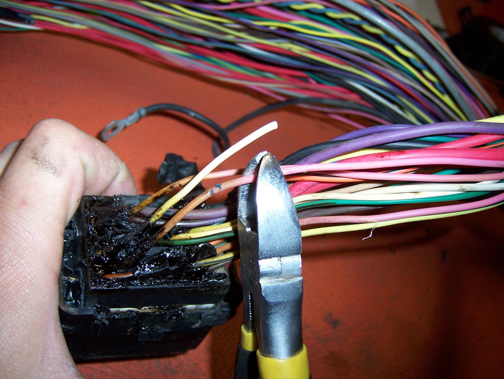

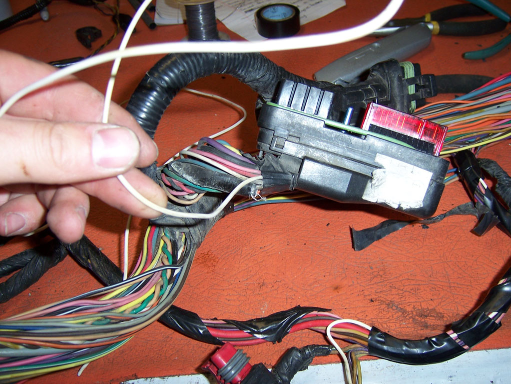

Find Pin 9 on the clear ECM connector, WHITE WIRE.
Cut it 2 inches back from the connector just to leave some extra if you ever want to hook up a 0-5v tach setup.

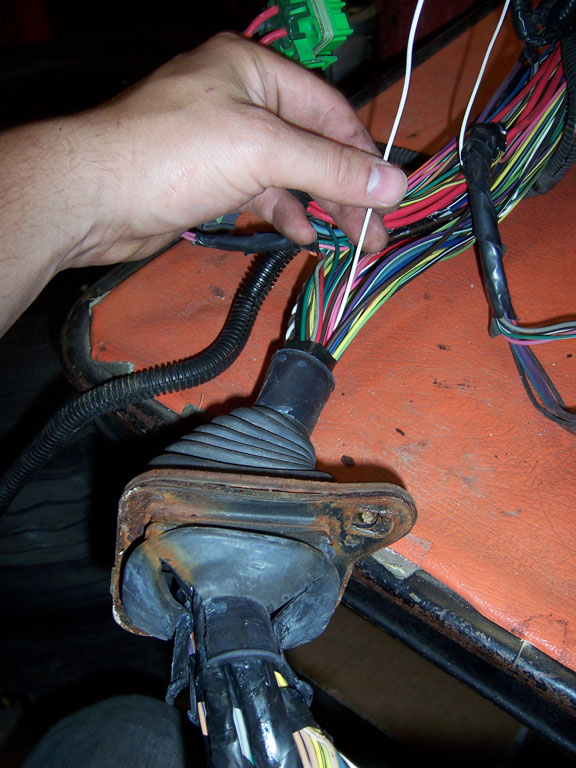

Pull the wire back through the passenger side firewall connector.

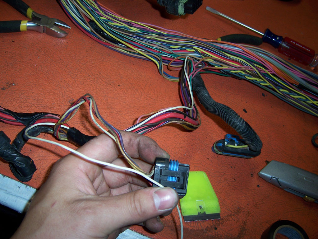

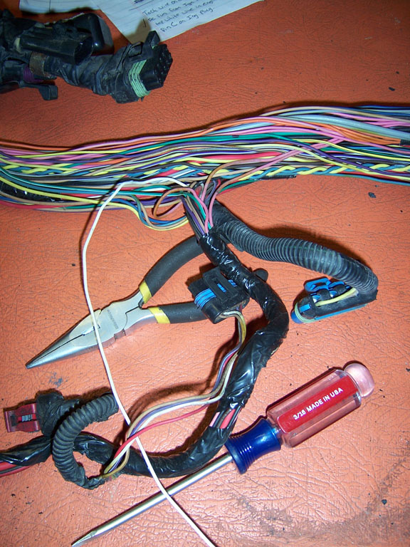

Pull it back to where the wires for the ICM come out of the main harness.

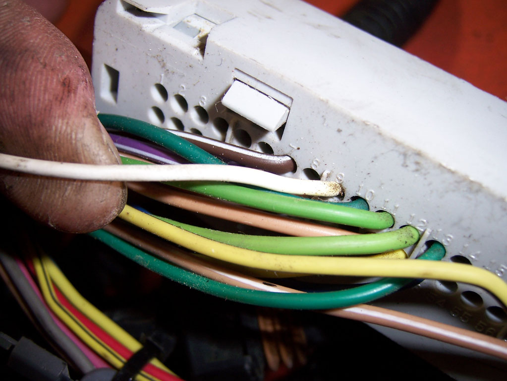

Route it up to the ICM connector to determine length of wire needed.

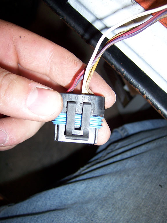

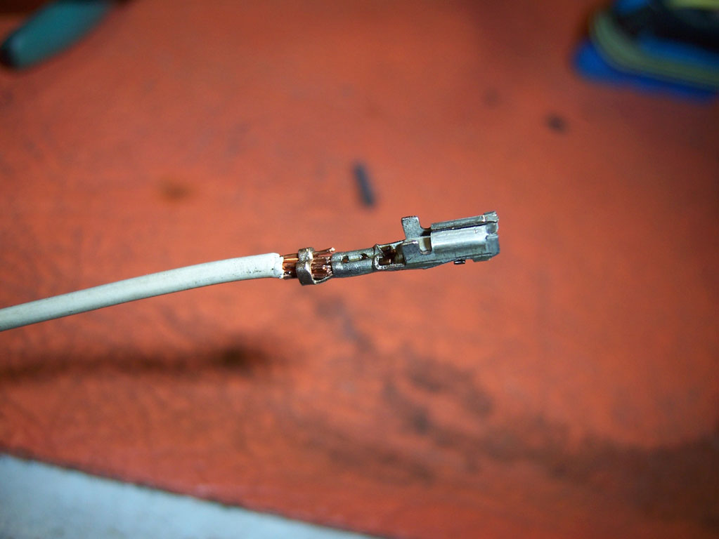

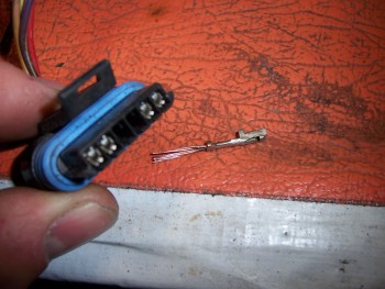

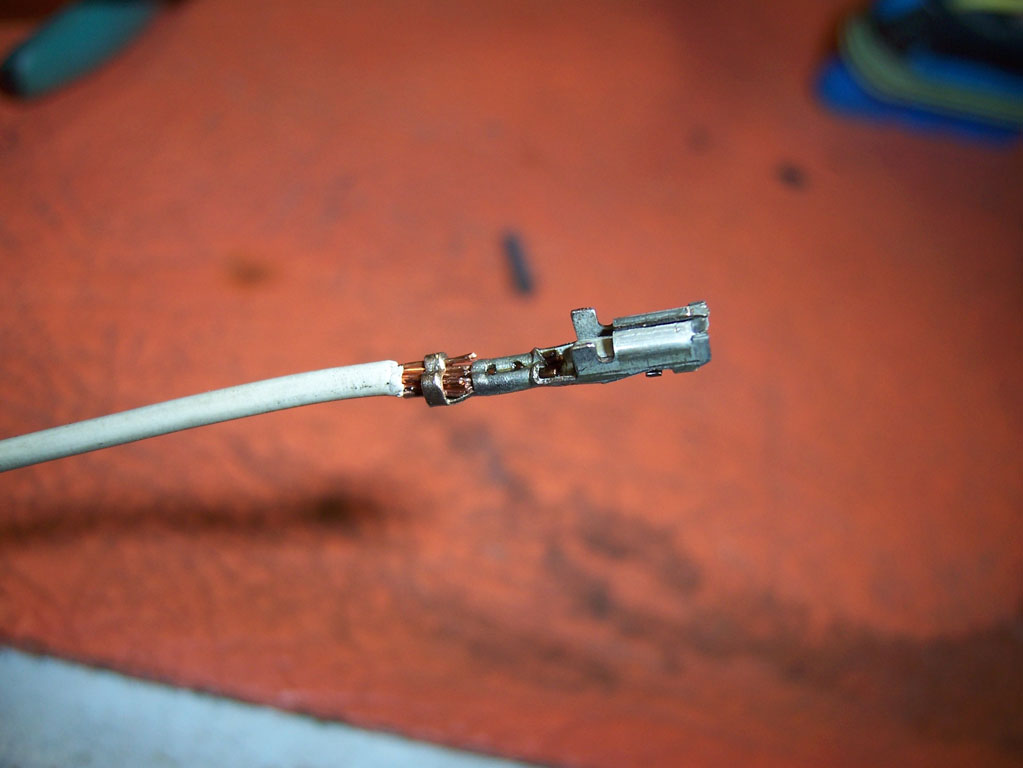

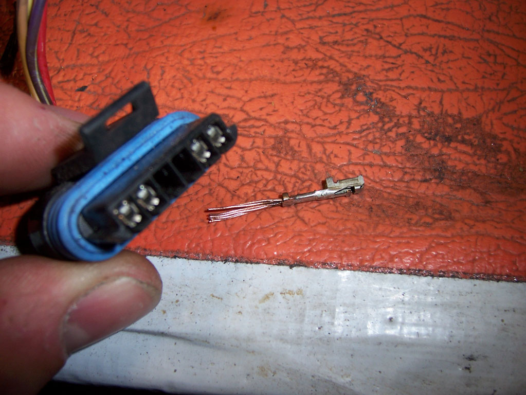

Pull a connector from a un-used connector you have lying around, remember it has to be the same type of pin, TPS, Crank position, IAC, and a few others are all the same, I cut up a old crank position connector to get the pin out of it.
I cleaned it up trimmed back the wires, threaded the white wire through the ICM connector first at PIN C, and then put the pin on the wire and soldered it together.
I then pulled the wire back into place clipping the pin into the connector.

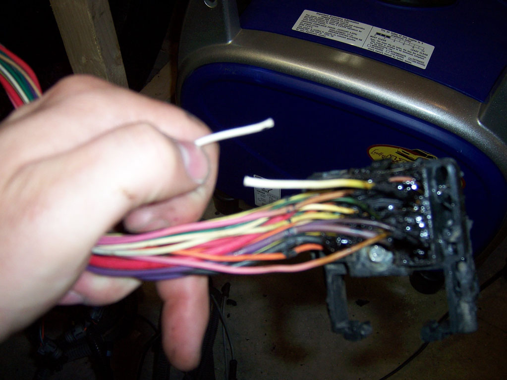

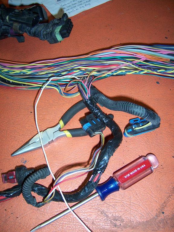

Cut the white wire on the driver's side body harness connector, PIN G5 AKA top row second from left, Looking at the back side of connector, as pictured, (natural wire curve aiming down)
Pull this wire back through the harness to the ABS ECM plug.
Stage this wire there for now.

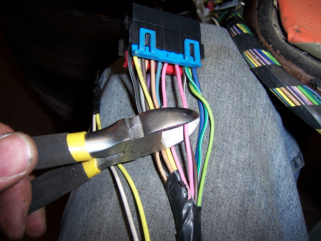

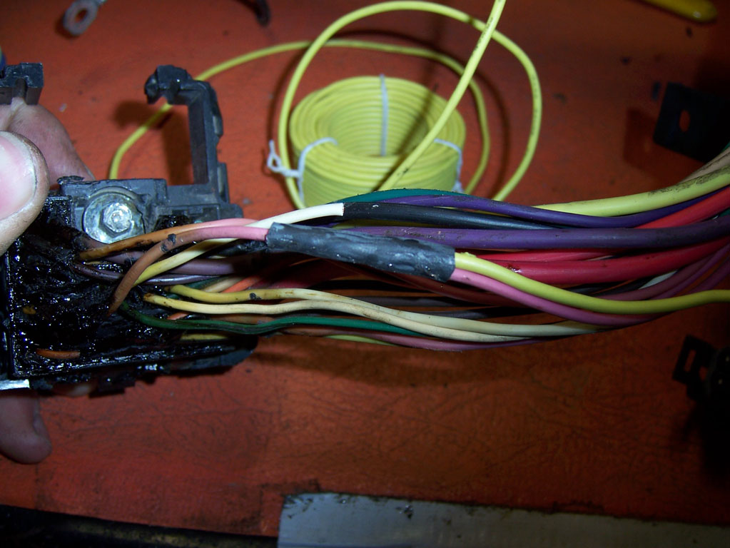

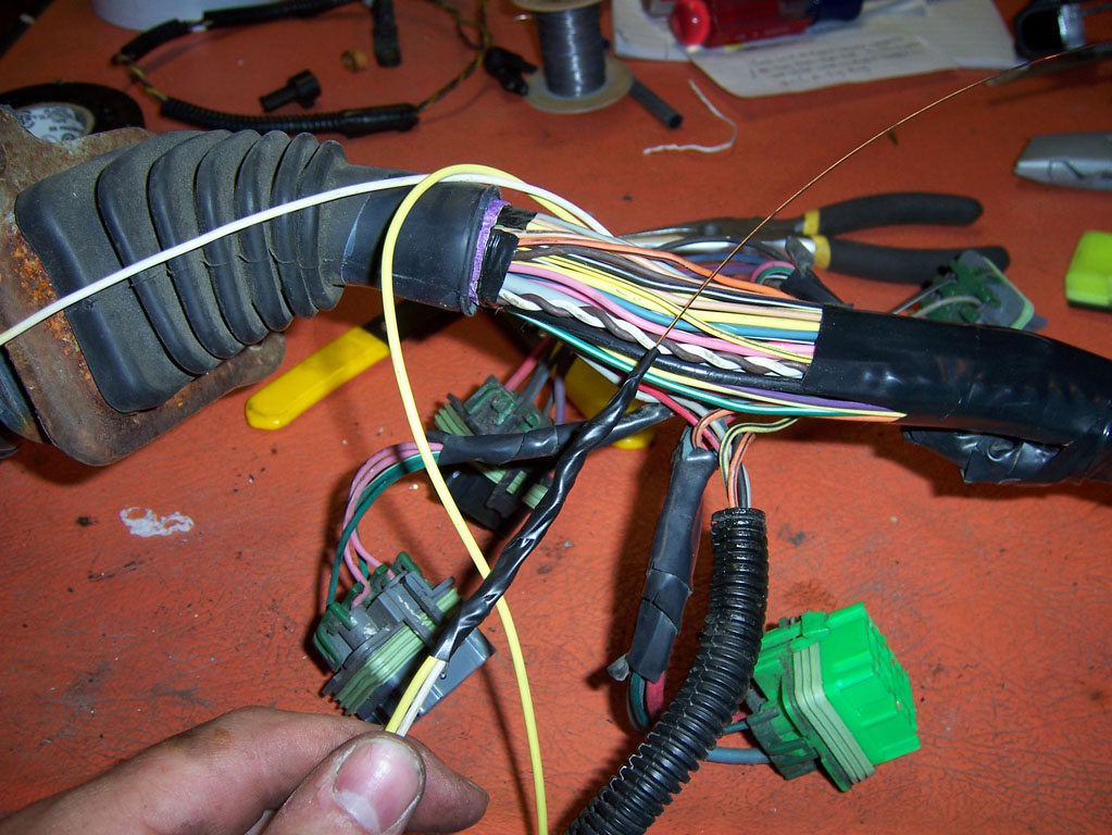

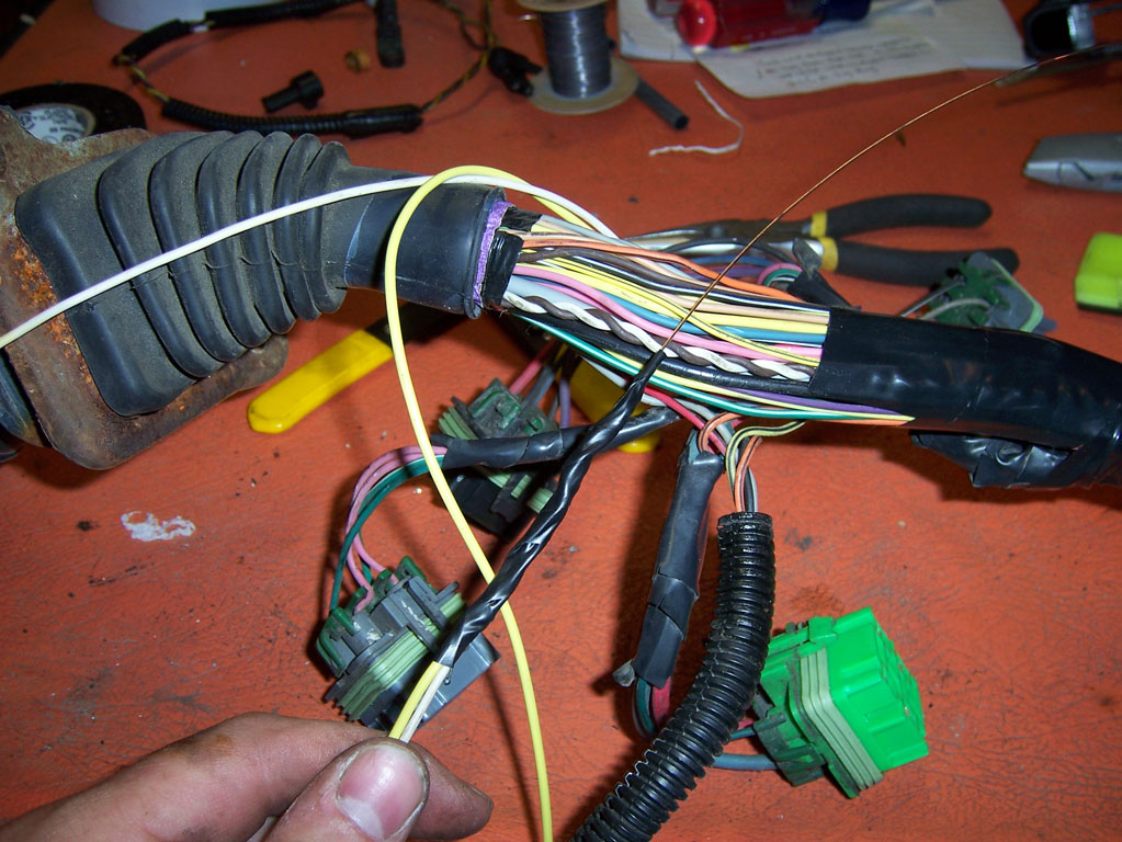

Cut the pink wire PIN F4 on the driver's side body harness to allow you to tap in a new wire to run to the other side.
Solder the new wire to the existing wire and then connect all three ends back together, cover with heat shrink and wrap in electrical tape.

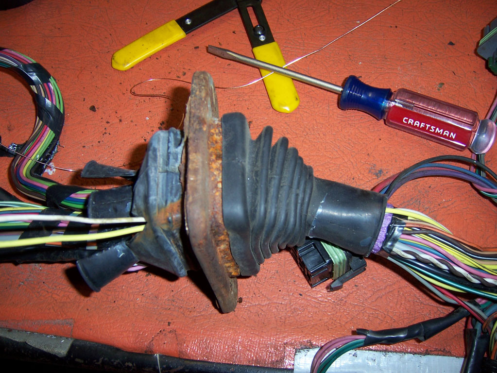

Now run this new wire through the main harness taping the harness back up as you go, once you get to where the ABS plug is, start to pull both the new wire and the white on you cut from the previous step, route these two wires over to the passenger side compartment entrance. Connect them to some tool you can use to thread the wires through the grommet, I used welding wire, a coat hanger is fine as well.
Pull the two wires through the passenger side grommet.

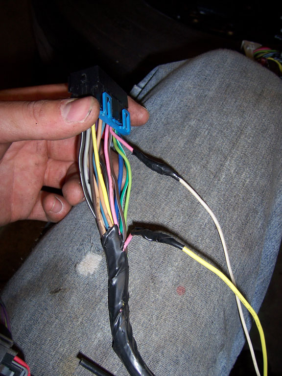

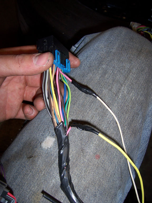

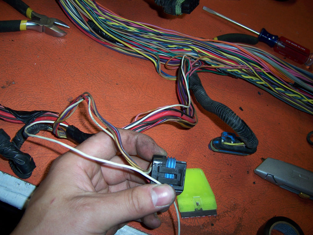

Route them over to the rectangle body harness connector with the blue and red clips on it.
Now cut the wire at PIN P giving you enough wire to work with on either side.
Now solder the corresponding wires to the ends pictured here. White wire is the ABS plug wire, this goes to the connector side, and the yellow wire is the new one that I ran from the driver's side, this one goes to the harness side, going back out to the engine bay.
