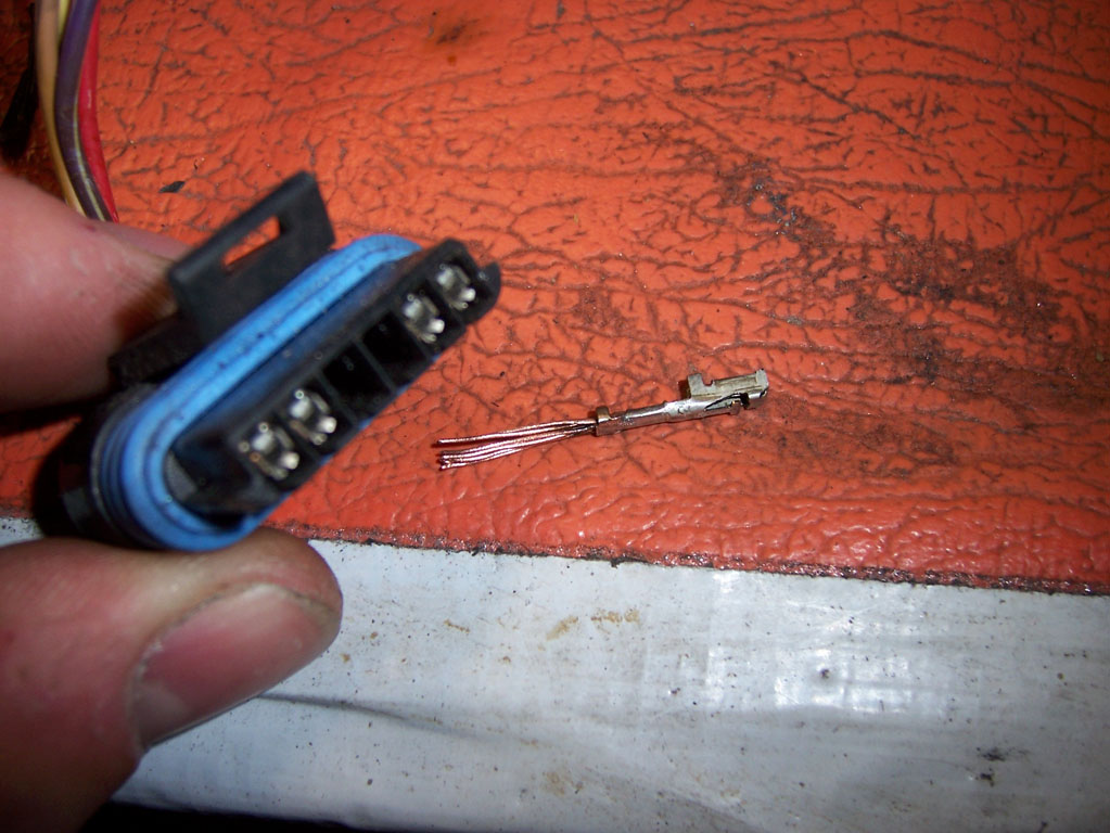

Pull a connector from a un-used connector you have lying around, remember it has to be the same type of pin, TPS, Crank position, IAC, and a few others are all the same, I cut up a old crank position connector to get the pin out of it.
I cleaned it up trimmed back the wires, threaded the white wire through the ICM connector first at PIN C, and then put the pin on the wire and soldered it together.
I then pulled the wire back into place clipping the pin into the connector.

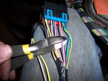

Cut the pink wire PIN F4 on the driver's side body harness to allow you to tap in a new wire to run to the other side.
Solder the new wire to the existing wire and then connect all three ends back together, cover with heat shrink and wrap in electrical tape.

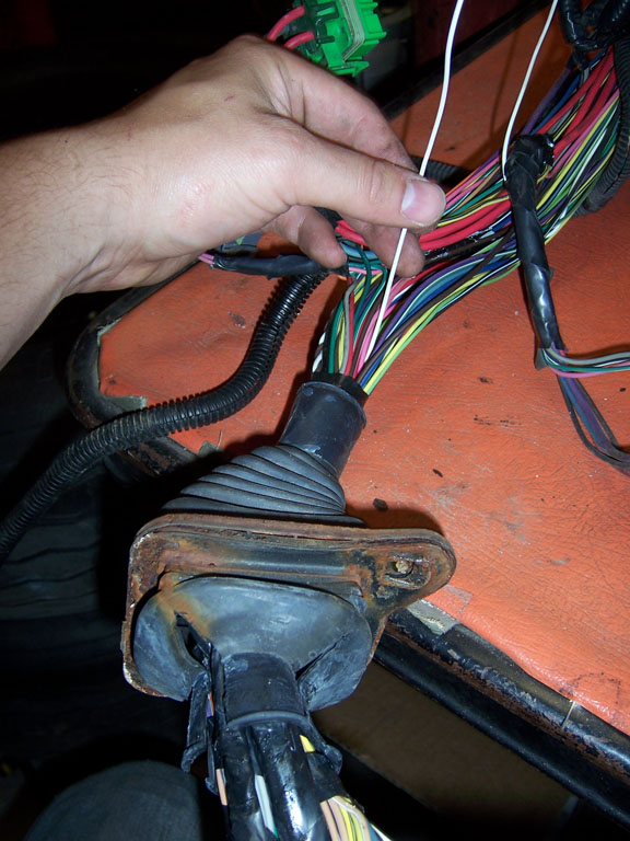

Now run this new wire through the main harness taping the harness back up as you go, once you get to where the ABS plug is, start to pull both the new wire and the white on you cut from the previous step, route these two wires over to the passenger side compartment entrance. Connect them to some tool you can use to thread the wires through the grommet, I used welding wire, a coat hanger is fine as well.
Pull the two wires through the passenger side grommet.
