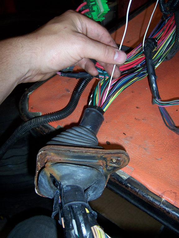

Pull the wire back through the passenger side firewall connector.

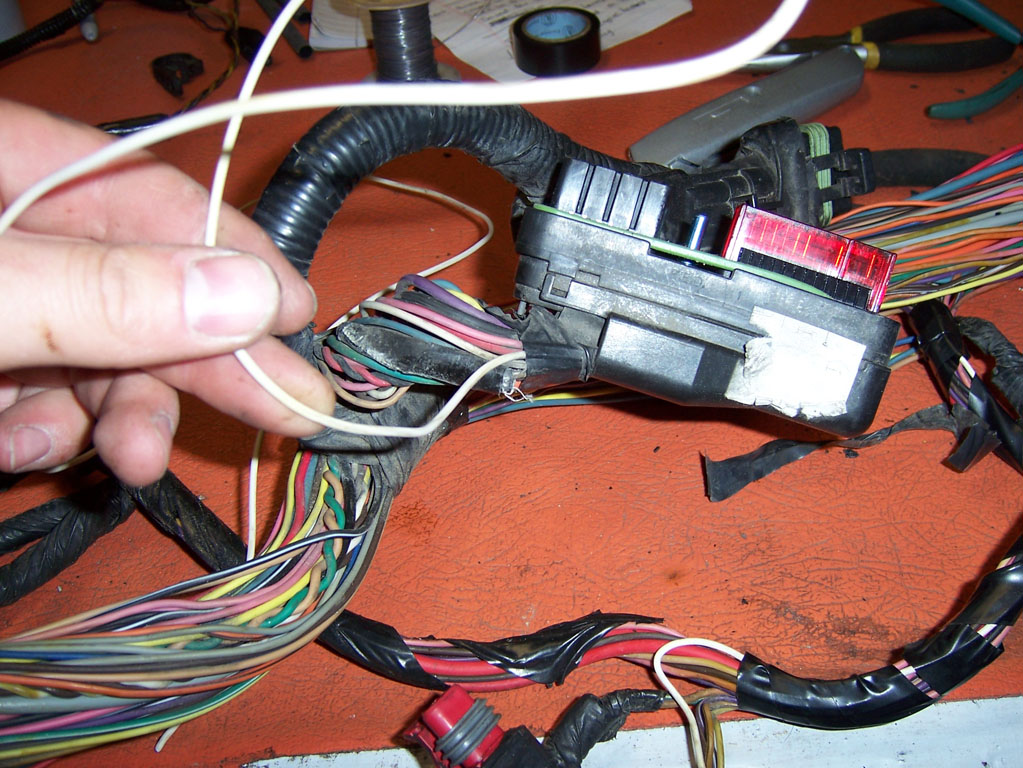

Pull it back to where the wires for the ICM come out of the main harness.
Route it up to the ICM connector to determine length of wire needed.

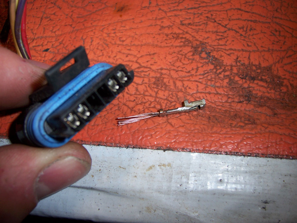

Pull a connector from a un-used connector you have lying around, remember it has to be the same type of pin, TPS, Crank position, IAC, and a few others are all the same, I cut up a old crank position connector to get the pin out of it.

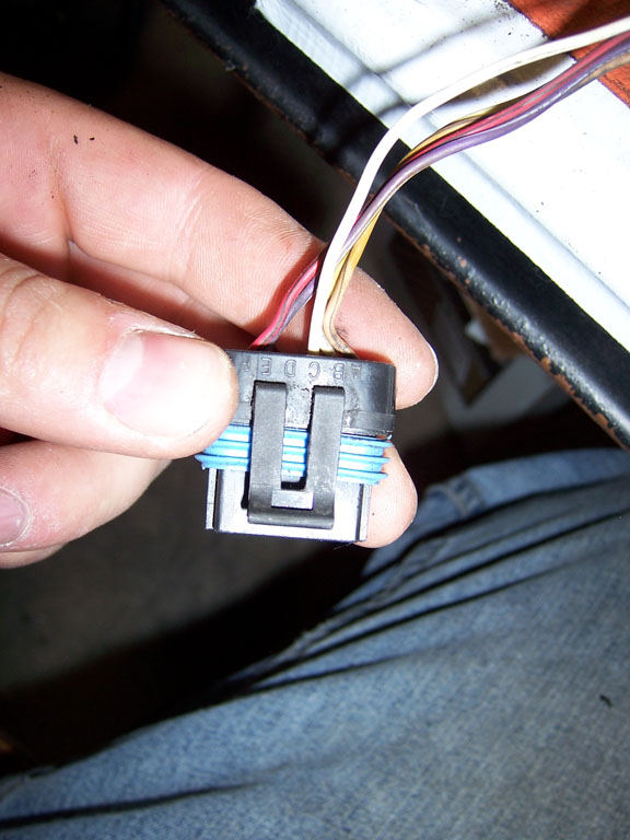

I cleaned it up trimmed back the wires, threaded the white wire through the ICM connector first at PIN C, and then put the pin on the wire and soldered it together.
I then pulled the wire back into place clipping the pin into the connector.

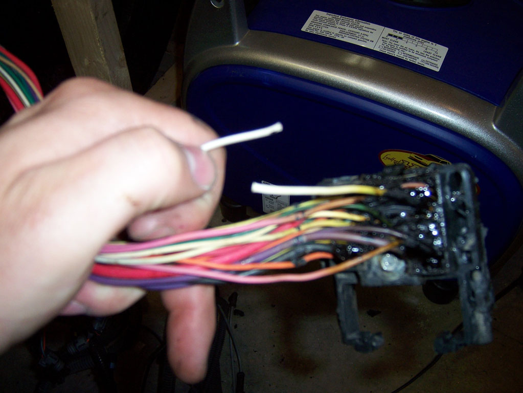

Cut the white wire on the driver's side body harness connector, PIN G5 AKA top row second from left, Looking at the back side of connector, as pictured, (natural wire curve aiming down)
Pull this wire back through the harness to the ABS ECM plug.
Stage this wire there for now.

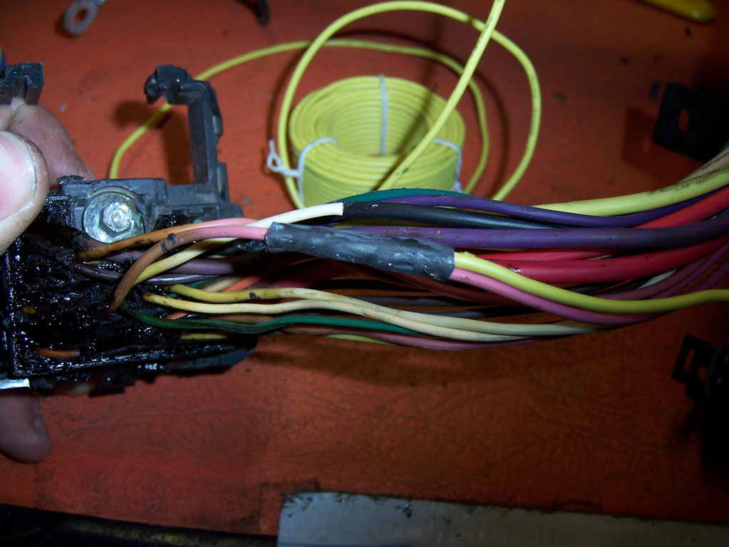

Cut the pink wire PIN F4 on the driver's side body harness to allow you to tap in a new wire to run to the other side.
Solder the new wire to the existing wire and then connect all three ends back together, cover with heat shrink and wrap in electrical tape.

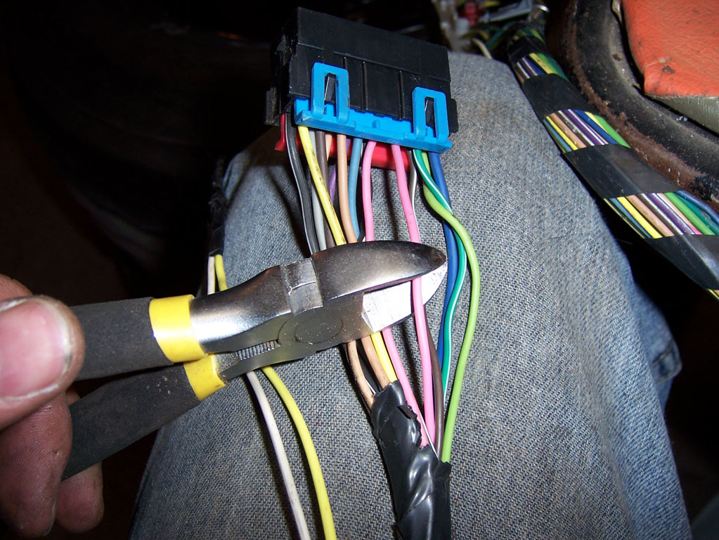

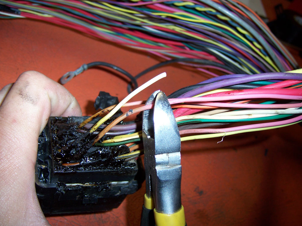

Now cut the wire at PIN P giving you enough wire to work with on either side.
Now solder the corresponding wires to the ends pictured here. White wire is the ABS plug wire, this goes to the connector side, and the yellow wire is the new one that I ran from the driver's side, this one goes to the harness side, going back out to the engine bay.
